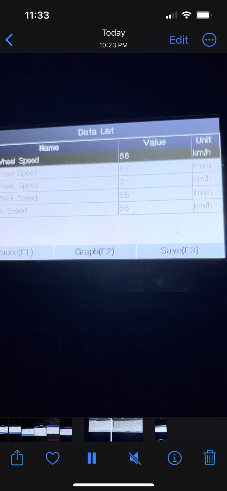

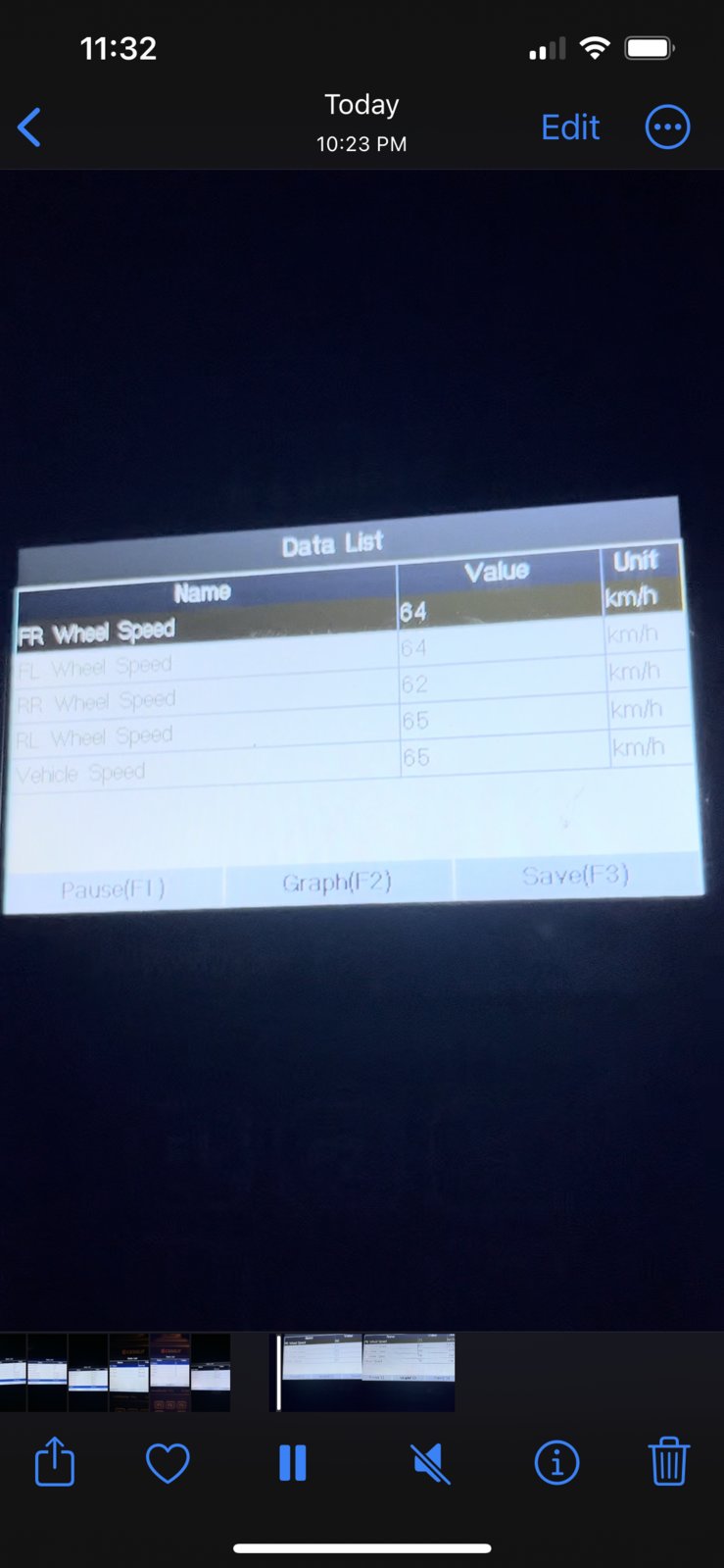

    I tried to upload a video but I guess it was too big. About 59 seconds worth. Yes it is capable of reading wheel speeds. I did have a RR that kept dropping out completely. The other 3 was dead on or 1 MPH off but the RR kept dropping completely out. Yes it was the right side that hit the pot hole. I was already on my brakes and when it hit it came out of the hole like I was on a snowy road or something. SMH. I replaced all 4 wheel speed sensors but now the RR is dropping out. An now for some dumb azz reason my computer won’t even clear those codes. Don’t have a clue on why but it cleared the engine codes where I had the ABS unhooked to take it a small drive to see if I had good brakes or not.

    I never hit the brakes really to see if it was dropping out. Just driving and it would bottom out to nothing then be right back up to speed with the rest of them. For example. 70 all 4 of them then like 10 or 0 while the others would read 70.

    That would seem like a broken wire more than a failed sensor.

    Either the harness between the sensor and ABS module, the sensor wire itself, or a bad connection in the sensor connector.
