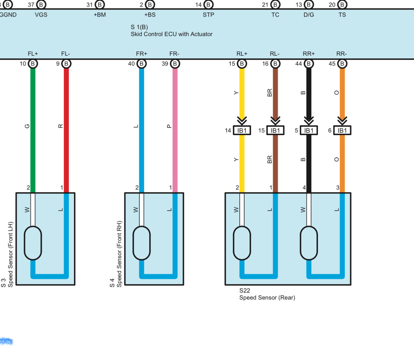

    There a connection between the 2.
    We can isolate the issue to one side.
    But check the pins in the sensor first.

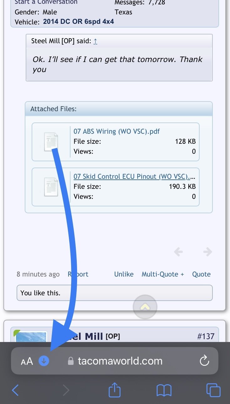

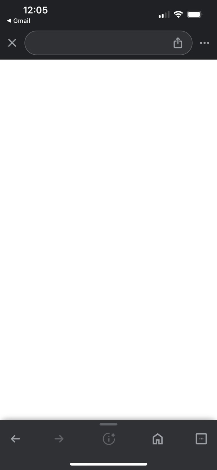

    What device are you using?
    They are PDF format, most smartphones will open them natively.

    A dang IPhone 13

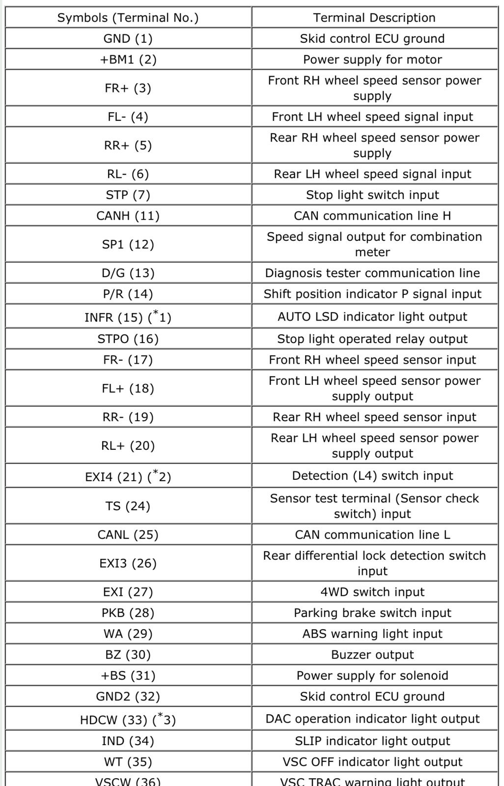

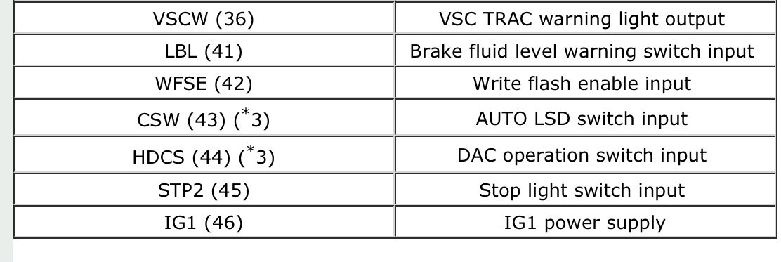

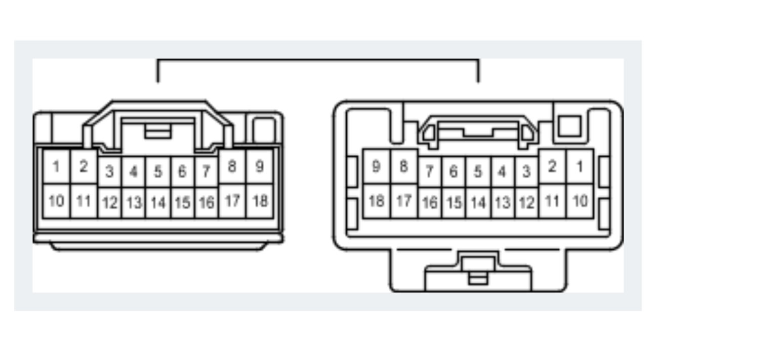

    Now the 2 plugs ins at the bottom. Which 2 would that be ?

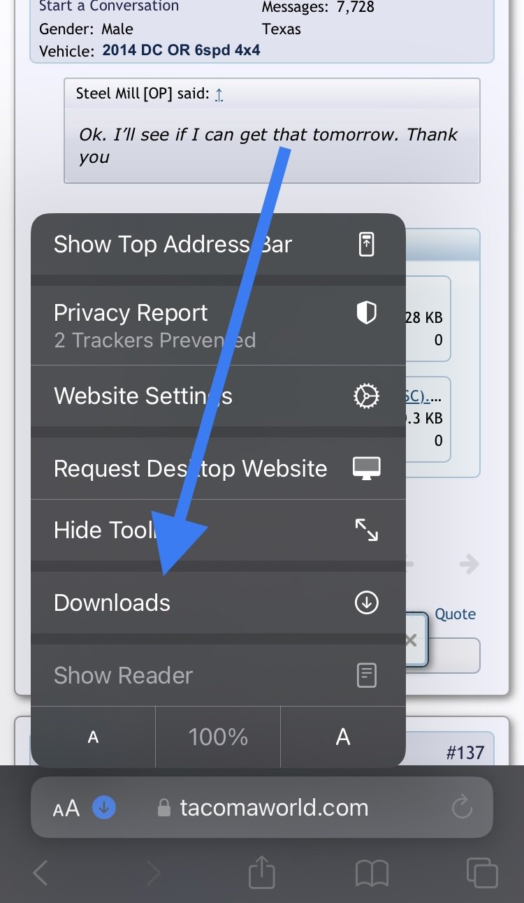

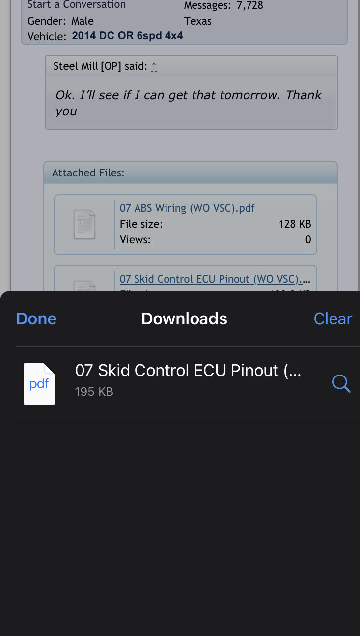

    iPhone is difficult.
    Click the file, then the blue circle with arrow. Then click downloads. Then the file.

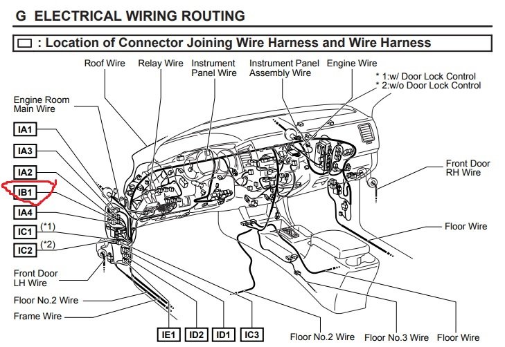

    That would be Connector IB1 behind the left kick panel.

    Yeah, wire integrity and a wiggle test is all I got at this point.
    I’m totally ignoring the relay circuit code at this point……:cool:
    Like me and OP discussed earlier, I’m hoping it “goes away” if we fix this problem.

    Well if nothing else solving the speed sensor problem "should" solve the false ABS activation problem but we still have to figure out the hydraulic problem.
