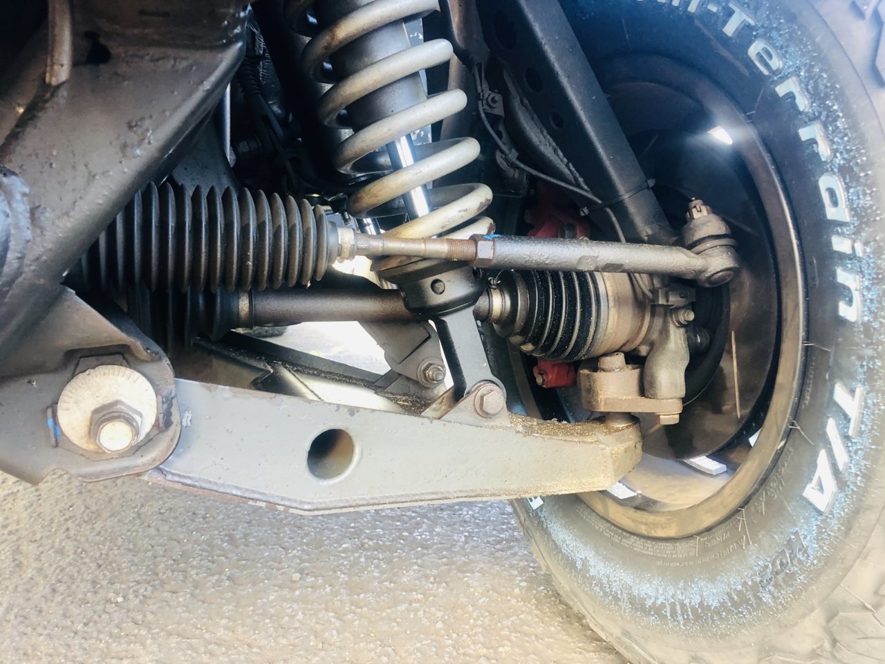

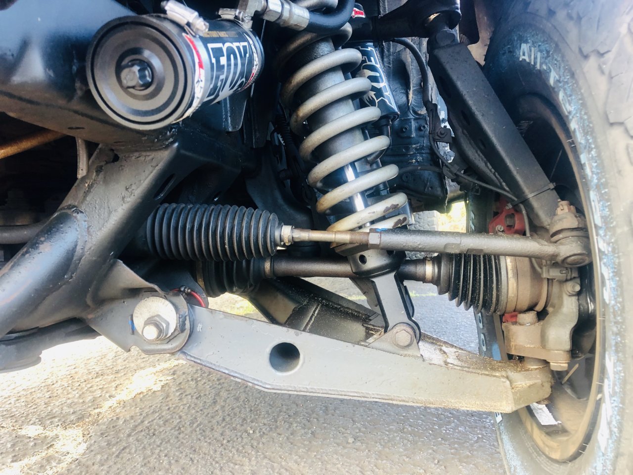

    Here’s some quick pics of my front set up: 3.5 inches wider per side, Total Chaus uppers, Coils n Bypasses, and the Tundra “Tie Rods” for the extension needs
    Love to figure out a Beefier steering setup/bump steer minimizer ...

    Honestly those angles are good, the tundra rack upgrade is the next best thing.
    https://solomotorsports.com/shop/pa...ta-parts/toyota-tacoma-steering-rack-upgrade/
    Not too many choices it seems.

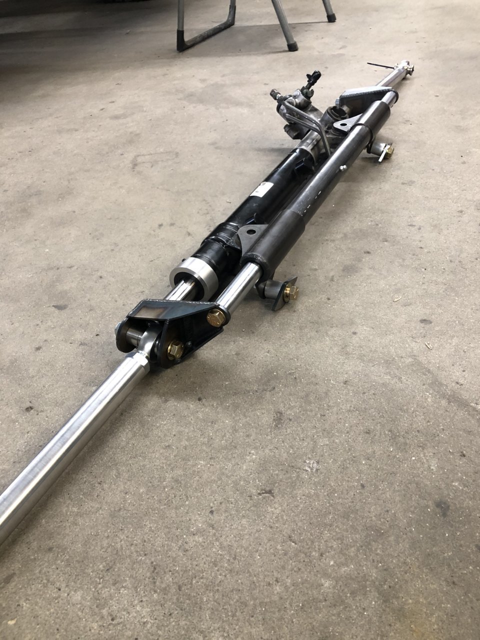

    @81Trekker might have exactly what you need with his slide rack stabilizer thing. It’s freaking sick.

    This might be what you’re looking for :)
    6 gearT444E and eljedi68 like this.

    81Trekker: how’s that sexy and beastly work of art work? Some what direct bolt on,, or cut, weld and fab?
    way cool , keep me posted
