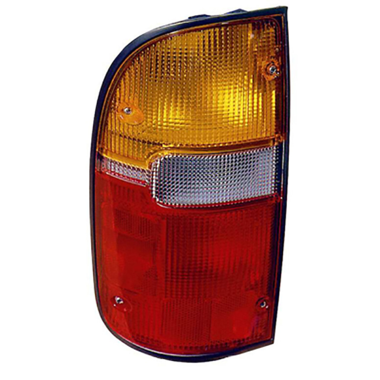

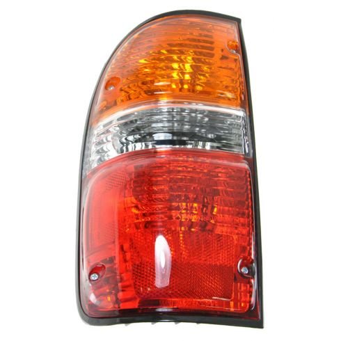

    So, the bevel means that they have a buldge to them. And pop out is the same, if you look at the headlights on 1995-2000’s, you’ll notice that they are flush with the back of the truck, and that they are flat. With the 2001-2004 taillights, you’ll notice that they have a headlight cover on them that has buldges on it, and that is not flush with the back of the truck.
    Here’s some pictures so you understand more
    See what I mean?

    There is more of a difference than the shape. The wiring for the taillights changed in 01, removing a ground from the passenger taillight (or was it the driver?). This means that on 01-04 trucks, the ground on the passenger light is directly connected to the driver side light. This has been know to cause issues when the ground connections on the bulb sockets start to fail. I have 01 lights on my 99 and they are plug and play, but I did notice that the wiring is different. I also read that a lot of aftermarket light manufacturers never changed their wiring schemes when the 01 models came out.

    Yes, wiring is not an issue, from the picture I see the connector is the same so all it is a matter of swapping wires in the connector (I did that already for my lamp for swapping reverse with blinker on one side and replacing reverse with fog light on the other). Grounding change is in the truck's loom, not the lamp itself.

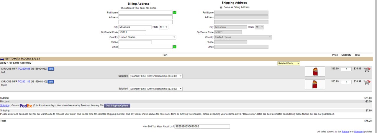

    $76.28 shipped to Missoula. Looks like a pair of tail lights is going to cost you about $75 to $80 no matter where you get them
