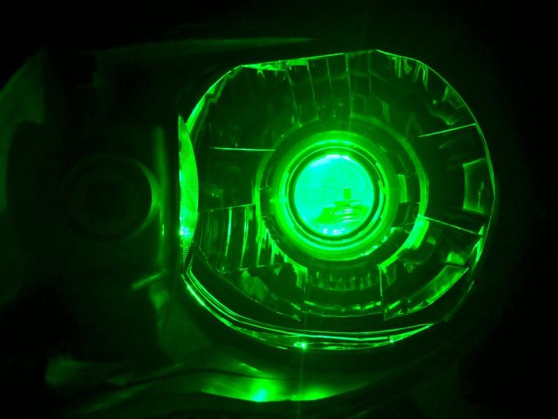

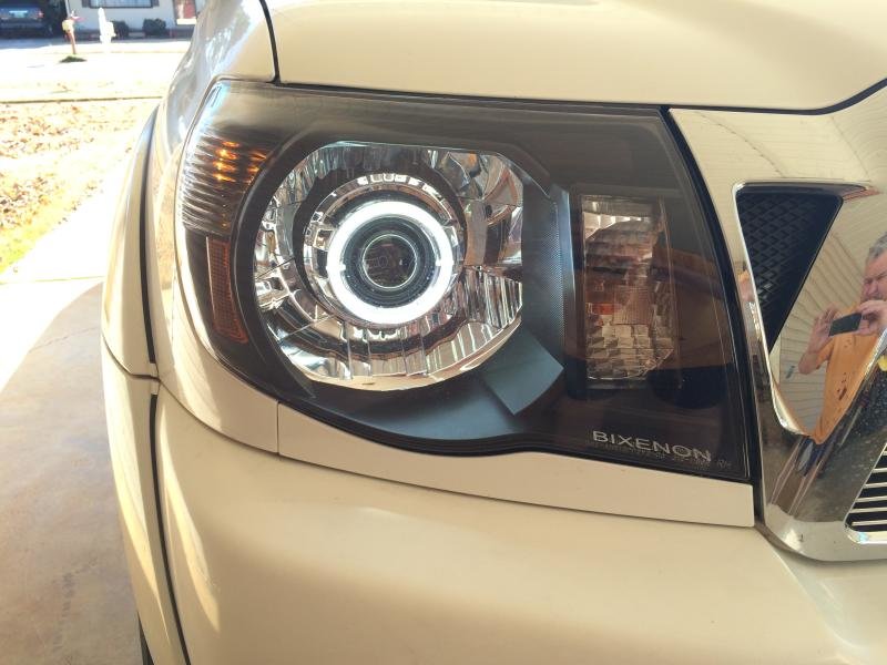

    Build some yourself, I just finished up a new set myself. It's not that difficult and Theretrofitsoure.com has a killer deal going on through Monday. The output on real projectors is well worth it IMO. Here's a couple crappy cell pics. I added halos and "goblin eyes" (the eyes are not wired yet, waiting on a switch). But here is a test shot before assembly.

    That is sick, I don't have skills to build my own

    Dude, it's not hard at all. There are plenty of tutorials on this site to walk you through.

    Are you good with electrical? What set up are you running on your lights and if you don't mind me asking, how much did it cost you?

    Ha, I did almost the same thing. I had forgotten about this thread, and just happened across it again. You ask in a above post about electrical, I'm no expert by any means, but most of all this is plug and play. The harness I used plugs in to your headlight lead, then into the input side of your ballast, then from output side of ballast into your bulbs. Then there is a tiny connector that plugs into your projector to activate your high beam cut offs. Depo lights can be bought from Amazon for just over $50.00 or so. Make sure they are the same model left vs right, because there are some different model Depo offers. Id help you any way I could if you decide to tackle it. Doing them yourself will make you the proudest of them IMO.
