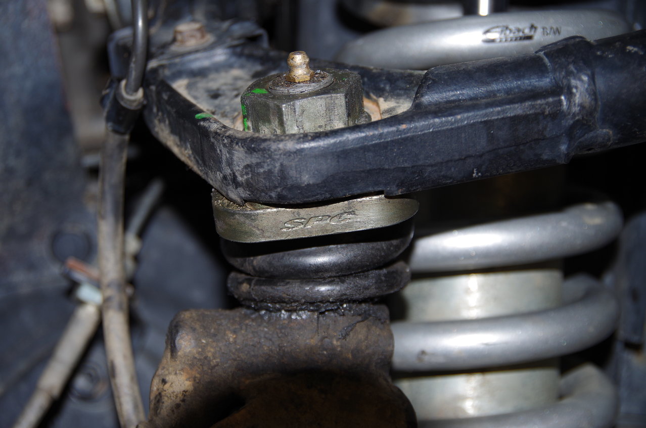

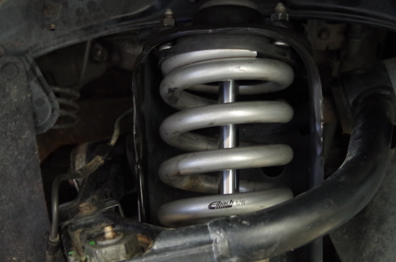

    The front:
    I'm currently running Bilstein 6112 shocks inside 700# Eibach Coils. Bottom end bolted to OEM LCA. Top bolted to upper shock mount/tophat. Shock/coils running through SPC LR UCA's (with balljoints.)
    The 6112 shocks have a much wider/fatter body than the 5100, which theoretically allows more oil and better heat dissipation.
    My initial plan was to go with OME886X/Bilstein 5100 front combo to manage my massive front end weight. I've read in various places that the 5100's may not be correctly matched/valved/dampened for the 886x's 660# spring rate. The 885 and 884's are 590#. I think the OEM coils are around 500#-ish.
    I loved the 5100's and they matched well with the 884x's that I had. I've read that they also match well with 885x's, but not as well with the 886x's
    But the 5100's weren't valved properly for 700# coils, which I needed because my front-end load includes a full hoop plate bumper, a 12k lb winch, 1/4" fully reinforced IFS skid and a second aux battery.
    Well, the spring rate of the coils included with the 6112's are 610#, which is still lower than the 700# that I wanted/needed. But my TW research found that there were many peeps that used 700# coils with the 6112's with no dampening issue and that there were TW vendors that will actually pre-install a 700# coil onto the 6112 shock on request. It is my theory (and mine only) that the larger capacity 6112 could manage the heavier coil with no issue. So I took a gamble and went with the 700# Eibach coils. And the gamble paid off. The Coil/Shock combo works perfectly for my needs.
    My suggestion to @Redmann was to bite the bullet and get 6112's instead of 5100's, and install the 6112's with the included 610# Coils (which are slightly beefier than the 884's or 885's) And as he starts to add more weight with all the stuff that he wants to add later, he can go ahead and just change over to higher weight coil spring.
    Also, please note that OME 884/885/886 series coils will physically work with 5100's but will NOT work with 6112's. Which is why I ordered and installed the Eibachs.

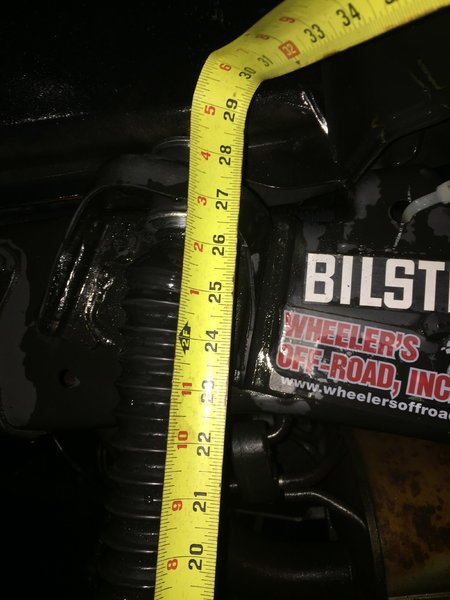

    The rear:
    Is here
    I basically needed a shock that will take advantage of the Dakars plus 29XL AAL.
    The Bilstein B110's have an extended length of 27.28".
    This is where I am at at full droop: 27" at the top mount. So full droop advantage taken... with a quarter inch to spare.
    Don't forget to get extended brake lines when you install these Dakars and shocks.

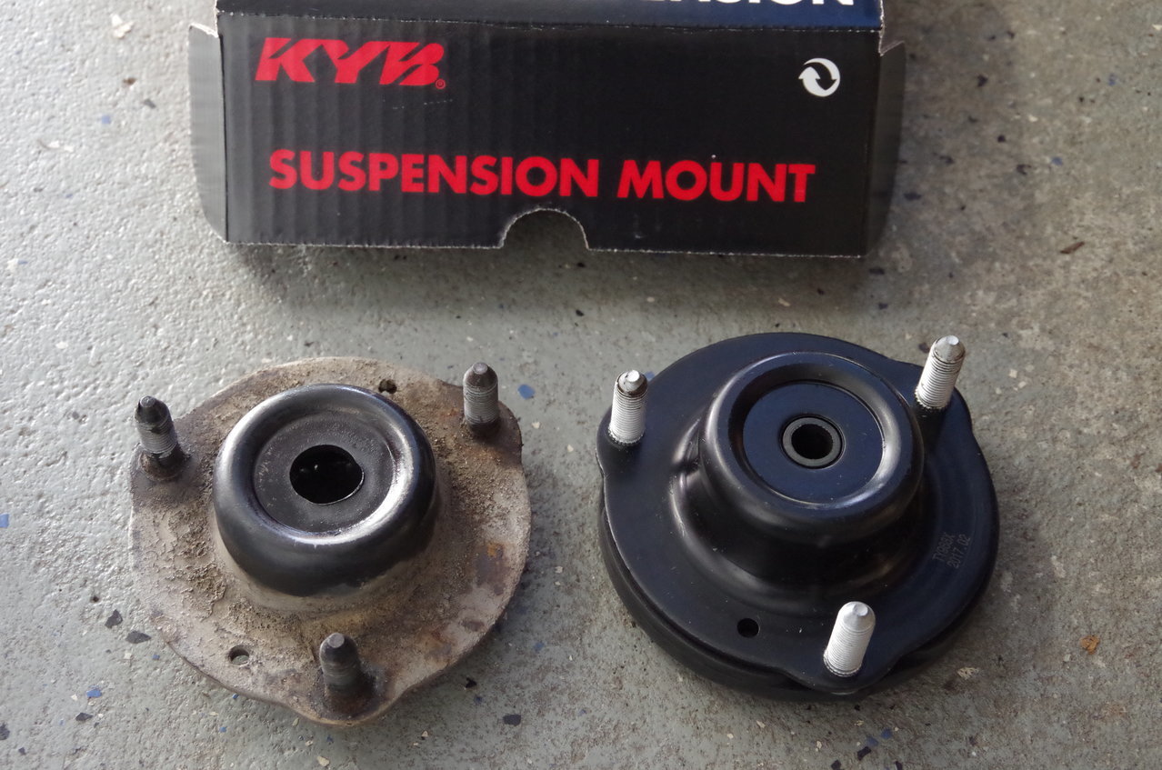

    Also a good idea to change your Top-hats while you're working on your fronts. These are 13 years old and the holes were enlarged enough that I could feel some movement and clunking while I was driving and actually observe the shock rod off-center.
    Old-Left (the inner rubber bushing was completely worn off and hole enlarged)
    New -Right
