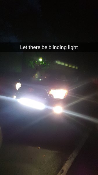

    Received my light today. Waited until almost dark then took everything outside and hooked it up to test that it was working. That light is some bright. I held it in my hands and moved up, down and around. Had a jet almost land on the road in front of my house thinking I was signaling it in for a landing. I avoided pointing it at my neighbors house since I like them.
    Thanks Chris. Looking forward to getting it installed.

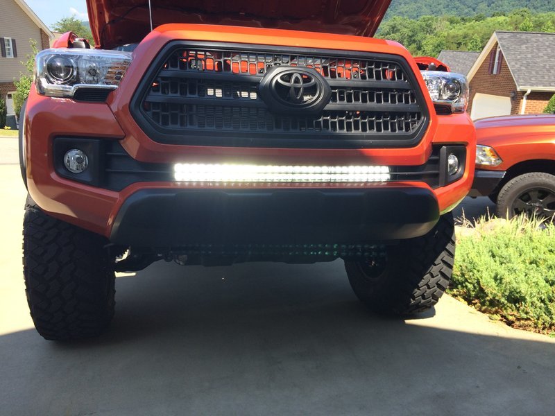

    And that's a wrap... Got it in and truck put back together. PITA trying to get them little screws started. image.jpg

    Looks awesome!!!! Yes getting the bolts started is the hardest part of the whole install. Good way to start my morning seeing another badass truck with my parts on it. Thank you for sharing!!!!

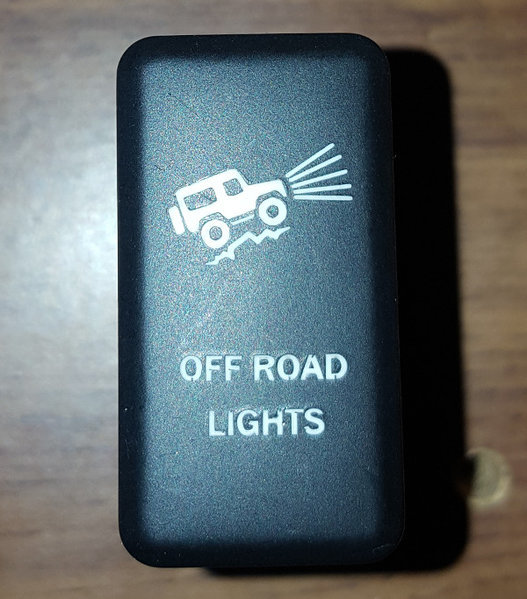

    This is the switch I bought
