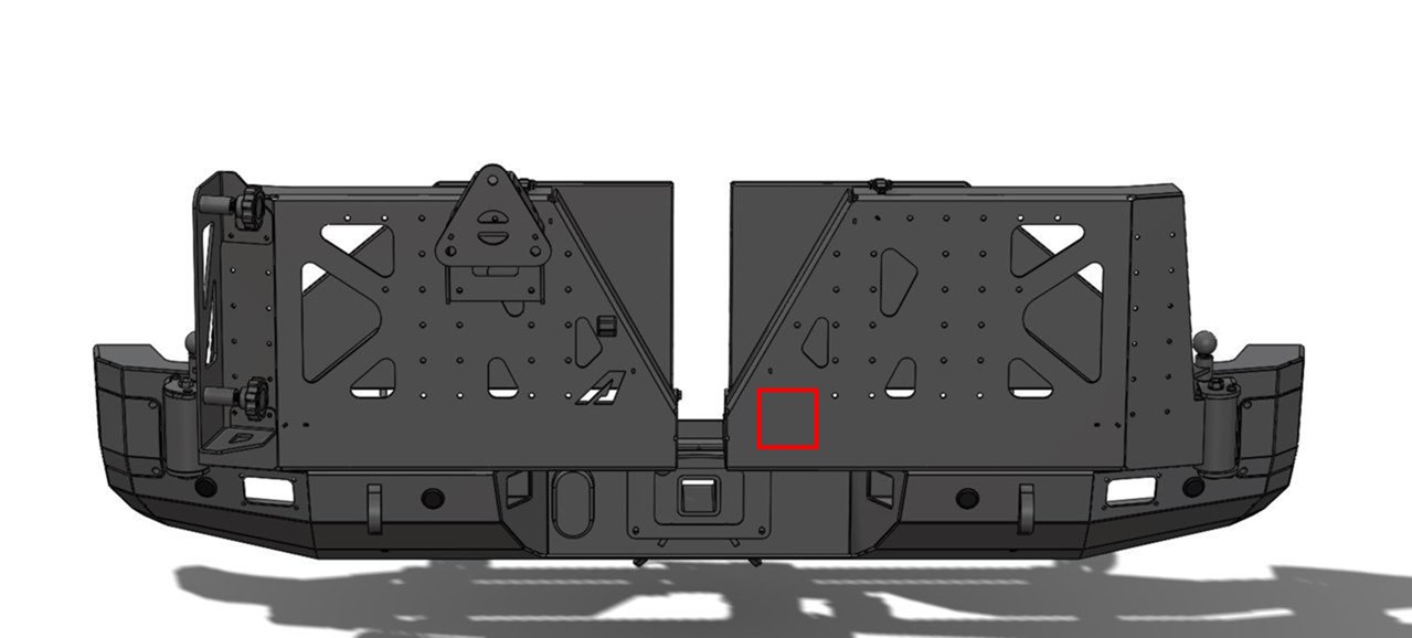

    I'm not sure that location would be too good for a hitch receiver mount for a bike rack. That location is on the opposite side of the hinge, and may put a lot of stress on it after adding the bike rack and whatnot.

    Hey Steve, when you come down for some testing, bring that bike rack with you and lets see if we can make something work. A hitch mount there would put a lot of vertical load on the swing, not to mention it cant be bolted from the back (that section in the back is boxed in) My best suggestion would be to run a hitch extension to clear the swing outs.

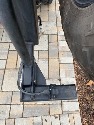

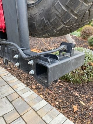

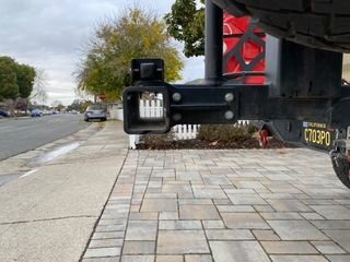

    Yeah I definitely will! I'm sure we can figure something out. I'd like to have the bike rack on the swing out so I can have it all out of the way while at camp. I'm using the Wilco swing out right now which is nice, but definitely not as nice as your bumpers and bike integration is pretty critical for my setup.
    I definitely hear the concern about the vertical load on the swing out too, but I'm also pretty confident it can be done. Here's how another member did it on his Brute Force dual swing out.
    130520103_222065542879144_1785928535337476505_n.jpg 130921509_691782921540810_1838390294746792355_n.jpg 130805827_1722248801268085_7272155291304777480_n.jpg

    I would love this option. A rack and 2 bikes is definitely not going to be as heavy as my 275/70R17 with TRD rim on it and it could be on the opposite swing out.

    You guys can mount anything your heart desires given its within our weight limit. I don't think we'll be offering a dedicated bike rack mount. Average mountain bikes weigh around 27-30 lbs. So give or take 60lbs, plus a 15lbs rack, PLUS the added leverage of hanging it off of the back of tire carrier sounds like a bad idea. Once again, it technically doesn't violate the weight limit, but with the added leverage, its definitely not recommended. Hanging off the bumper hitch receiver is definitely a better load point in terms of leverage.

    Yeah I definitely wouldn't expect you guys to make a dedicated bike rack mount, just game planning for the future!
