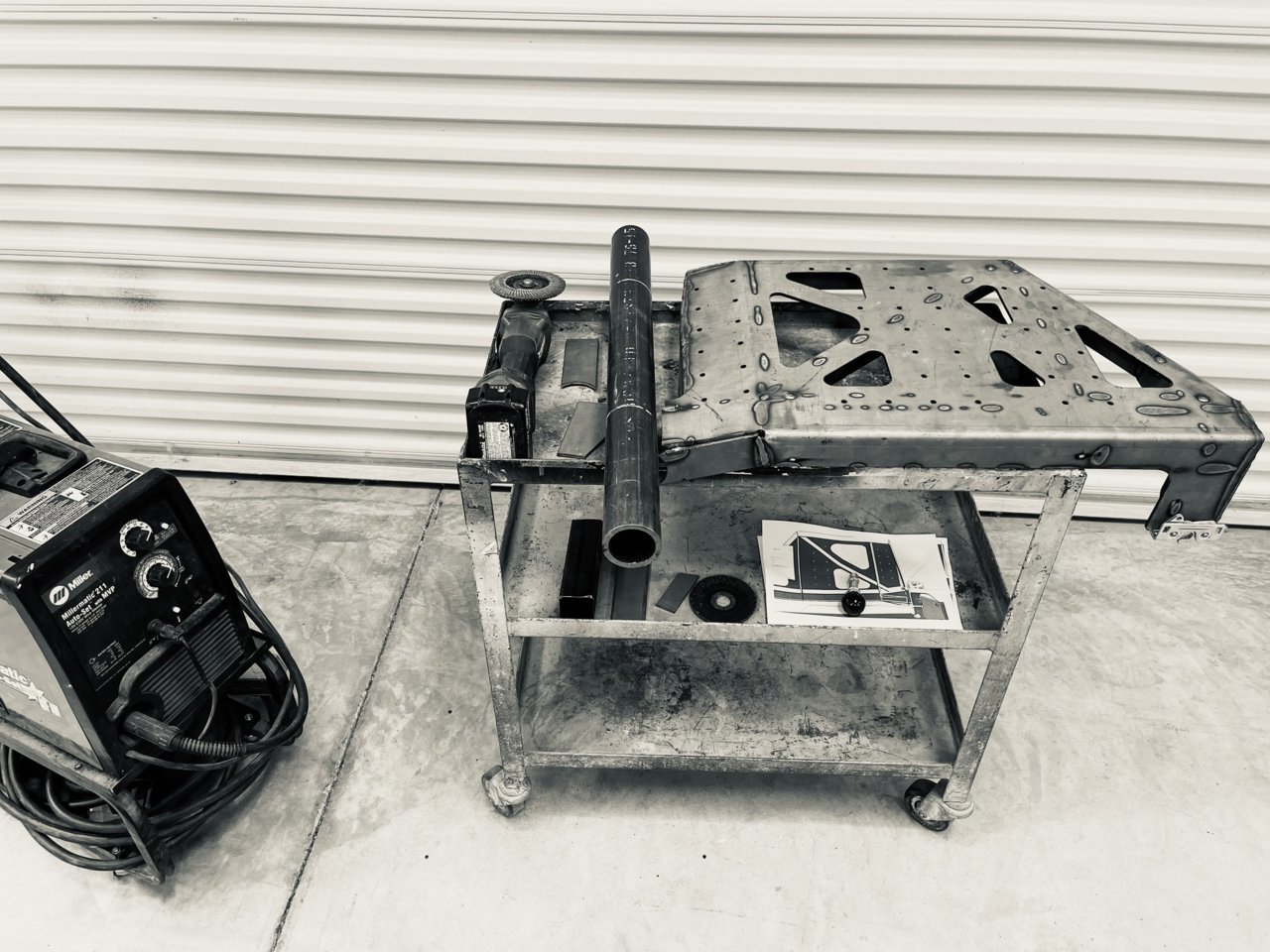

    Apogee Offroad
    Apogee Offroad [OP] Well-Known Member
    Sep 4, 2019
    #304245
    253
    Ethan
    2019 Magnetic Tacoma TRD Off-Road
    Apogee Offroad Bumpers, Baja Designs S8, S2, Squadrons. Warn VREvo8.
    More progress has been made! We're working on the new spindle setup and internal bracing. This is the new passenger side swing. Both are now mirrored for a more modular set up.
    More updates and photos to come possibly this weekend.

  15. Jun 13, 2022 at 10:48 AM
    #415
    CttAznRanger
    CttAznRanger Crazy NE Asian with the Cali Lean (temporary)
    Dec 3, 2018
    #274702
    4,746
    Brandon
    Boston, MA
    2018 Tacoma TRD Sport
    Nice beefy looking swing.
    With all the potential added weight to the bumper, is it going to attach at the stock locations only, or is there plans on having a lot more bracing for support?

  17. Jun 13, 2022 at 12:17 PM
    #417
    Apogee Offroad
    Sep 4, 2019
    #304245
    253
    Ethan
    Part of the reason these are taking so long is that we're trying to make these as rigid as the weight will allow.
    The first test of these was inadequate in our eyes because it lacked the rigidity we wanted. The bumper itself won't be changed. It has a crazy amount of over-engineered bracing to allow little to no flex with the swing outs on.
  18. Jun 13, 2022 at 12:19 PM
    #418
    CttAznRanger
    Dec 3, 2018
    #274702
    4,746
    Brandon
    Boston, MA
    Nice, I like to hear that the team is taking the time to over-engineer it. Better over than under.
    I assume the little flex is with the swing outs on and loaded?
  19. Jun 13, 2022 at 12:21 PM
    #419
    Apogee Offroad
    Sep 4, 2019
    #304245
    253
    Ethan
    Correct. The weight was a 37 inch tire on a method wheel and one of us standing on it. I feel like most Tacoma owners don't go past 37's if at all.
    It wasn't super flexible, but we want virtually no flex at all. Especially if this thing is going to be bombing down washboard roads.
