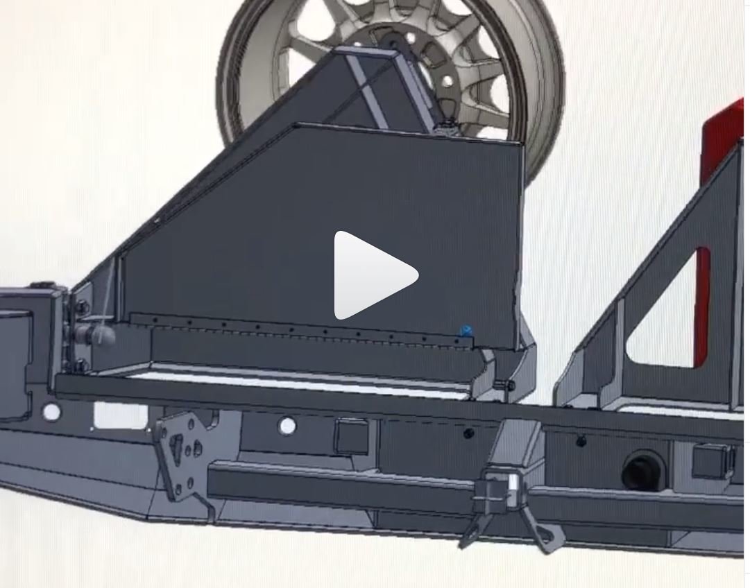

    Hi all,
    Lets clear the fold down table topics up.
    For the fold down tables, we will be offering tables for both sides.
    The way the tables are designed, they will fold down with the tailgate down, only when both of the swing outs are fully open and locked.
    They have cutouts as pointed out in the above rendering ^ that allow them to clear the tailgate.
    They will be large enough to hold a traditional propane stove.
    More detailed photos to follow.
    tacomarin, gitpik, PilotMM and 5 others like this.
