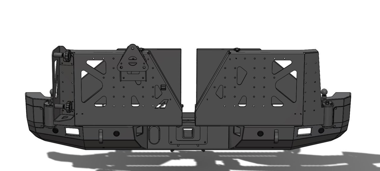

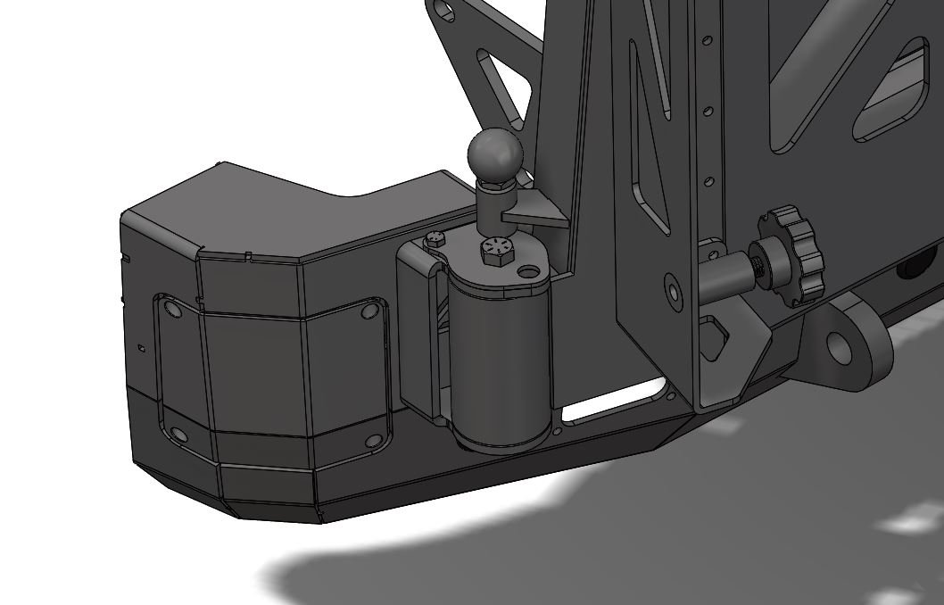

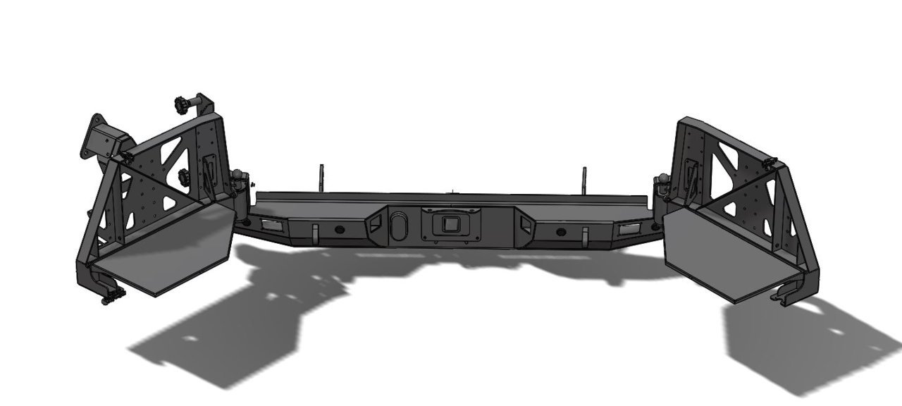

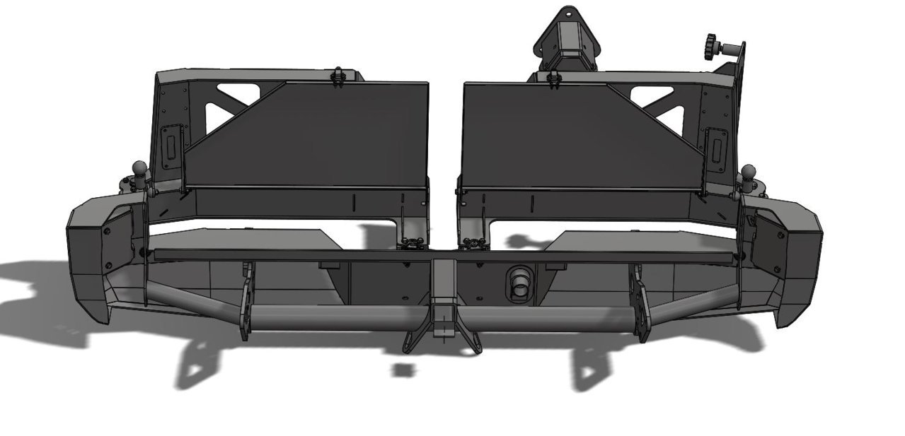

    Hey everyone! Just wanted to check back in and show some changes to our rear bumper to accommodate a more rigid dual swing!
    We've reworked the hitch receiver area for more strength (now that we know people like towing 8500 lbs trailers with their Tacoma) :boom: and added more internal gusseting to the outer ends of the bumper for less flex! Now this does add some weight, but we want to make sure that we're giving you guys the best product we can.
    Still working on more external gussets not pictured here.
    We will be including the gussets for anyone that currently has our bumper and wants to add swing outs with the kit! They will have to be welded for optimal strength, but besides that you'll be good to go!
    The major change to the swing outs is that now they are mirrored! This is a huge step which means you can mount anything you want, in any orientation you want! You want the tire on the driver side for more over shoulder view? Boom! You want it on the passenger side for more Broverlander status? BOOM! Its all possible. You want two drop down tables to master your inner camp cook status? DUH! You want that pizza oven life on the rim of the grand canyon? Be our guest. They both clear the tailgate when open BTW! We will also be offering a backup camera kit as well!
    In addition, the spindles have changed to be one solid spindle instead of two extended heim joints. This ensures more rigidity and easier installation.
    Thanks for your patience guys, I know its been killing all of us with anticipation. Now if COVID could bugger off, that would be greaat.
    I'd love to hear your guys' thoughts.
