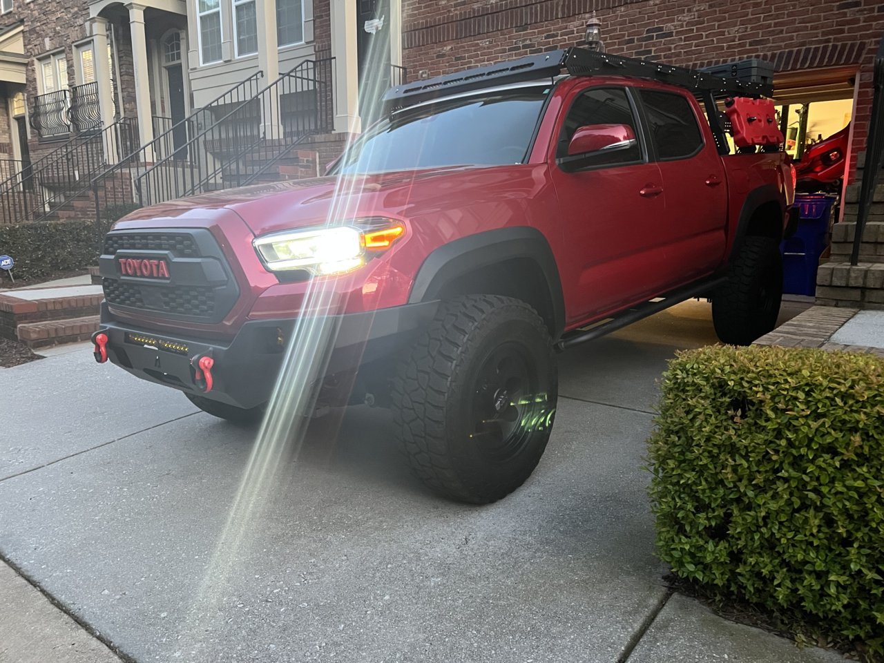

    Update: mounted the Bilstein 6112’s with 700# springs tonight (5/4 circlip) to lift it back up a bit (1” or so with all of that weight).
    Couldn’t be happier with the look and functionality. 6CB82056-35A0-4FB6-938F-381F50A6B36F.jpg

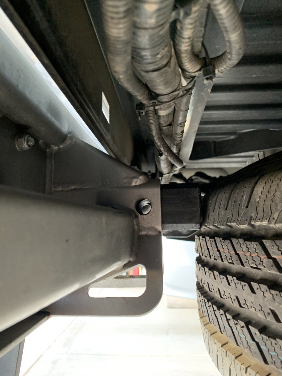

    I'd strongly recommend against this bumper if you actually tow anything at all ever.
    1. The hitch pin hole is so far back that any long shank hitch will extend past it and into the spare tire, necessitating removal of the spare.
    2. The hole isn't 5/8". Apogee says that the bumper should tow as much as the stock but the stock is a Class IV which requires a 5/8" hitch pin.
    3. I could almost hammer a 5/8" through to make it fit, poorly, except that the hole isn't drilled straight: it's misaligned by a solid 5mm (how does that happen on a precision milled bumper?)
    NorrinRadd, C41n and elmontemike like this.

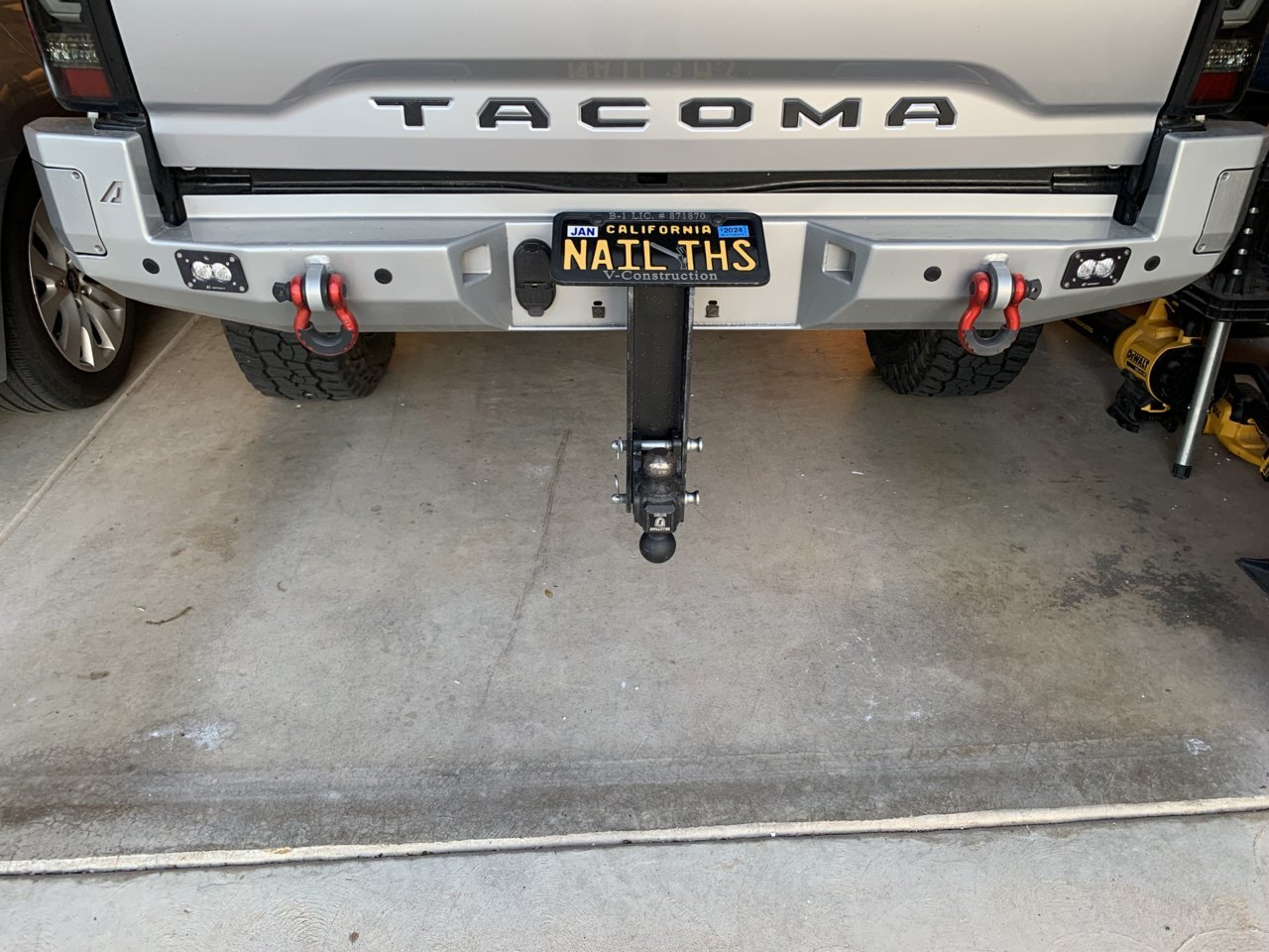

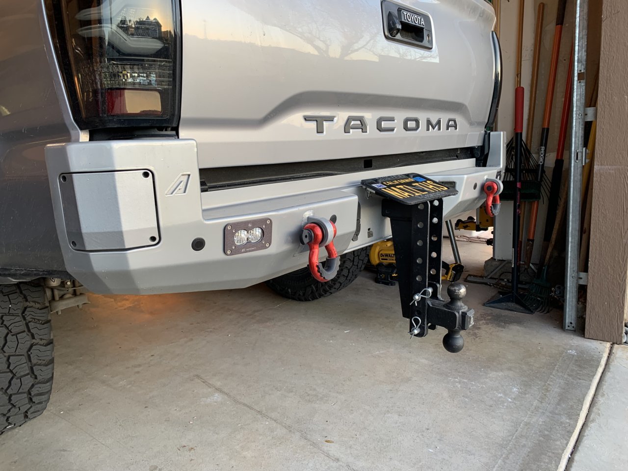

    I had that problem too, my holes were off just a hair. I just slightly reamed the hole very little. There is a company called Bulletproof Hitches that makes a hitch that will work perfect.
    You do have to modify the hitch a little bit. The part that goes into the receiver hits the spare tire so I cut about 2" off holes line up perfect. Ive towed over 5500 LBS no problem.

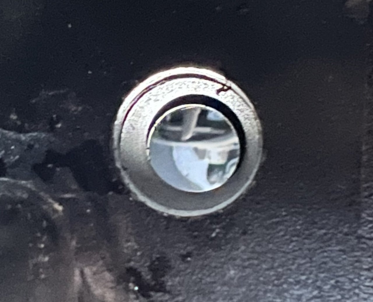

    Finally getting back to this after the snow has started to melt but fwiw Apogee were really good about this. They offered to pay for a replacement bumper (including labor for me to have a shop remove it and ship it to them) or to pay for a local shop to drill out the hitch pin. I was the first one to actually let them know it was an issue, I guess we had all just been silently dealing with it while they had a QA issue.
    I ended up having a shop drill it out while they were doing some other work on the truck and it's like 80% better but not perfect. The issue is still that the holes aren't actually properly aligned and so even though it's now wide enough for a 5/8" pin, you really need to wiggle the hitch around to get it to line up right.
    It's not perfect but it's good enough. I'm definitely not going through the effort to have the bumper pulled and reinstalled after shipping.
