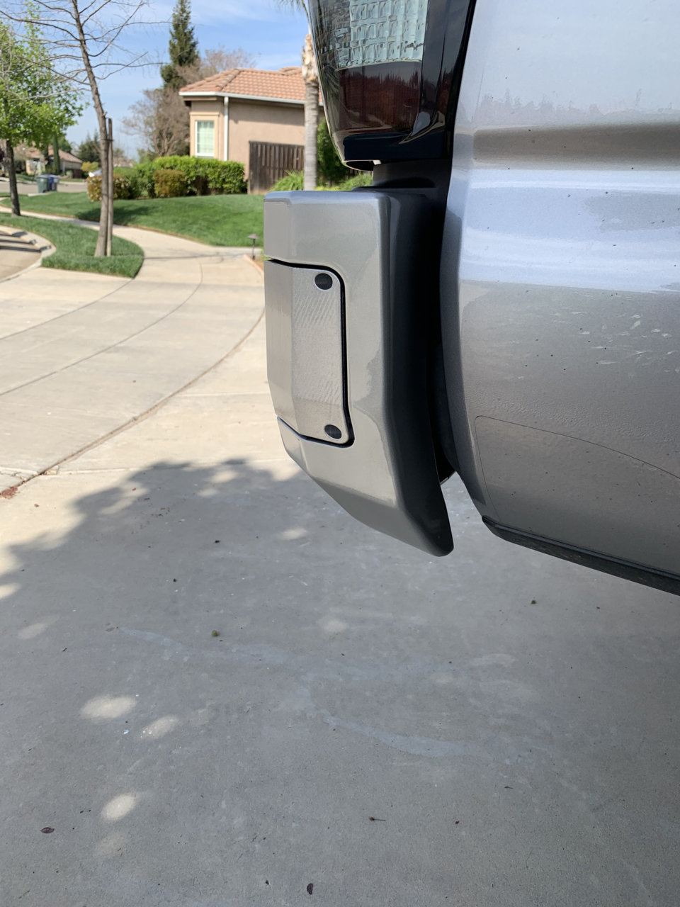

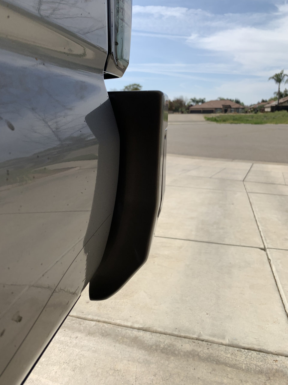

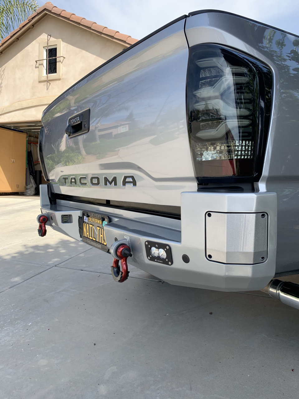

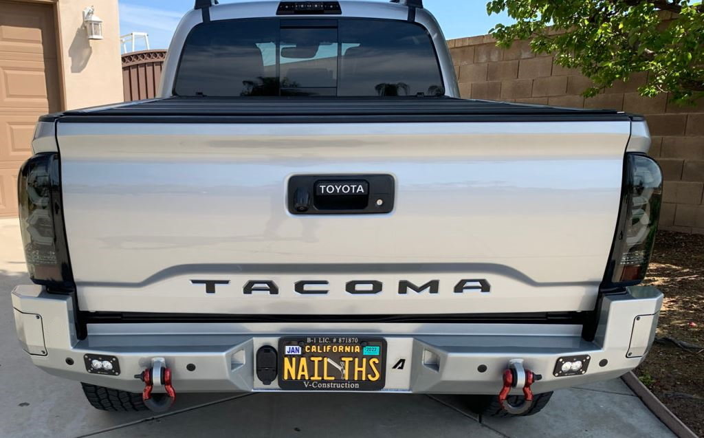

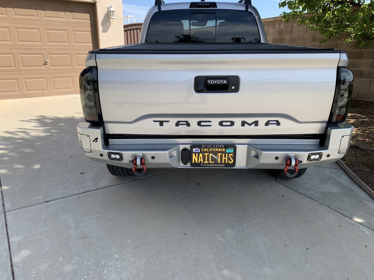

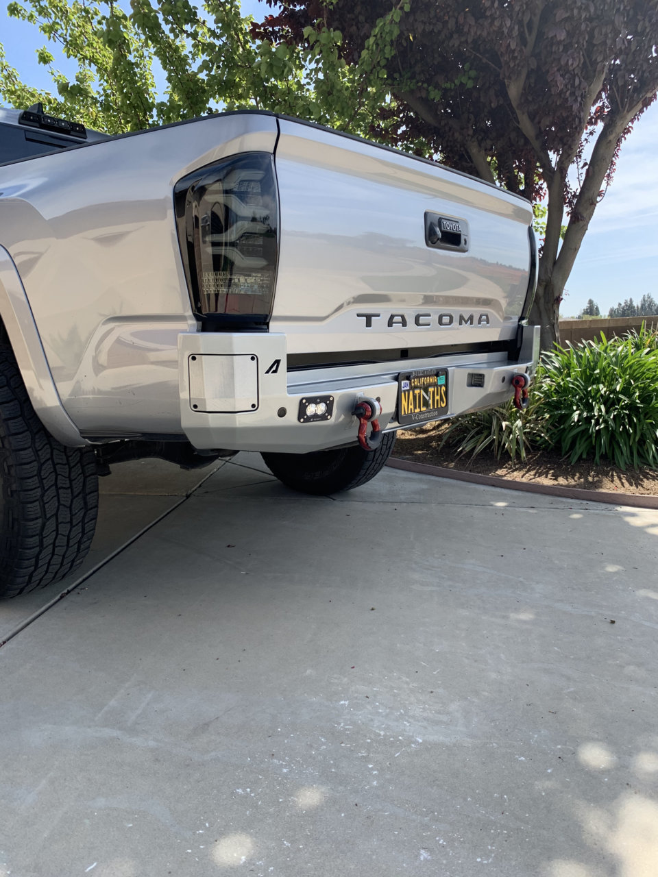

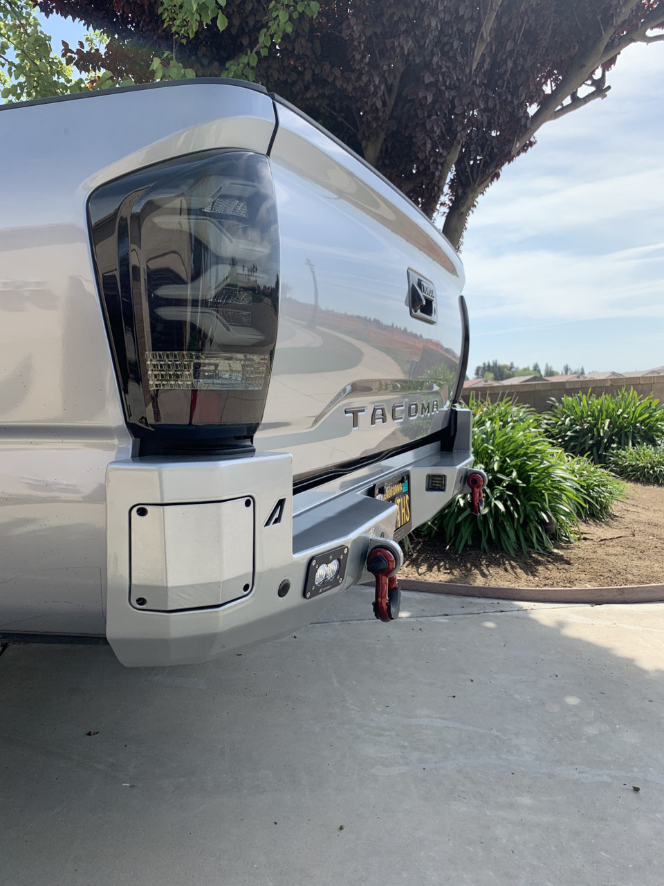

    So I finally got my bumper from Apogee Offroad and on my truck. It took about 6 hours to do the install lights and everything. Mounting the BSM and the flush mount covers was a pain to say the least, Just take your time. Everything works well, just some small issues. I noticed that the parking sensors on the Apogee bumper are slightly slanted more then the OEM bumper. The only issue with that is when your backing down from a slanted driveway and your back tires hit the gutter the middle sensors beep, probably because there picking up the road. Once you go past the gutter they shut off. The BSM'S work good on the road, the only thing that I've noticed is when I'm backing out of a parking stall and a car drives by my BSM'S don't go off and they did on my OEM. Those are the only issues that I would say that I have, none of them are a deal breaker for me the bumper looks really good, I get complements all the time on it.
    IMG_1356.jpg IMG_1357.jpg IMG_1359.jpg IMG_1360.jpg IMG_1358.jpg IMG_1361.jpg

    Looks like it suffers from similar shortcomings as the C4 bumper.

    Any plans on a high clearance rear bumper with BSM slots?
    Hope Apogee can figure something out to fix it. That's the main selling point for this bumper.

    Is it though? I thought the parking sensors going off for cross traffic while backing out were more useful... I'm not looking in a side mirror when I'm backing out of a parking spot, I'm alternating looking in the rear view camera and over my shoulder/out the back windows.

    Thanks for the review, it helps when customers ACTUALLY give us constructive feedback on stuff. If you don't mind telling, what was the biggest struggle with the BSM installation? Did you install them with the bumper on or off? We don't exactly specify, which we should, but for easiest installation its better with the bumper off.
    Man that silver looks sharp. Love the paint to match covers as well. We'd love to use some of these photos as reference if you wouldn't mind!
    As for the functionality, I'm not quite sure what to say there . On our test rig, the cross traffic alert worked as it should, and to date, we haven't heard of that feature not working before. I'd be more than happy to work with you on a solution. Feel free to shoot us over an email or PM and we will take care of you best we can!
    I've seen the parking sensors do this once or twice on the test rig at some steep curbs. Thought it was just a fluke as it only happened occasionally. The parking sensors are some pretty finicky things. There is definitely a trade-off on functionality between all of the electronics/strength/clearance. We definitely tried our best to keep both in mind.
    Thanks for being cool about some of the shortcomings, we hope you enjoy.
    Feel free to reach out anytime!

    My opinion, (see picture below) possibly relocate the "A" to the right of the license plate. Also, the sides are a bit "proud", but I'm sure there was a reason for that design (locating the BSMs). Otherwise, looks like a solid product! Hopefully, the BSM gets sorted out. :thumbsup:

    They probably will have to relocate the "A" w/the swing out version. I don't mind the proud-ness given the additional functionality of the BSM, but I think the HC version will look the best in that regard.
