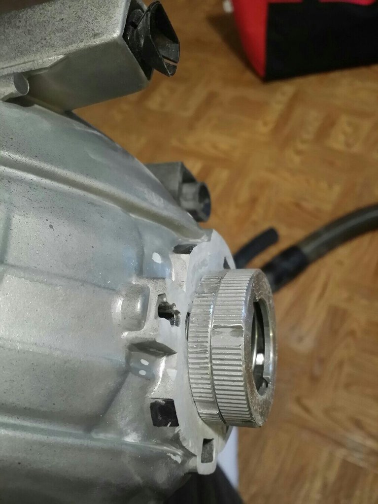

    Yeah the shaft is shorter. I had to shave the back reflectors a bit

    I'm learning that the hard way right now. I can't get the Cap to hold the bulb inplace because all I can get is 2 threads. I've done FX-R's that take less time than this.
    Can you describe what you mean by shave the reflectors? Maybe I'm tackling this the wrong way.

    Of course you can't go back stock after you shaved it. I used the hex nut not the round ones.

    Thanks. I'm not worried about going to stock I just don't want it to get weak and break. Guess it's time to bust out my dremel tool.

    1. You DO have to shave/cut/modify your headlights to make the Mini DS2 3.0's fit. I've talked to 7 different people, every one of them had to modify lights. 5 more threads on the projectors and it would of been plug n' play.
    2. Thew new cap system sucks. My bulbs jitter like crazy. I've verified the bulb is doing the jitters by replacing the cap with one from the Mini DS2 1.0's. Works prefect.

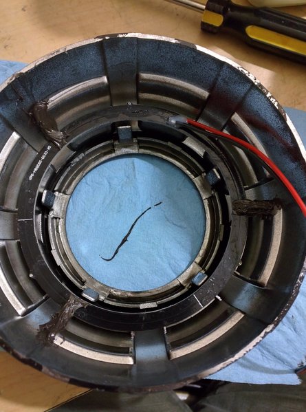

    Revival because I am doing the same job. I have already used jb weld on 3 points for the inner halo. Now I'm wondering if I need to use jb weld to hold the Apollo 3.0 shroud on?

    I used a slight dab on the little hook things.

    On those 5 spring tabs? I thought about putting some around the ring where it touches the projector.

    The 5 spring tabs touch the metal part. I used I slight dab on each hook and I have had no issues with it. I felt like it was very secure. Just when you put it on have the projector face up while it dries.

    And don't go crazy. It can drip into your bowl and high beam solenoid. Ask me how I know :oops:

    I thought about that, but I was mostly worried about dripping it on the lens. So I waited until it was more tacky and would stay in place, and a bamboo skewer.

    They make a JB weld that's not liquid but high heat putty. It doesn't drip and that's what I used, held up just fine.
