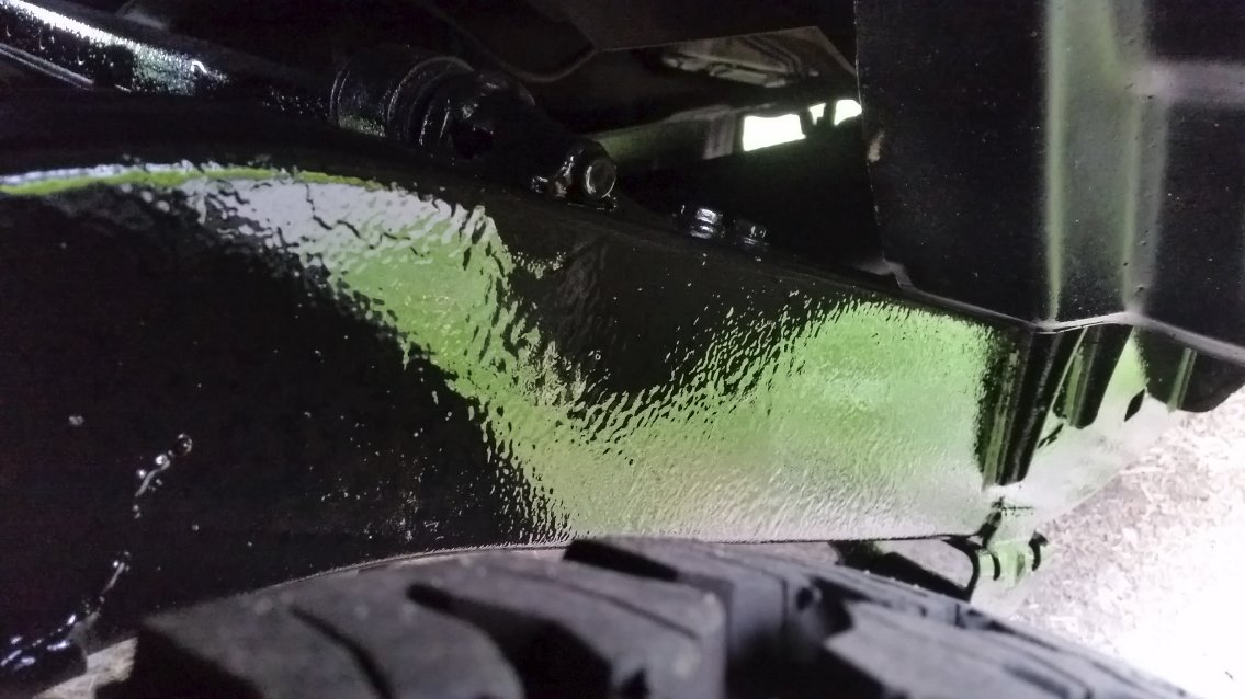

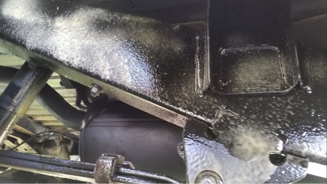

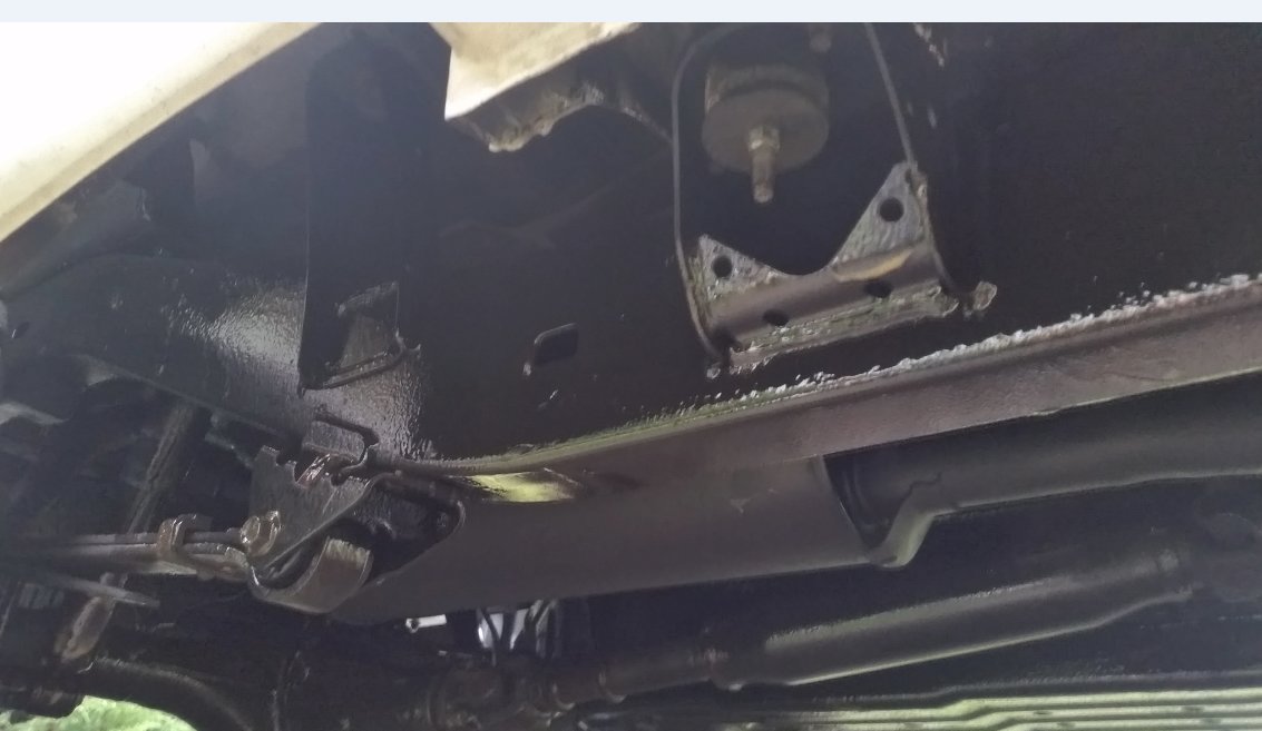

    Funny you asked, I just did my truck today:
    Washed the frame for the second time and applied Fluid Film. Painting the exhaust.
    Things that were not mentioned yet:
    1. Pressure wash any mud or dust of the frame leaving bare metal (if covered with surface rust it is OK). Flush the guts of boxed frame till you get clean water coming out. Both will make FF more effective.
    2. Spray FF on the frame, inside and outside, but do not forget about other parts the road salt is eating: third member, all suspension parts, all nuts and bolts, especially these sticking out of the body, skid plates - basically any exposed metal you see. In my truck I also do inside of chrome bumpers - the chrome looks nice, but I see some surface rust from the inside.
    3. One gallon is more than enough for all that. With over-spraying in many places usually I use less then 2 litters - that about 1/2 gallon.

    It does not wash out that easy. The guy hit it with the pressure washer "spinning" wand that will take the paint of your car :). I used that wand to clean concrete. If you hit fluid film with washing wand it will come off only if you use soap and hot water. There is no way it will come off in normal road use. Here is how the fluid film holds in a real life https://www.tacomaworld.com/threads/spray-por-15-inside-frame.614253/page-2#post-21175850

    I see no reason to run through that full detail car wash in the winter unless you want to sell it next day :D. If I want to wash my car in winter it will be only from the top (washing painted body) and not touching anything below rocker panels. And by the way after my move to Poland I have to face the same problems that people from north-east have. It is enough to get 1 inch of snow for the road maintenance companies to dump another inch of salt on it.
    And yes, spraying the inside of the frame is actually more important than outside. Every year when I flush the inside of the boxed frame I almost taste that salt in the mud coming out. So my routine is to wash the frame only after winter is over and streets are clean from the white powder left after winter. Then flush inside both sides of boxed frame and cross-members with drain cleaning wands till only clean water comes out. Let it dry for a day and next day blast everything with fluid film including inside of frame. Because I can't see how much fluid film is pushed inside the frame, I give is twice more what I would think is enough. If Fluid film is oversprayed it does not drip (at least NAS stuff I'm using) but it flows slowly even out on the surface. here is the picture of overspray I did yesterday and how it looks today after sitting overnight.
