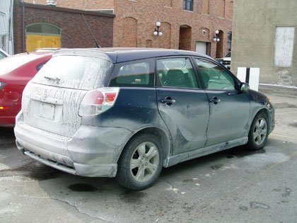

    Well, no, but in the matter of a few snowy days of driving, vehicles all become the same color, a crusty white, gray/brown, comprised of salt, mud, and road grime. So, you have to wash whenever you can.
    Example:
