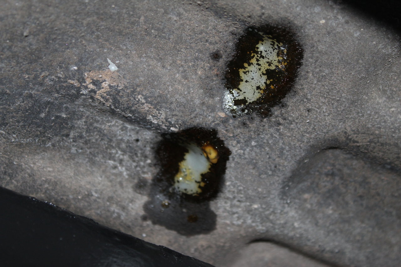

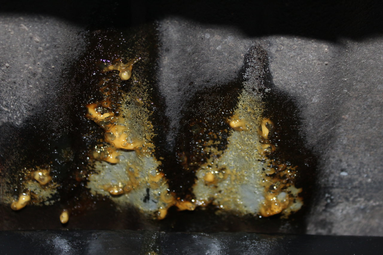

    i have routinely power hosed and rinsed out my wheel wells, doorjams, tailgate, suspension, top of fuel tank area as best i could, etc etc, routinely for 1/4 century (25 years!)
    its probably the best reason my truck is in the condition it is in with no FF that i have no clue about never heard of it
    and will have to see what happens when i get back onto the routine of winter washing
    but this is what that stuff is currently doing to my rubber undercoat i damaged on the floorpan on driver side after 3 weeks of application to cover a few naked spots
    what is going on with this stuff and what kind of a rats nest of a mess am i going to be finding myself in with this :notsure:
  13. Nov 30, 2019 at 2:08 PM
    #53
    agalloch07
    agalloch07 Well-Known Member
    Oct 15, 2016
    #199847
    210
    Rubber undercoating is garbage. Once it starts to peel it will trap moisture and salt against the metal where it will make rust worse. I have a 2wd first gen that was factory undercoated because of the recall before i bought it. The first few years i owned it i washed it constantly during salty winter months. About half of that crappy rubber undercoating got blasted off the frame. I need to take a scraper and scrape it all off but im just to lazy to do it.
    I just started using fluid film/woolwax this year. My plan is to coat them right before they start salting roads and not wash the underside. If you wash the underside your just spraying the protective layer of fluid film off your undercarriage and it will do no good at all. Once spring gets here i will look at the underside and see if i should give it a wash or just let it go. I know dirt is going to build up and it will need cleaned i just have not got that far with it yet.
    After owning many jeeps CJ's specifically and loosing them to rust the only areas that were rust free was the transmission tunnel that was coated in oil and dirt that turned into a greasy black tar that nothing could penetrate. I kind of want to do that to the entire underside of the 4runner and 2 tacos. Yeah it looks like shit but at least i will still have a frame and floor pans 10 years from now.
    Forgot to mention that i use bar and chain oil inside my frame using a woolwax pro spray gun and a 32" 360* fluid film wand.
