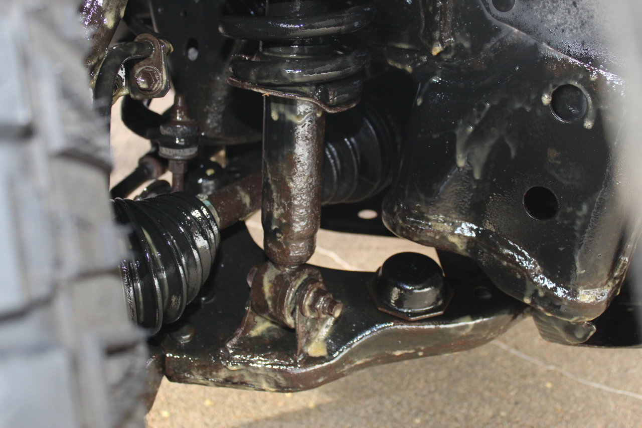

    FF drizzle, thick and nasty... applied yesterday to front passenger side
    these parts have never seen anything much other than a wand hosing/rinsing down so they are slightly weathered

    Looking good. Being that FF is Lanolin based and not petroleum based I wouldn't hesitate to cover everything underneath including the wheel wells. Or whichever Lanolin based one you choose to go with, just hose that sucker all down with it. It can't hurt any of the components. Only help. And you'll be able to see by this time next year if surface crap got any worse by comparing to your pics.

    i can tell you that when i sprayed the FF on parts here it sizzled like bacon lol
    that is probably a good thing? dissolving some surface corrosion
    will definitely be needing some new parts under there one of these years
    sway bar bushings look all cracked too when i got a good close up view

    The sizzling thing I dunno, I don't think it's gonna be a bad thing. But the thick metal heavy components that get surface rust like a spindle won't need replacing. No surface rust is gonna compromise the strength of that spindle. The sway bar bushings looking dried and weathered you say? Many times the links themselves are just fine. Surface rust on those won't matter either, unless it's on the threads making it hard to loosen the nuts. But you can just replace the weather bushings themselves too. I think you can also just replace the whole link that the bushings sit on also.

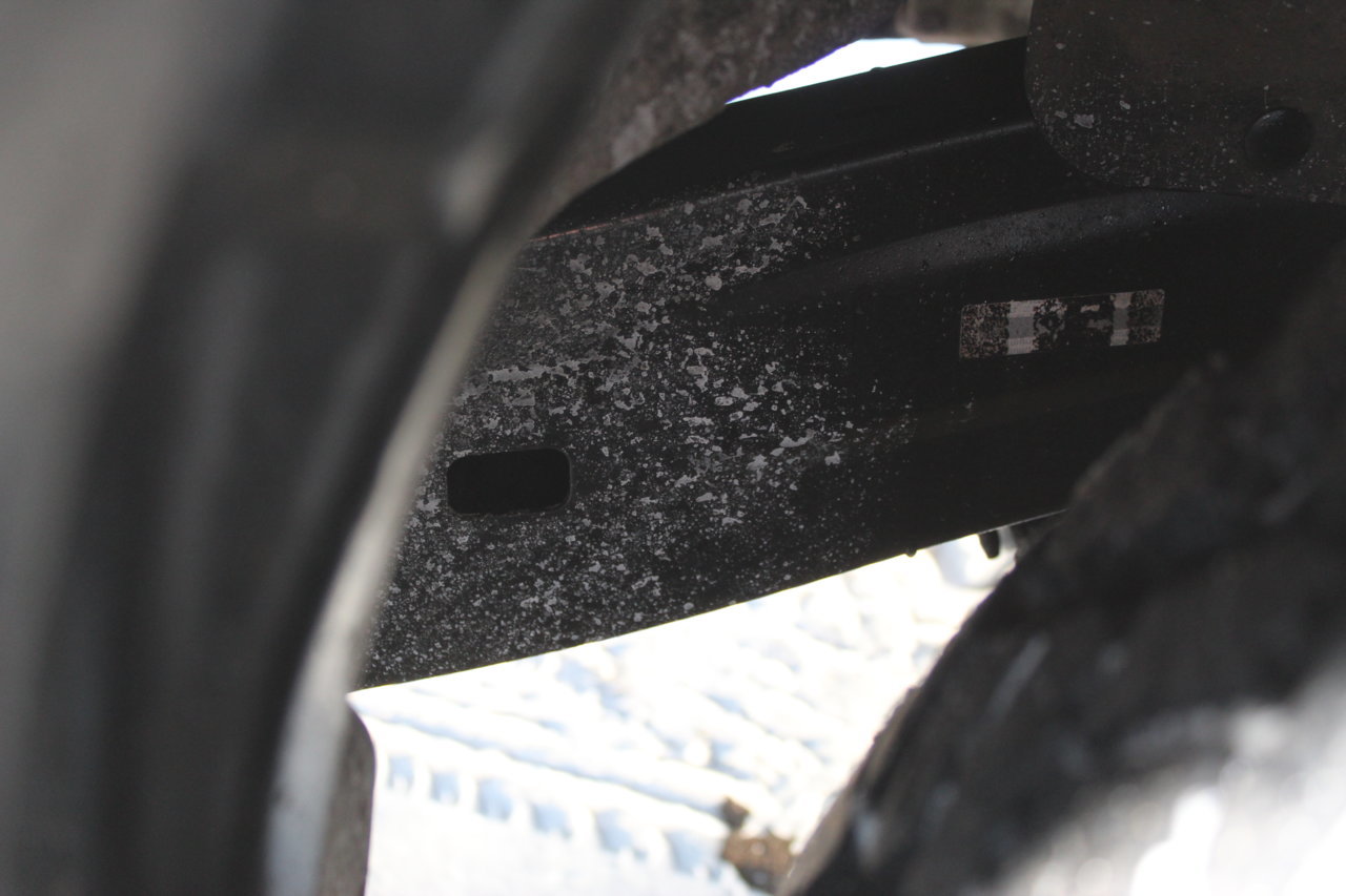

    overspray from that suspension drizzle yesterday i can produce a pic of FF in action today with de-icing spray right next to it
    i was driving on mostly dry roads today, less than an inch of snow out but they coated streets with it
