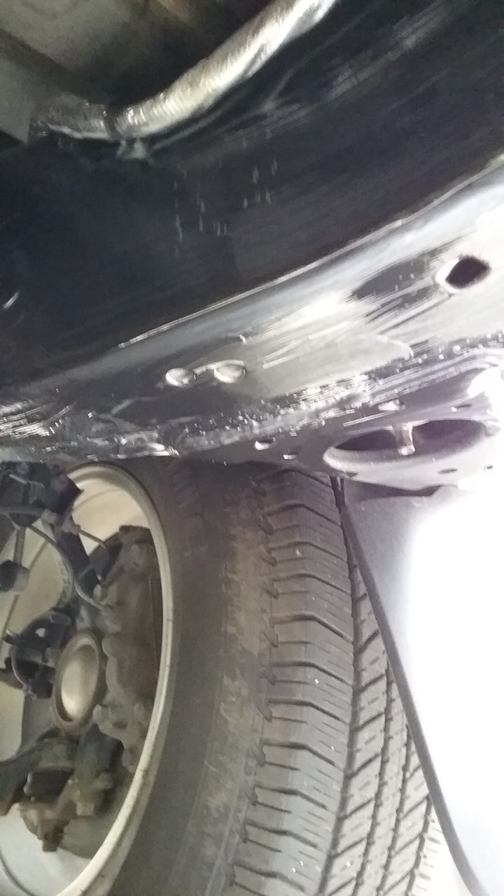

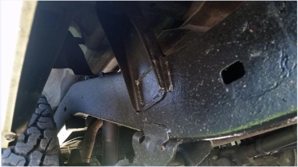

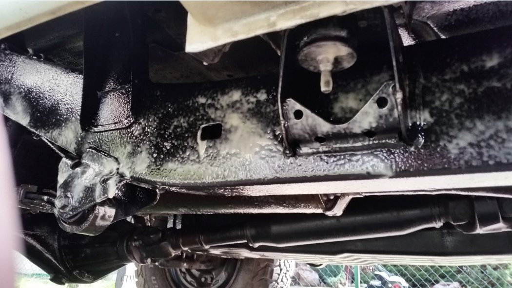

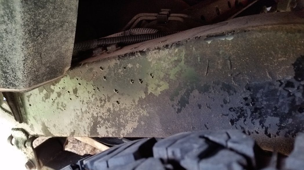

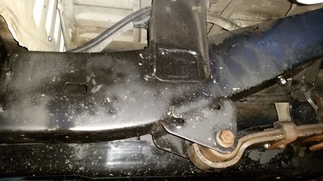

    Late to the game, but that's what I found so far in my 2 years experience:
    1. Pressure washer (especially soap and hot water) will remove fluid film from frame. I do it after the end of winter to clean the frame from the all the dirt that was stuck to the frame (fluid film is sticky on the surface) and wash out any trace of winter salt from the truck.
    2. I use "drain cleaning wand" to flush the dirt from the inside of the frame. It is cold water and tap pressure so most of the last year fluid film probably stays in. I just want to clean any dust or mud that might be accumulated inside boxed frame after the winter.
    Here is how the pressure washed frame looks like (hot water and soap at self car wash). You see most of the last year fluid film got washed out
    After the frame is dried I apply generous dose of fluid film outside and inside boxed frame. I hit also some suspension parts, inside chrome bumpers and any mounting bolts and nuts. Basically any metal exposed to the environment. That how the fresh fluid film looks like (I have to admit I overdid it, and the first time I hit 50mph after applying FF I saw the cloud of mist fluid film (sorry for the guy driving behind me - his windshield wipers were not able to clean the mess)
    Four months later all over-application was gone, some dist collected to the surface and the frame looked like that.
    Another four months passed, and nothing really changed
    And finally after 12 months (just before washing the frame after the winter again):
    The last picture is taken after I returned from a hot water + soap pressure washing
    An that cycle continues. I have not seen even a spec of the new surface rust (besides the one that I brought from California).
    I am 100% sold on fluid film. First year I did using spray cans, but the next year I bought a gun, as the fluid film by gallon is half of the price spry cans.

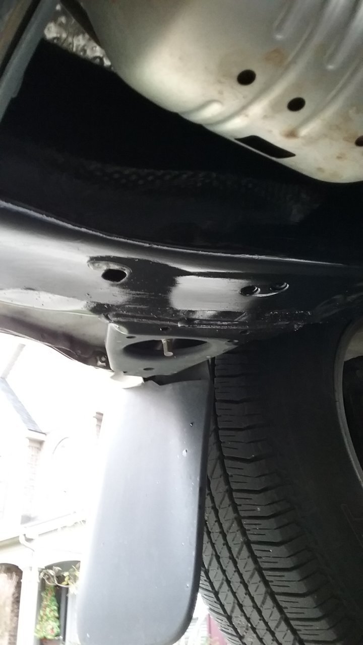

    No pics, but the reapplication used less of the FF than the initial application. I basically did a quickie recoat, with most of it inside the box sections of the frame. :thumbsup:

    so you did not have to completely wash it all off to reapply?

    Nah, I figured it would be fine as an added layer on top of the residual that was there. It was between the spring and fall so it was never really exposed to anything bad, other than just driving in the rain. I just did the reapplication in October and called it good.

    Yep, 2WD and really does have low ground clearance for a pick up (just one reason why I love it). I had the whole thing up on four jackstands when I did the job.
    When I went to do the reapplication in October, I stuck my pinky finger into several of the ports of the frame and there was still plenty of FF inside, and it still looked fine. It had mostly rinsed away from the exterior of the frame from driving in the summer rain, but I did a quick reapplication there as well. I should mention that I had painted the entire frame with gloss black Rust-Oleum when I bought the truck, since it was mostly rust-free. The FF probably didn't have much of a chance of sticking to that clean glossy paint.

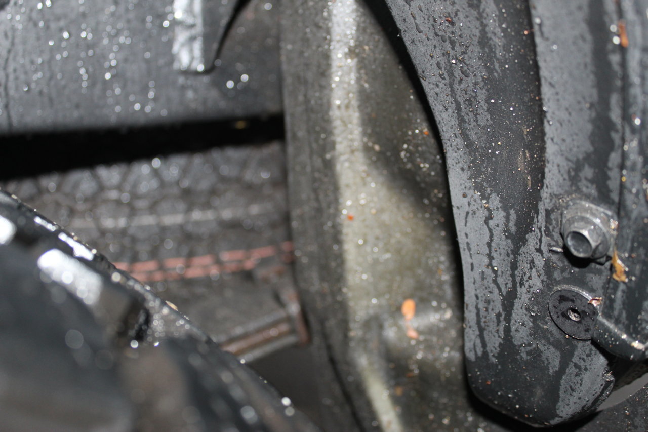

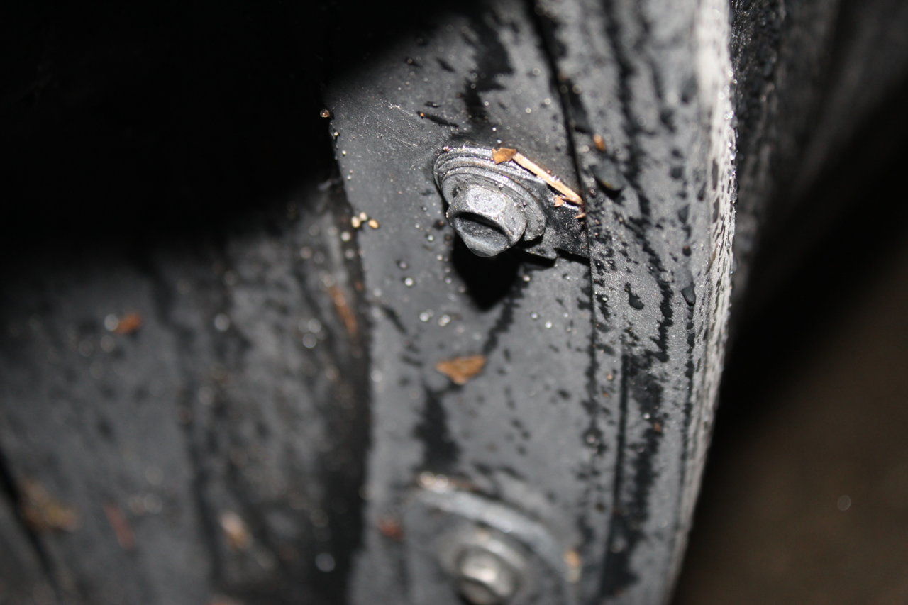

    i am curious if wool wax holds up well in the fender wells
    the other product i used here seemed to just wash right off of the plastic fender liners while out driving the highway in nearly 2 inches of heavy rain yesterday, it was sprayed on fairly heavily too
    also i can not really tell if there is any product left protecting the arch moulding bolts that i made a big investment in getting all new ones earlier this year, 26 of them!

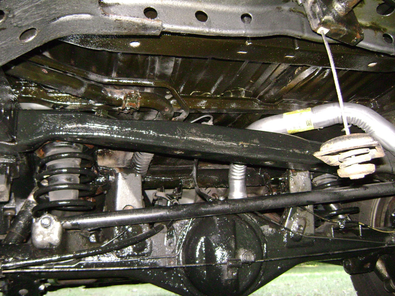

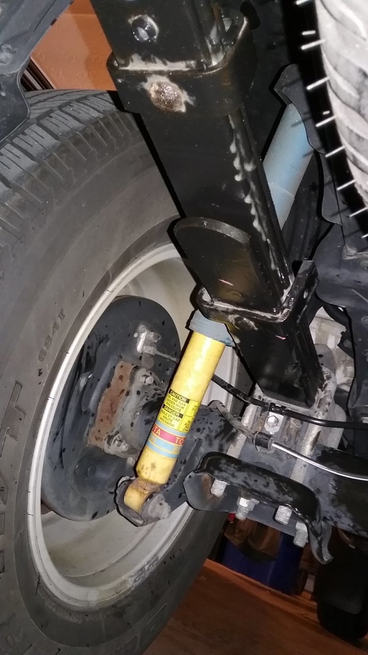

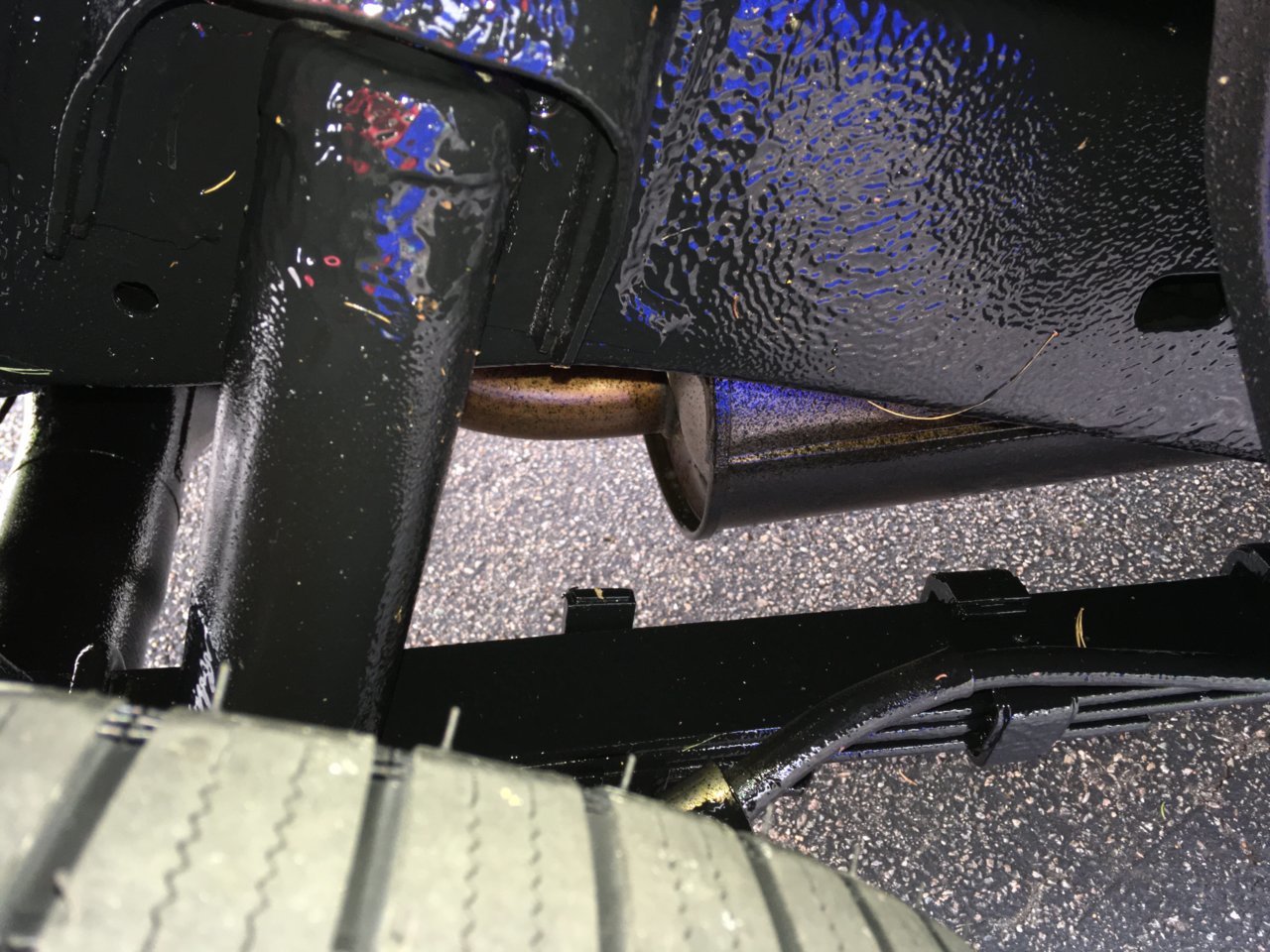

    Decided to do a bit of preventive rust protection this winter. Bought 3 cans of Liquid Wrench rust inhibitor. I mainly focused on the problem areas around the cats. With all the holes in those areas it was easy to fill the inside of the frame. Put a coating on the outside as well.
    I also sprayed down my leaf springs...lifting the body so the axle would droop. That way I could get the product in between the leafs.
    20191201_115949.jpg 20191215_160452.jpg 20191215_160441.jpg 20191201_131552.jpg
    GQ7227 and cruiserguy like this.

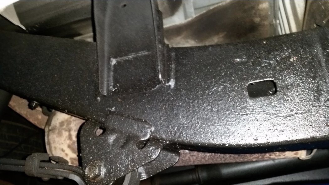

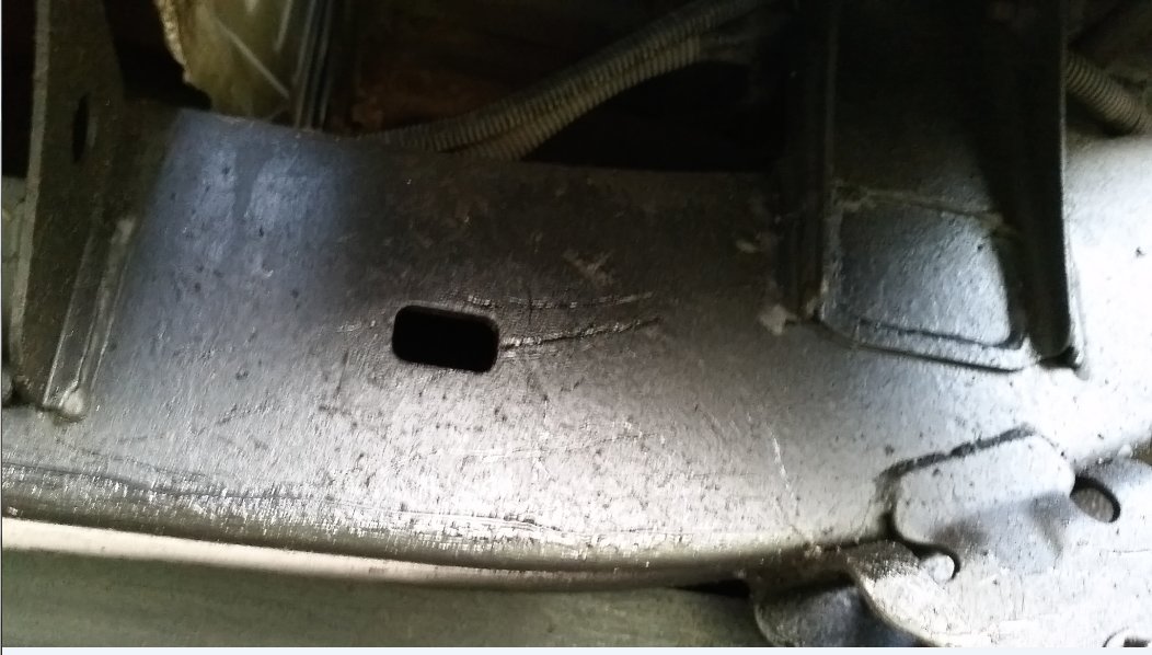

    my relative's '11 has a very thick rubbery undercoating all over everywhere, a lot thicker coating than they had applied to mine in the '90s
    i was inspecting with my little dog barking orders at me and it is already showing cracks through the coating by the Cats and hinting of rust already

    Yeah...sounds like Toyota's infamous undercoating they started having dealers apply as a countermeasure to the rot.
    While I think it's great that Toyota is willing to extend the frame warranty for 12 years on the '11-'17s...you have to have the undercoating applied to qualify.
    I"ve seen too many horror stories of frames rotting out underneath that coating. Not to mention it doesn't really address the root cause of moisture and salt getting inside the frame...especially around the cats.
    I'm rolling the dice and forgoing Toyota's Micky Mouse undercoating and taking matters into my own hands. Thankfully where I live doesn't usually get huge amounts of salt used during the winter....although Toyota does list Kentucky as one of the "cold weather" states.
