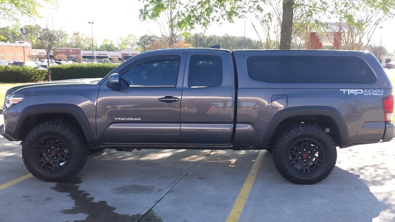

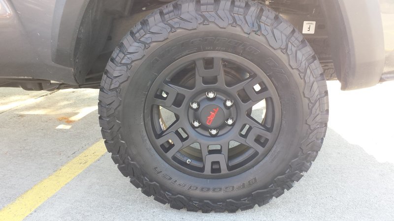

    Pics as promised

    That's neat..... I guess. You will notice in my pictures that mine is "sans el mud flappos"
    Sorry about your predicament.

    thanks so much 4 posting! truck is looking epic!! looks like the new tire setup fill the wheel wells nice and match the truck way more then stock setup hows the drive at 35psi? notice any differance in driving or shifting of the trans with the new tire setup and leer top weight? thanks for all the great info and posts! aloha!!!

    Looks great and runs down the road smooth as silk. Thanks for the compliment!
