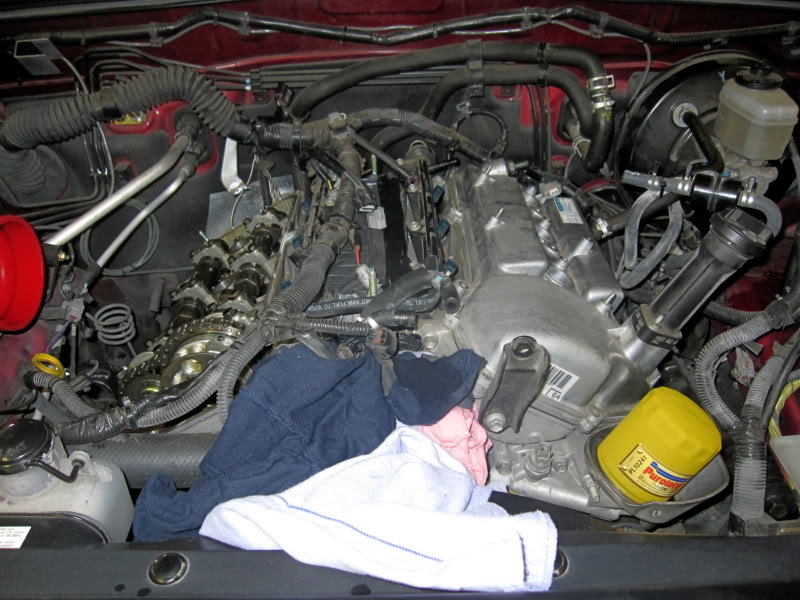

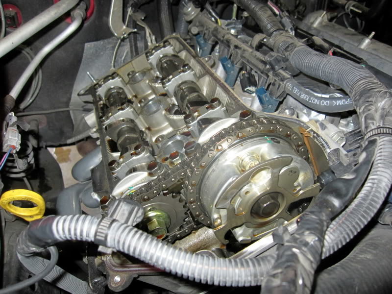

    Big thanks to Torspd and Grumpy over on XRU for their help on the X1 install.
    Install went fairly painlessly except the driver's side cam bolt was a tough one. I would highly recommend you guys get a longer 17mm wrench, preferably offset.
    Also, if your truck is an auto, make sure to set in Neutral before you start. This way you don't have to come up with some creative ways to get there after you've taken apart your valve covers.
    Lining up the cam gears was pretty simple so I think we got lucky there.
    Here is a pic with the passenger side valve cover off. Ready to remove the cam bolt.

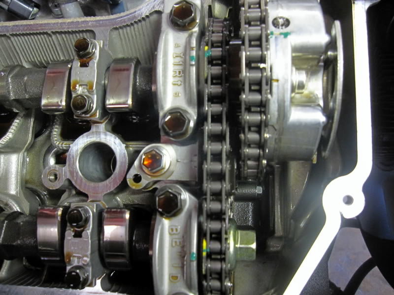

    Closer shots of the inside
    It definitely helps having some good people helping you out and good tools obviously. The thermostat and X1 went in with no issues. The truck started just fine and it ran like a champ on the long trip home.

    Sounds great! Looks like someone got a little generous with the RTV on the inboard side near the chain. :)

    That was there from the factory. Both sides were like that so I guess it's normal. Thanks.

    why are you putting it in neutral?
  17. Aug 16, 2009 at 12:45 PM
    #17
    wrmathis
    wrmathis Dark Lord of the Sith
    Sep 10, 2008
    #9126
    9,316
    Bonaire, GA
    2006 Tacoma TRD OR 4x4
    parts and stuff
    im gonna guess he put it in neutral to be able to rotate the engine to the right place to install the sprokets?
  18. Aug 16, 2009 at 12:58 PM
    #18
    SpaceMonkey
    SpaceMonkey [OP] Well-Known Member
    Apr 12, 2009
    #15886
    600
    Houston, Tx
    06 PreRunner
    Yes, put in neutral so you can rotate the crank shaft to line up the timing gears.
