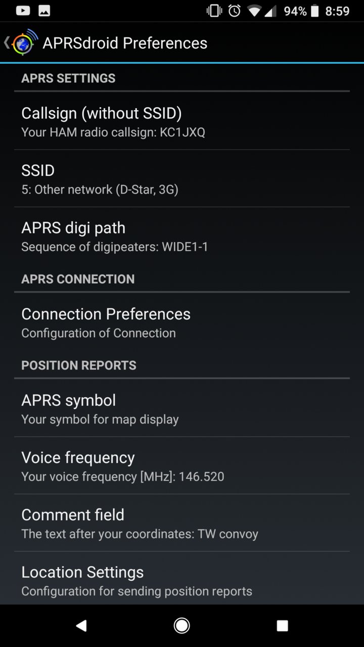

    Foreward note, this is a learning journey for me. All expertise and helpful input is encouraged and appreciated.

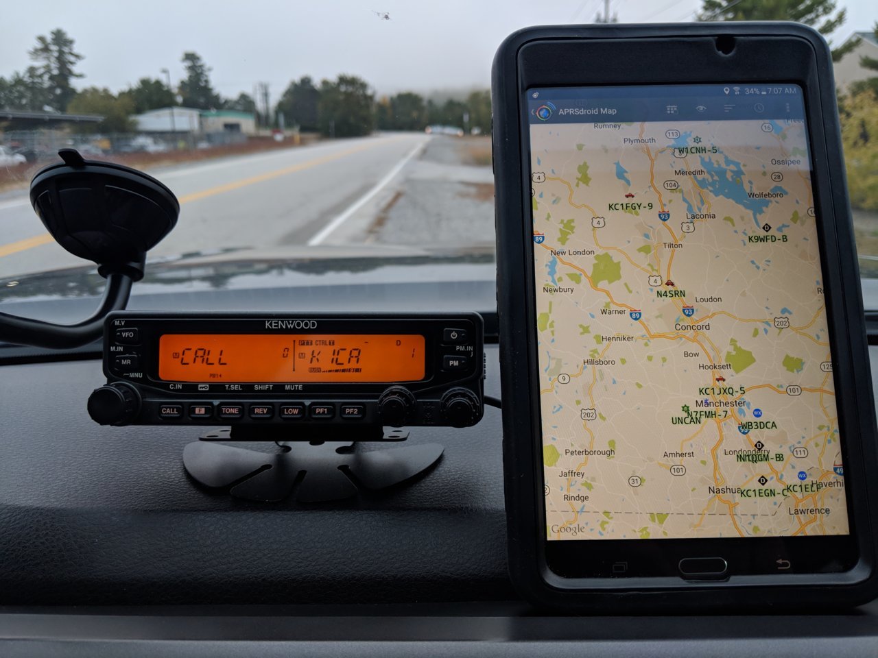

    Currently I'm using the APRSdroid app with great success. While on a group trip I was able to signal my location for all other users to see. Pinned to my real time icon was gps coordinates, the frequency that the group was utilizing, a comment box that we used to identify ourselves as the TW trip in case newly joining travelmates didn't know our call signs they could scroll through the comments field, and also can show a plotted course over time.
    Two of the biggest benefits I saw while using this was the ability to keep track of the two groups we had convoying through our trip in Vermont and NH. With plenty of repeaters that support APRS the locations were updates at regular appropriate times (we can cover frequency of sending information while traveling later).

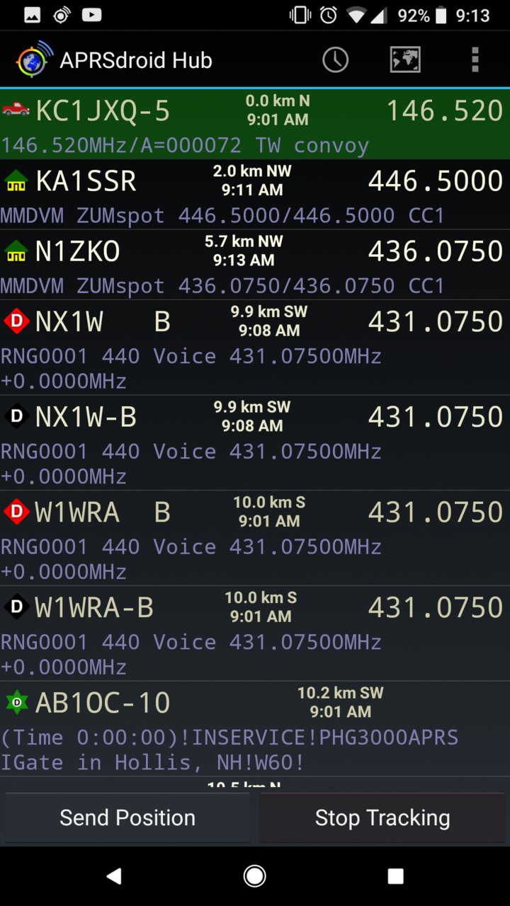

    The next was that there was never any confusion on what frequency we were on for communication. A simple look into the directory would show the TW groups comment and the frequency listed right next to it. Anyone joining the trip or even a third party that wanted to contact us would now know who we are and how to reach us. Works great when you roll camp at 10:45pm which is a cell dead zone, but at least you can find them on the radio to let the group know you're almost in. Haha.
    And now some more about the app. The first thing is to sign up if you're a ham and have a call sign. You can do it right in the app.

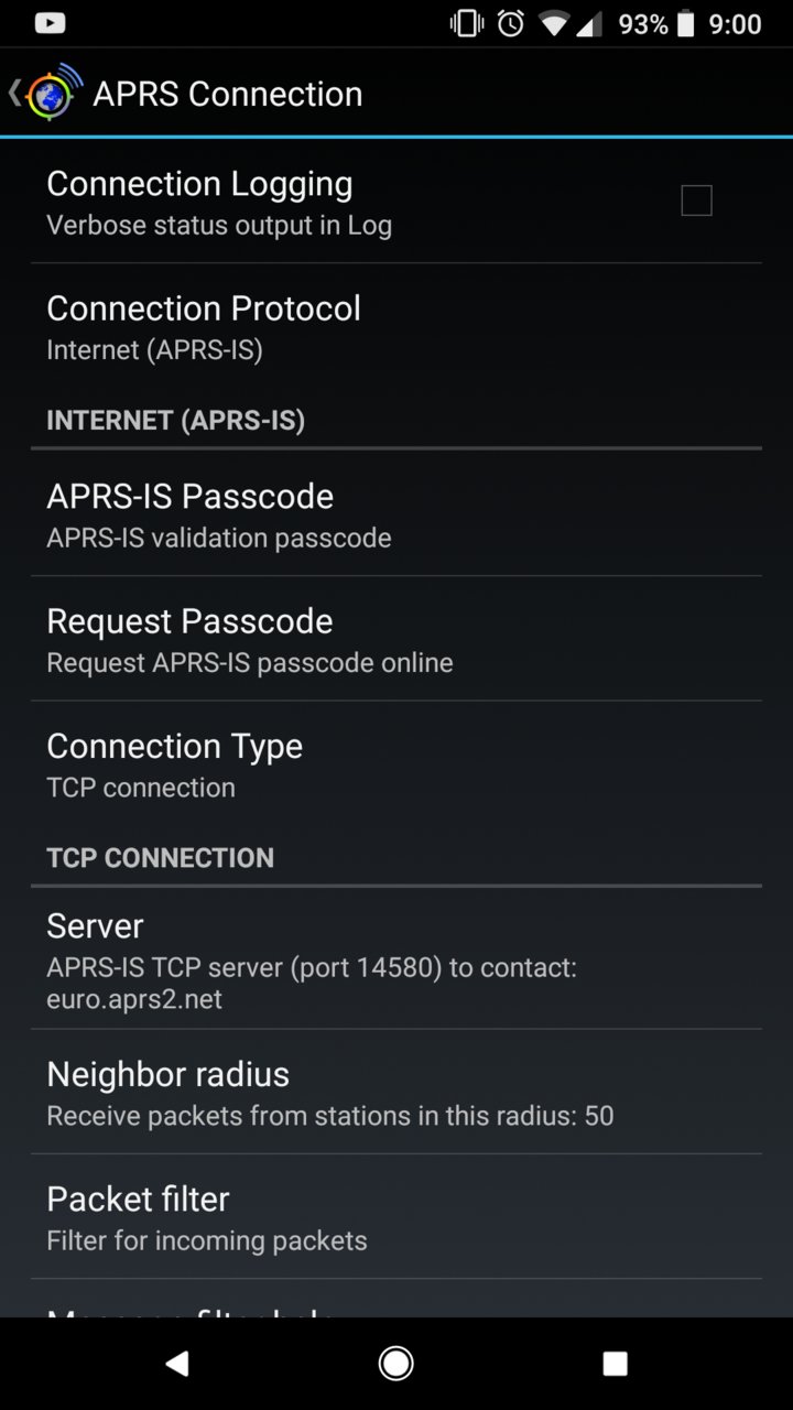

    First go to preferences in the top right of the app. This will prompt this screen. Next search for the connection preferences.
    The next screen is
    From there you can request your passcode. This passcode pin they give you is APRS specific and works on other apps as well.
    Once that comes in you'll be able to recieve and transmit information. Without this you will only be able to monitor the maps.

    Now if you look closer you can see my information I input from the last trip on the first picture above. Both my frequency and a small note was listed. In the top left of the app is a button that will eventually bring you to this screen called the APRS hub. I bet you can spot the TW user and information on your own
    If that call sign is selected you can bring it up on the map to locate them. (Btw Garmin and others support APRS as a guided destination. More later)
