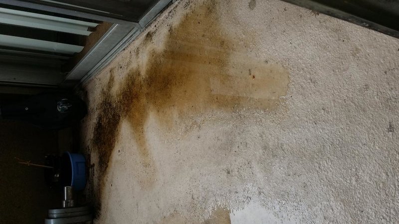

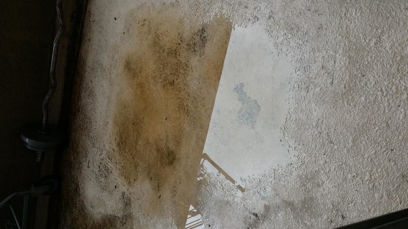

    Pouring rain yesterday, cant help that... but my balcony got soaked bad. Is there anything i can put in the opening area so that the rain doesnt get all over the balcony floor?

    if you are on a first floor unit you could just make a small kerf cut from the lowest point of the puddle to the drain on your patio.. just a blades width and deep enough so the water will drain out of the puddle (dont want to risk cutting a cable if it is a post tension slab).. but if you are on an upstairs unit that has gypcrete balconies then you'd be better off using an epoxy or some other leveler slope it away from your door

    Im on the second floor. I see one or two balconyes with like mesh instead of it being open and another with .. looks like a ... canopy.. a cover like drape you see at the beach?? Is that something i can add omo (on my own) or would i need to ask the apt manager?

    My first guess would be the door's track has plugged up weep holes, filling the track and overflowing into your living space.
    Do you have a step down of any distance when you step onto the balcony?.... or is it at the same level as your apartment floor?
    Is your balcony floor draining properly?
