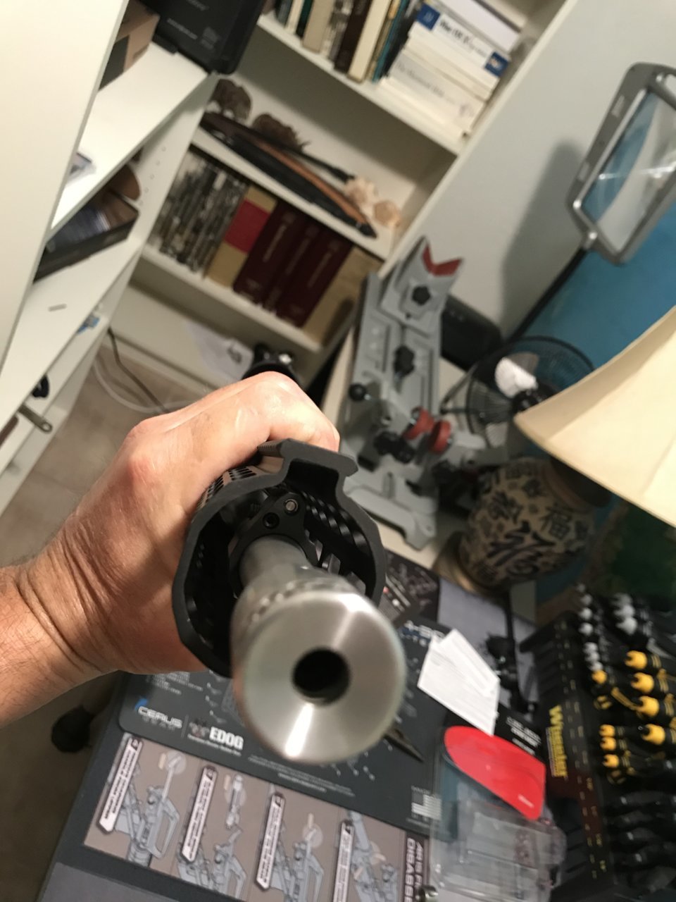

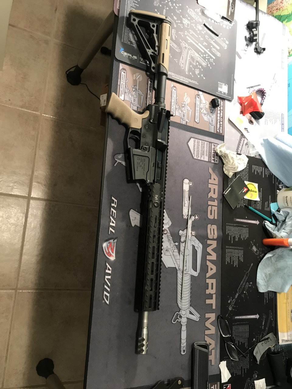

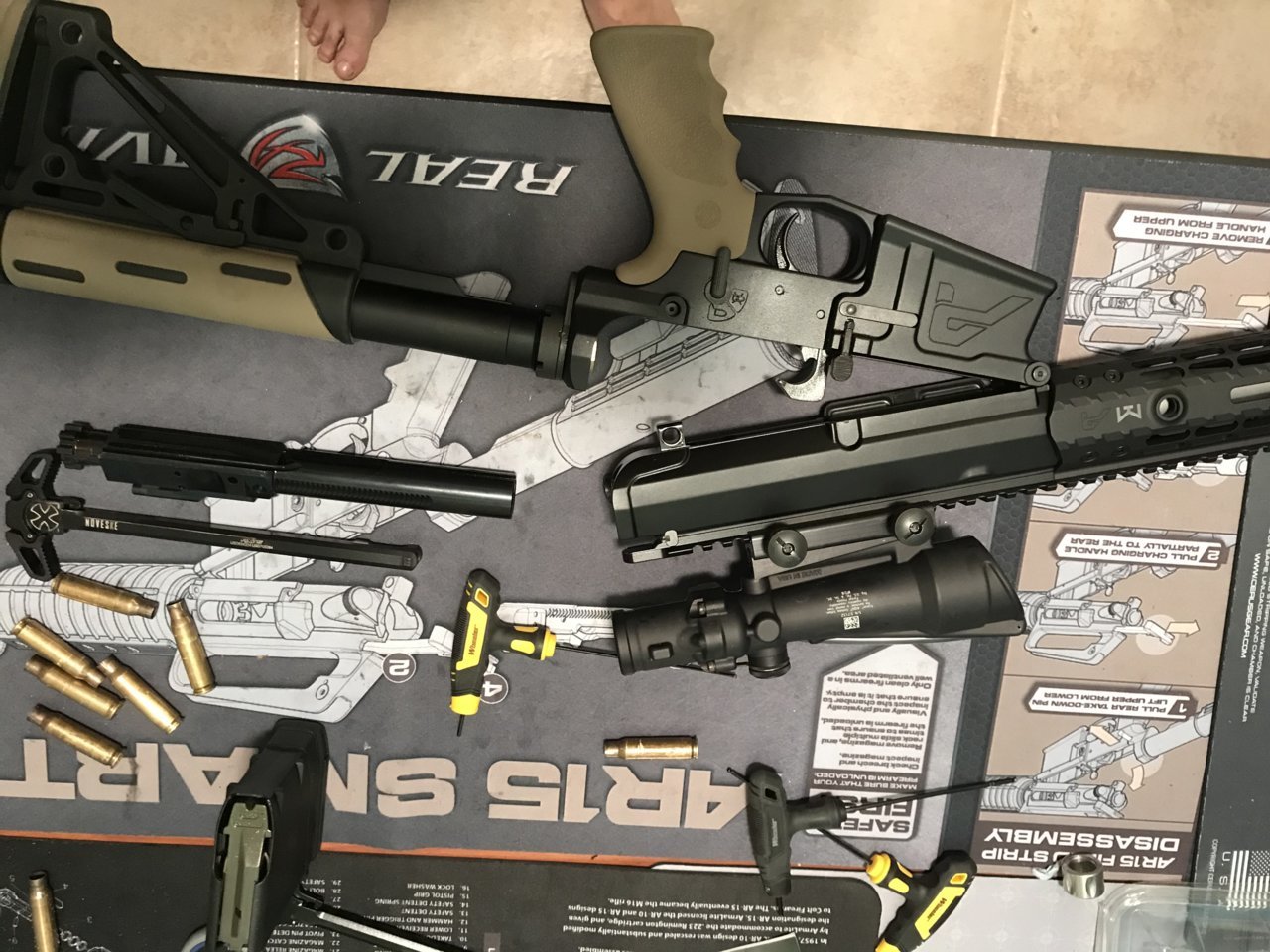

    These are the first rounds in the back yard, Seekins adjustable gas block, I'm running a Raineer BCG, the lower was built using all Aero parts.

    Gas block is in the dimple on the barrel, haven't the faintest idea how to check gas flow....

    I haven't taken the upper apart yet, everything looks OK visually, the gas block is in the same place as installed, I wasn't tighting up the gas block adjusting screw set screw every time, if that would stop the cycling....

    The gun is new, these are the first rounds shot, just tying to adjust the gas block before going to the range to zero it in. But not doing anything right now. Need to get serious with it, thought it would run fine, but no.

    Didn’t look like he had a suppressor attachment on the end of that rifle. By going with an adjustable gas block now he has issues that might not even need to exist. Rifles can run just fine suppressed and non suppressed with a fixed gas block if they are set up properly
