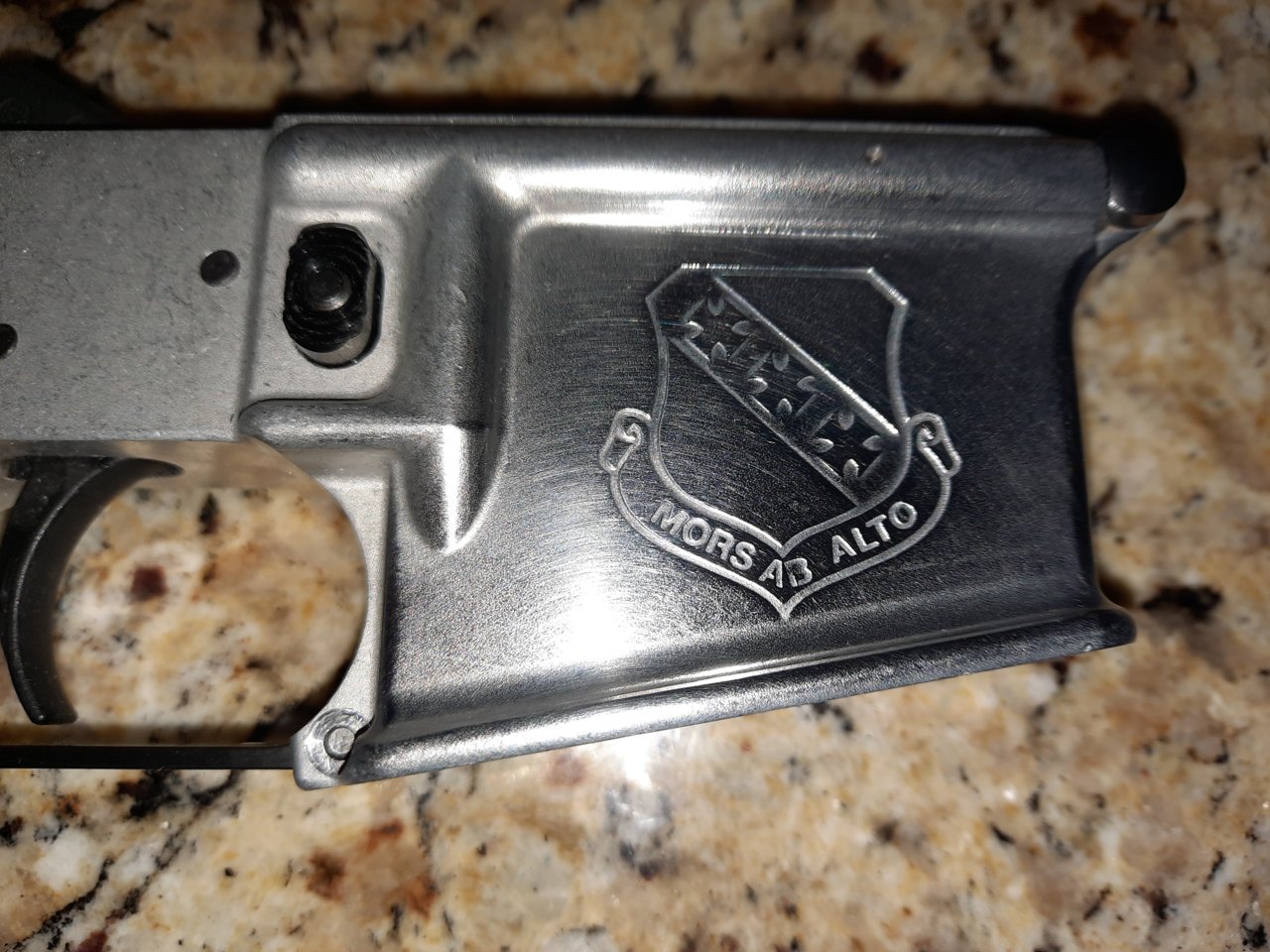

    That looks good!

    That looks real nice. If you baked it what temp did you use?

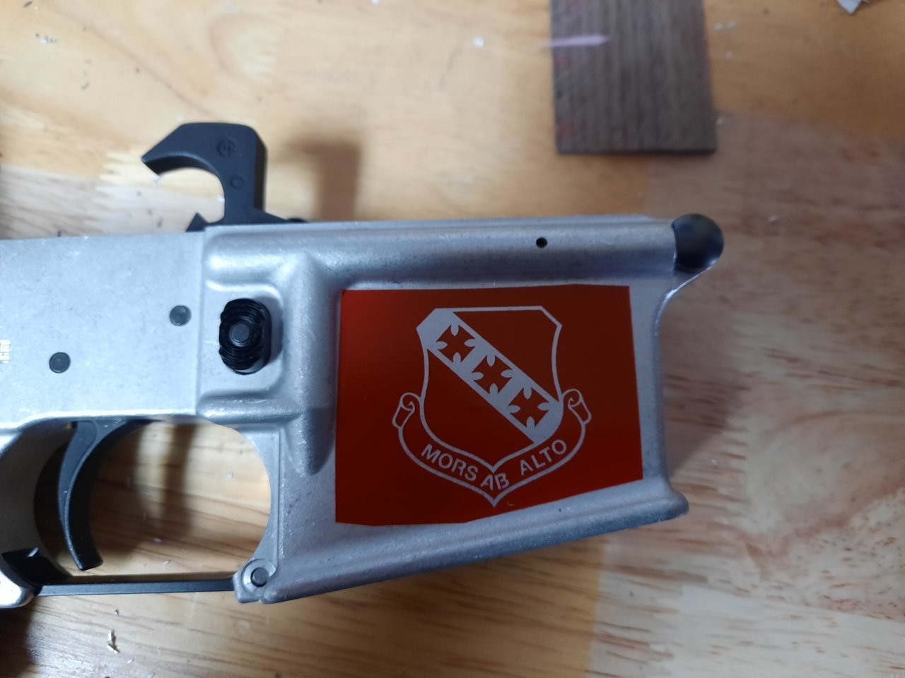

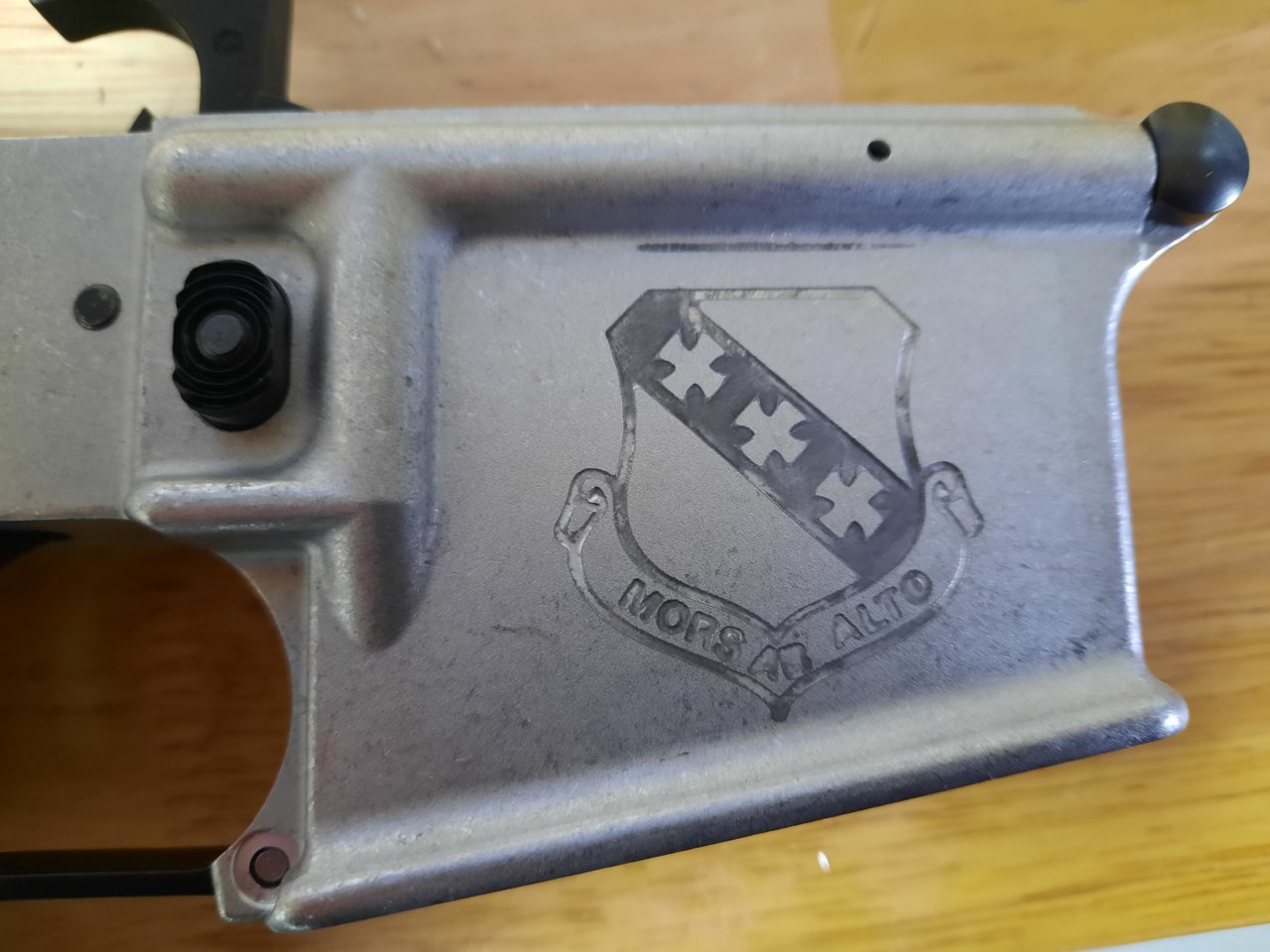

    First time etching...came out good

    I like that receiver in the white. You leaving it that way?

    Its just bare right now. Not sure what to do. I might just polish and leave it

    Please share details about voltage, liquid concentration and times required to accomplish that

    basically this. I would sand the part to be etched even if raw like this but still came out good. I used 1 part salt to 5 parts water. 2-- 9v batteries.pretty simple. About 25-30 min
    I sanded and polished after it was done
