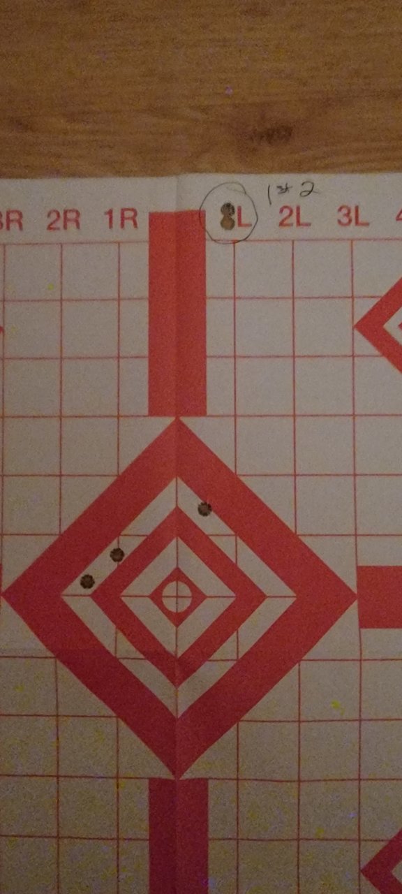

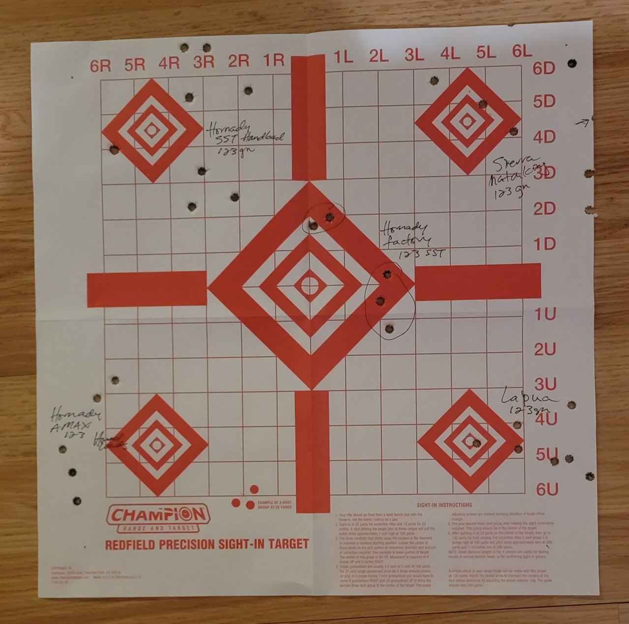

    These are the first 5 shots at 100 yds. 1 and 2 were touching. I adjusted the scope for elevation and it just fell apart.
    This was everything after using various factory and handloads.

    ok so its a purchased upper. did you do that quick check i mentioned earlier?
    if it fed those rounds & ejected them fine? then it would be unlikely that the barrel nut is loose.
    as already mentioned == if its a PSA & has a problem.... send it back to them for an exchange.
    the lower has no effect on the upper as long as you got your FCG holes drilled in the right place & the pocket on center.

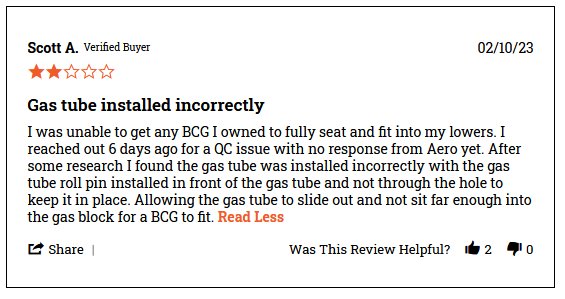

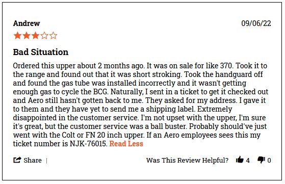

    Anyone had issues with a batch of Aero uppers short stroking?
    Got a brand new 20" A4 assembled upper (with Aero BCG and Aero A4 lower) that seems to short stroke. Ejects brass but won't feed the next round. Was thinking the gas system might have an issue based on a couple reviews on the Aero site from the same time period I bought my upper. Zero reply from Aero on a service ticket put in.
    Tried:
    -Lowers: Aero factory complete A4, Colt A4
    -Ammo: GGG M193, LC M193, PMC 55gr 223
    -Mags: Pmag Gen 2, Pmag Gen 3, Okay Ind. 20rd, Colt 20rd
    -Lube: Well lubed
    Sucks because it groups really well(via hand cycling).

    First I've seen on the m4. Hope they treat you better than they did me when my m5 complete upper barrel failed headspace with an aero bcg.

    I'm guessing Aero doesn't test fire complete uppers.

    What buffer assembly? I had the same issues with 308 with a A2 buffer assembly so contacted Ballistic Advantage who made the barrel. They said testing was done with a Carbine buffer so I switched to that now it runs flawlessly.

    The factory Aero A4 lower has the A2 buffer. Will have to swap in a carbine buffer and try it.
    Odd that they would want a carbine buffer in a rifle lower.

    I thought so as well. With an 18” barrel I figured it would all play nicely but apparently not idk if an issue with dwell time or what but runs great now
