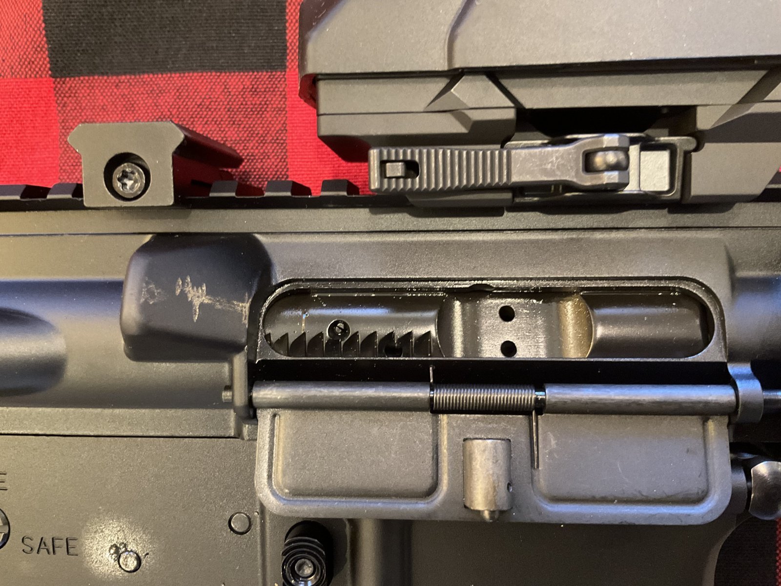

    What direction does the brass go. I'm guessing by the marks on the deflector it's over gassed sending the brass in the 1-2 o'clock position.

    My gun range is a pasture and a bitch to find brass, so I had a brass catcher on it. I’ll shoot it again this weekend without the catcher to determine where the brass is going.

    Definitely worth looking at upgrading spring to sprinco and buffer to h2 or even h3. Can just start with the heavier buffer too. Shorties can usually get away with heavier H3 buffer especially suppressed.
    More expensive option upgrade to A5 buffer system with sprinco and heavier buffers. Put this on my 13.7 build and it's crazy how soft this thing shoots.

    In general is it better to use slightly heavier buffer(H2) with stronger spring or heavier buffer(H3) with stock spring?

    Combo of Sprinco and a heavier buffer helped me out. I have a 12.5 and once I added a suppressor is was pretty over gassed. like 12:30 ejection.
    I'm interested in the A5 and a quick search says you can use any standard stock with it. Which is good for me.

    @kodiakisland set your phone to video in slow motion. It helped me diagnose a 450 bushmaster that was under gassed.

    Spring doesn't make any difference. All it will do is make whatever buffer weight you do have slam back into battery harder. It's the buffer weight that keeps the bolt closed longer when over gassed.
    I use AR-15 carriers (called them "commercial") in my 300blk guns. Don't know if they even make those anymore.
