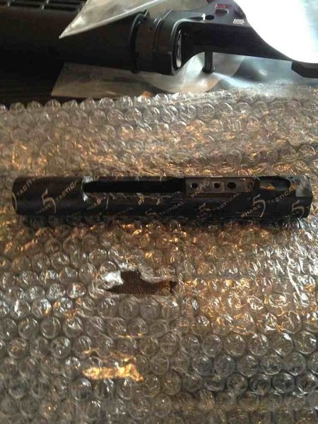

    Got my stripped carrier. Now waiting in a bolt

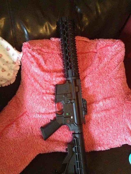

    Ok so as it sits now. Waiting on the barrel and bolt.

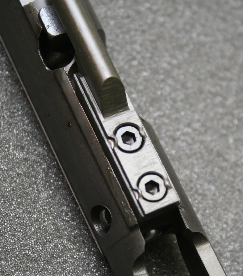

    Please please please, when you put the key on top of that, do it properly.
    • The carrier key must be made to a certain spec of hardened steel quality
    • It is hard chrome-lined per the TDP
    • It and the bolt carrier are fully degreased
    • Correct alignment of the carrier key to the gas tube is checked, ensuring no binding is present. I dry fit mine and tune the gas tube for no interference.
    • Aviation-grade Permatex Form-A-Seal compound is applied to make a high-heat capable gasket between the carrier and carrier key
    • Proper torque is CRITICAL.
    • US-Made Grade 8 fasteners are torqued to 35-40 inch pounds
    • The sides of the carrier key are compression-staked, not peened, to prevent attempted removal of the fasteners (I sometimes Rock-Sett mine instead depending on how mission critical or experimental the rifle is. Mission Critical get staked and Rock-Sett)
    • Use the proper staking tool. Doing it with a punch risks breaking the bolt head.

    and charging handle :cool:
    did you order all the little parts and pieces that go with the BCG? cam pin, retaining pin, firing pin, ect?
    make sure you stake the gas key screws.
    http://www.m4carbine.net/showthread.php?t=6993
    proper staking

    Correct. The staking is gonna be done at a local gunsmith. I don't have a staking tool and am not gonna use a punch.
    Charging handle is coming in the same shipment with the barrel but its a BCM handle. And I have all the pins and guts for the carrier. Just don't sit in there very well with out the bolt.
