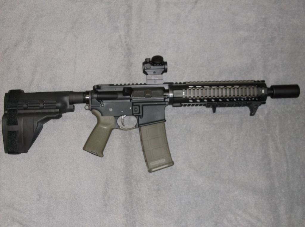

    OK so earlier in the week I was boring everyone to death about my issues with my new 10.5" pistol build. Couldn't get it to feed/eject reliably.
    Was going to take apart the gas block as many of you suggested to check for a burr in the gas port, mis-alignment, etc. So I had the BCG out and the rail off and decided to look at the bolt carrier again. For the heck of it I tried to tighten the hex bolts that secure the gas key...I was able to tighten both of them. They looked like they were staked pretty well but obviously they weren't. So I staked them myself and put everything back together. Went to the local range this morning to see if it made a difference. Gun ran beautifully. Cycled both .223 and .556 perfectly. :D
    Here she is with a new KAK muzzle device. I also just ordered a EBAL-AR15 Enhanced Battery Assist Lever from Tactical Link...very similar to a Magpul BAD lever, $18.95 shipped.
    I appreciate all the trouble-shooting advice I received from the group. :cheers:

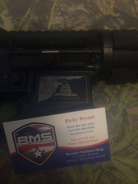

    Got my lower back from the engraver yesterday and put it back together.
    I like how it turned out, but I feel like the dust cover needs to be engraved with the caliber to look proper.
