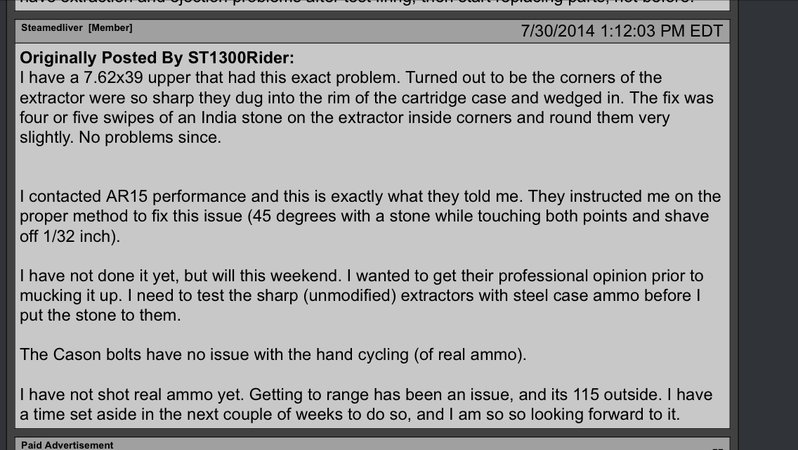

    Are you using a 762x39 specific extractor? From my research some BCG's came with 556/223 extractors and they wouldn't function properly with the 762x39 case.
    Also found this.

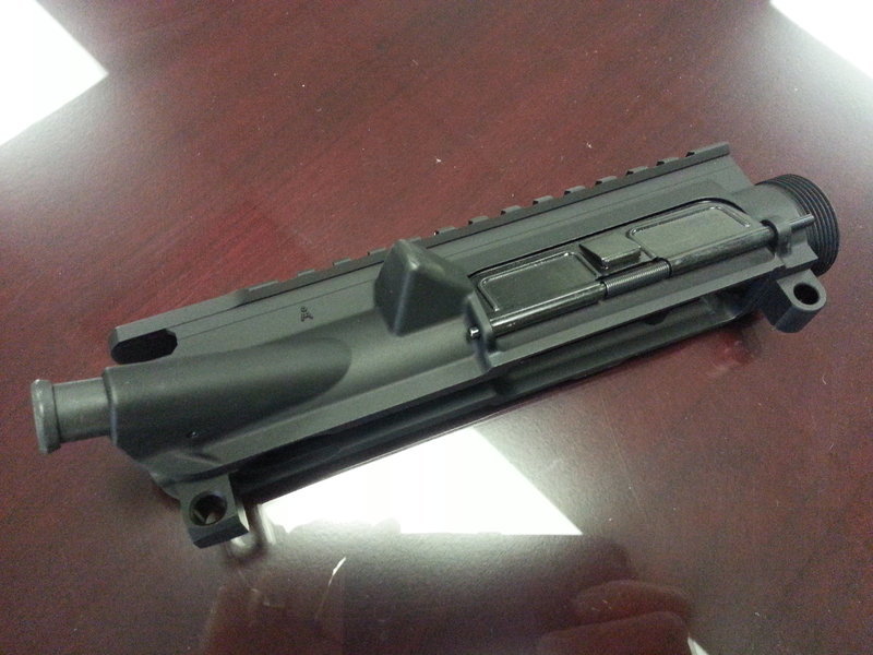

    My upper arrived today, so hope to get going on my rifle soon. :D

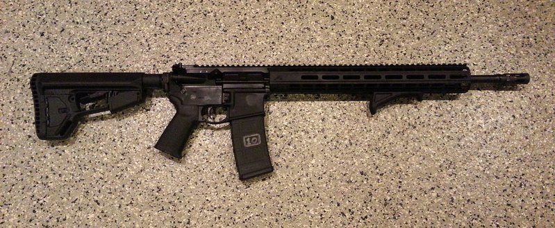

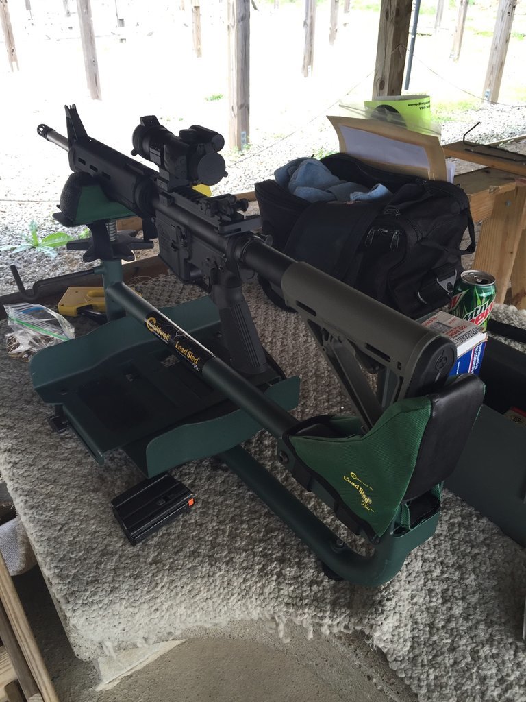

    I finally got to shoot my budget AR. It's a PSA Feedom stainless upper that I bought for $199. on Black Friday. I sighted in the irons then put my old Vortex RDS on it and sighted it in. This one I zeroed the irons and RDS at 50 yards for M855.
    I also cleaned the rest of my AR's. They were all pretty dirty.

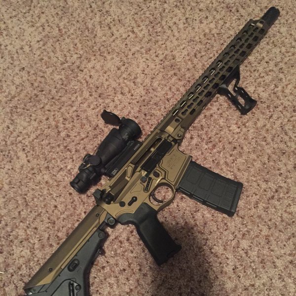

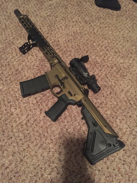

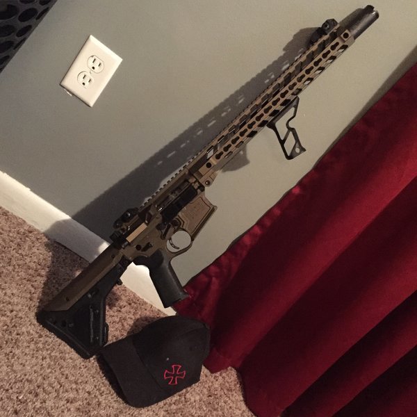

    This is the first AR I built.
    Spikes Billet Lower w/ Spikes LPK
    - Seekins mag release, bolt stop, and safety switch.
    - Timney Gold Skeletonized trigger
    - Spikes t2 buffer and milspec spring
    - Magpul UBR stock
    - Magpul k2 grip
    Spikes Billet upper
    - Spikes lightweight BCG
    - Fortis charge handle
    - fortis 556 switch rail
    - fortis grip
    - noveske chf chrome lined barrel
    - noveske gas block.
    - noveske kx5 flash suppressor
    Cerakoted burnt bronze

    That's a damn good looking rifle. How you like that stock? I've considered one, but they're awful proud of them

    I liked it a lot. it balance the rifle out very well. it's heavy, so it absorbs some recoil as well.

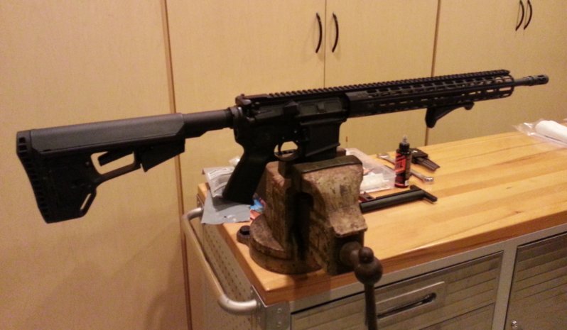

    Making progress on our first AR build, just waiting on the back-ordered Vltor A5 buffer and spring, then done!!! :D

    Nice vise. I picked one like that up about a year ago on craigslist for $125. A new vise as good as a solid old school one like the can be a few hundred bucks now, and most are made in China.

    thanks, my dad got it from the retired shop teacher from Orange High School CA, it's circa 1950... :D

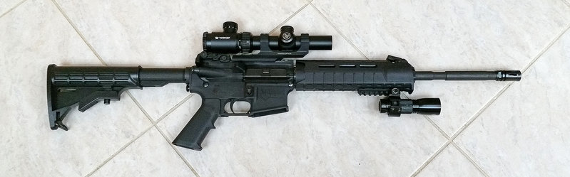

    Nothing fancy, but I picked this up a couple months ago at Turner's when it went to clearance. Couldn't pass up the price point. ATI M4. I changed out the handguard to the Magpul SL and added a Vortex Crossfire II 1-4x with some flip up backup sights.

    going to be fun!
    Is that a 10 on there for limit of 10? :(
