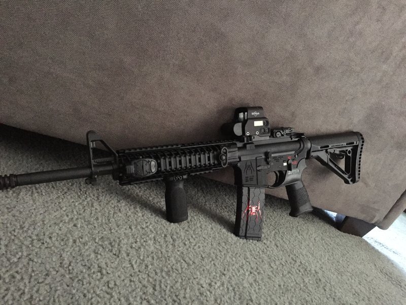

    Aero Precision lower, enhanced upper and their hand-guard that bolts directly to the upper!
    The lower shown is not theirs, but an 80% I did. If I was going to purchase a complete lower, this is the one I would get.

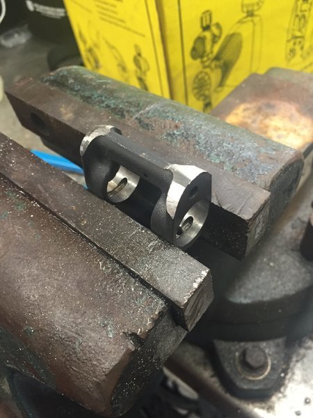

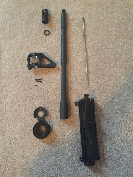

    My latest build is a 14.5" barreled Colt LE6920CK. I bought the BNIB complete upper for $250 from Armslist. I happened to have Armslist open when it popped up and I jumped on it. I hadn't plan to build another, but I couldn't pass it up.
    So far I have bought an ALG EMR upper, a 1.5" BCM Mod1 comp ( to make it legal ), Magpul PRO BUIS and an Aero buffer kit.
    I already had the lower and LPK.
    So far I have stripped the barrel and chopped and ground the A2 front sight post/gas block. So now what I have left to do is install the barrel nut from the EMR, cold blue and reinstall the chopped gas block and gas tube (which I'll do tomorrow at work),assemble the lower and drop it off to have the comp pinned and welded.
