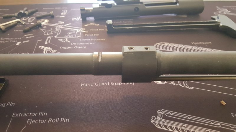

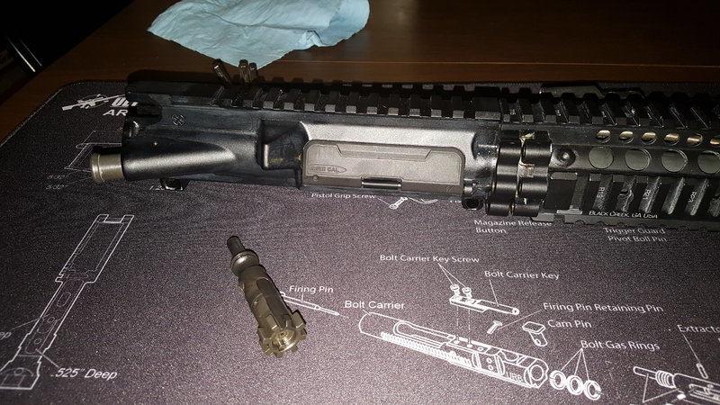

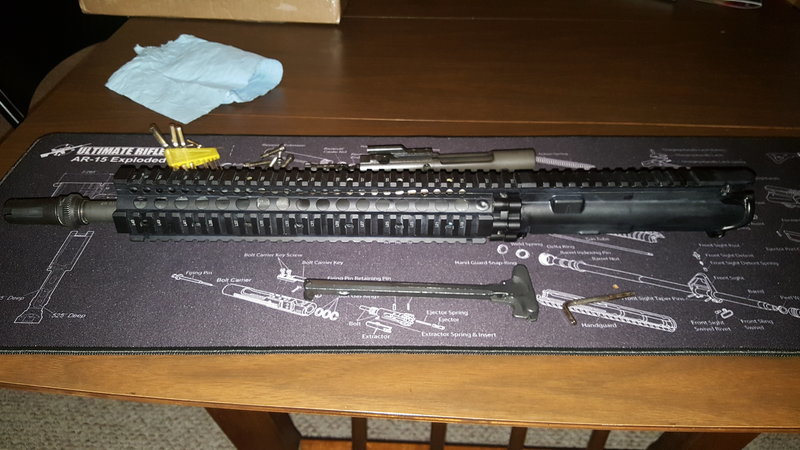

    So i picked up this upper from a Calguns member. He says there were about 200 rounds put through it, but in taking it apart, aside from being very dirty, I found a lot of wear on the charging handle, plus several other spots such as the forward assist and some spots on the hand guard. It looked like there was more around 2000 rounds rather than 200 fired. The guy said it was a Noveske BCG, but I found its stock mil-spec. It was an amazing deal, but im starting to have regrets over it now.

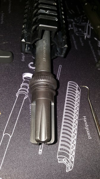

    Whats on here is a Noveske Gen 1 upper, stock BCG and charging handle, Strike Industries dust cover, a Daniels Defense RIS (i think), Noveske 14.5" barrel (Afghan?), Noveske gas block, AAC flash hider.
    It appears there was drill holes from having a front sight block pinned. This was not done by Noveske, they would have pinned the new low-pro gas block.
    I will add that i am very OCD and what was done to the barrel is really bothering me.
    Questions:

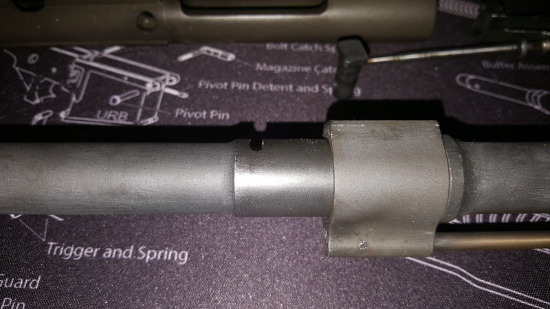

    That drill-though in the barrel, is it of any concern to the integrity of the barrel? Can or should i do anything to repair that notch? Weld a pin in?
    Should i have the gas block pinned as well? Would it be possible to get the hole in a spot so that the existing notch in the barrel can be used?
    2017-04-18 16.21.20.jpg 2017-04-19 03.17.02.jpg 2017-04-19 03.19.53.jpg 2017-04-19 03.25.17.jpg

    The drilled slot is not a concern. Your gas block should be moved slightly forward though. With it set tight against the shoulder like that it is most likely partially covering the port in the barrel.

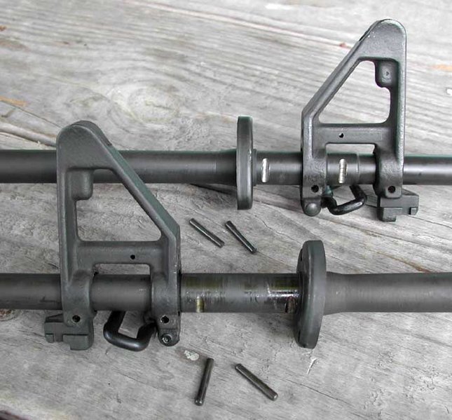

    There is absolutely nothing wrong with that barrel. That is the standard drilling for when you pin a gas block. Chances are good there is a second drill through the barrel under the current gas block.

    That's no Noveske. That's a barrel that looks like it had a regular A post front sight on it, had it removed and a low pro put on it. Noveske barrels with low pro gas block has the gas block pinned and set screwed to insure alignment. Does the barrel say Noveske? All Noveske barrels have the logo at a minimum. That looks like a parts build upper.

    Correct, its not a factory build, but it is a Noveske barrel, gas block, and upper. The rest is DD or milspec. Like you said it was not pinned as it would have been from the factory. I sent Noveske an email to see what they say.

    Yes i would not be so concerned if it was a small notch as in the pic of the FSB you posted above. What bothers me is that if you notice the hole was drilled excessively low, below the outer edge of the barrel on the non raised portion. I know its mostly cosmetic, but it really bothers me that its now the weakest/thinnest point of the barrel.

    @Caligula The drilled part of the barrel shouldn't be a concern. I swapped my standard factory gas block to fit a low profile bock and smaller full length keymod rail to replace a bulky drop in quad rail and have the same thing. This is from a factory upper that originally had a pinned gas block. The new low profile gas block might be dimpled in place so moving it would be a chore (also unnecessary if it was assembled correctly). Also think about it this way, the barrel was drilled most likely from the factory and the only thing different is that the pin was removed. You're not losing any barrel integrity. One concern I'd have in welding in a new pin just for aesthetics is possibly warping the barrel from the heat if not done properly. My $.02 is to leave it be as long as it functions properly.

    It's not a problem being thinner there. Assuming that's a standard .750" gas block journal there is still a little over 1/4" of steel between the bore and the outside of the barrel. The pressure in the barrel is low at that point and not a concern. There are plenty of barrels with .625" barrels and gas block journals out there that haven't had problems.

    It won't effect anything, put a long ass rail on it and you will forget its even there.
