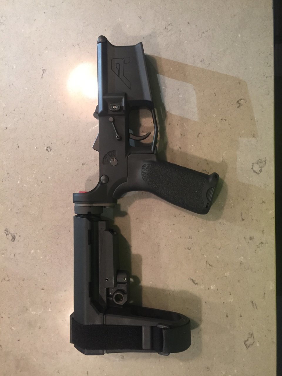

    Built my first lower last night. Took about 2 hours watching videos and only managed to launch the buffer detent across my kitchen.
    AERO m4e1 lower
    AERO lpk
    Rise armament ra-140
    Kns anti rotation pins
    BCM mod 3 grip
    BCM qd end plate
    KVP 4.3oz buffer
    Jp enterprises spring
    SBA3 tactical brace.

    Nice! I had one of there lowers also. sold it looking basically like yours there but a different buttstock for $250

    For the price point, aero makes some great stuff. Went together pretty nicely, only thing I might switch out is a ambi safety since I'm a lefty.
