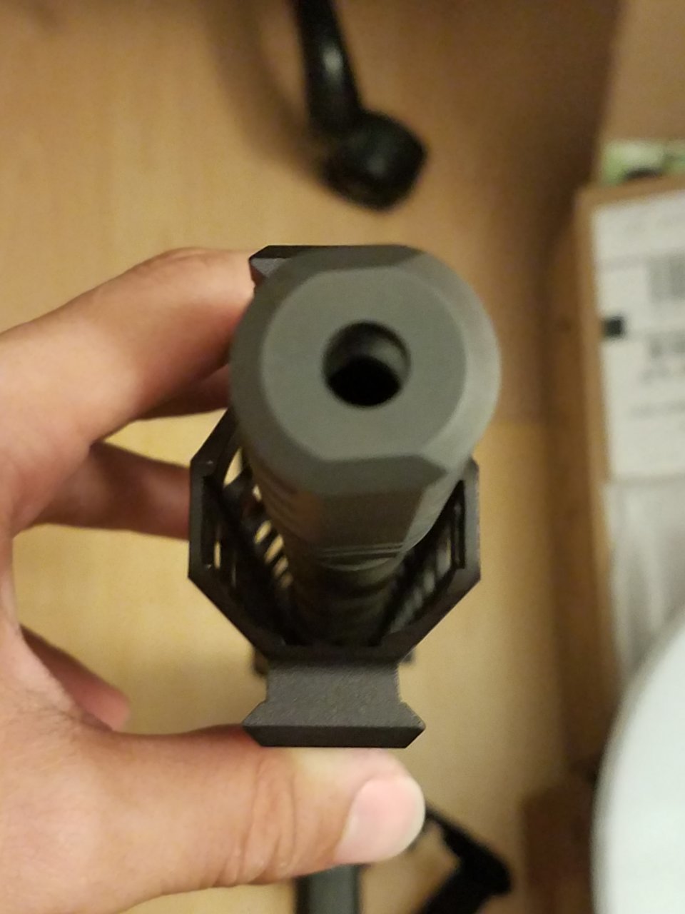

    any of yall had to deal with an upper that was wonky and made all rails put on it misaligned with the barrel?
    Cause....i thought my rail was fucked so i threw on a BCM MCMR on my aero upper...both are crooked in the same way, so i'm assuming it's actually the upper

    two different rails, both are offcenter at the end, leaning towards the left. thought it was a barrel nut mating issue with the first, but it's the same with this new rail...
    top is the new bcm mcmr, bottom is the old stngr hwk

    Wow! That is severely off. I don’t think I’ve ever seen that. Can’t imagine the bcm is out of spec, or the aero upper really, but I would start by trying a different upper receiver.
    How does the mating surface between the upper and rail look?

    The hwk was completely flat and aligned as far as I could tell. The bcm seems to be ever so slightly off

    This is what I would do. Loosen the mounting screws on the bcm rail, and gently tap the muzzle end with a soft hammer/mallet see if you can seat it better, my bcm rail is touching/flush with my upper
    Edit:
    I re read your post about 2 diff handgaurds, sounds like an upper issue.
    Second edit, cuz I’m drinking. You didn’t bend the barrel did you lol

    lol no. I'm still getting good groups from the barrel, so it has to be the mating surfaces with the rail

    Did you check where the barrel mates to the upper?
    If you have calipers you could check to ensure the barrel extension and the collar are square. The machining of the barrel could be screwed up and the collar that the barrel nut Torques against the upper could be cut out of square therefore making the barrel off center but still accurate.
    Another way to check (possibly easier) is to see if you have horizontal change of zero from 25 to 150 yards.

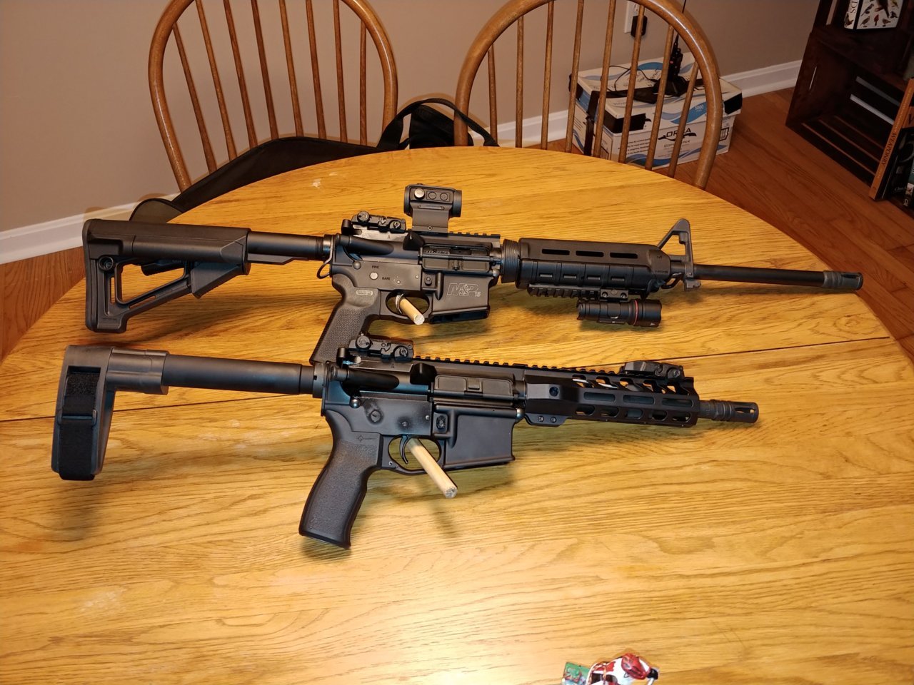

    So crunching some #s it looks like im right about $370 in parts for the pistol. Not bad since most parts were not really deals or sale just what was available when I needed that part.
    And here's the .300 pistol next to my 5.56 carbine
    This was my first build, so it was really fun being able to start with the parts I wanted, instead of swapping things out.
