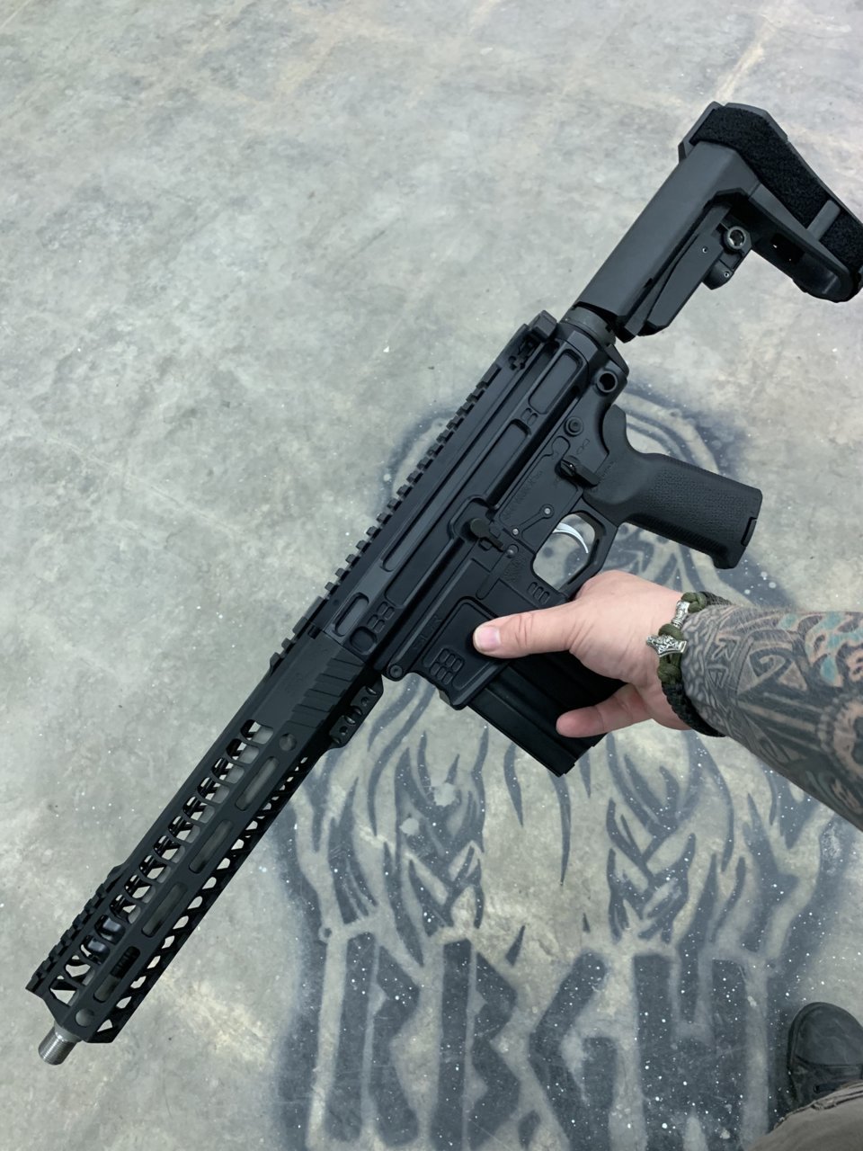

    Built a new blaster tonite
    Spikes Lower
    Aero upper
    Ballistic Advantage 300blk 8.3" barrel
    Aero Nickel Boron BCG
    Waiting on my Larue trigger

    Time for the TW collective mind to help me diagnose a problem
    Spikes Lower
    Aero Upper
    8.3" barrel
    Pistol length gas
    Standard weight buffer
    Aero nickel boron BCG
    Brownells LPK
    Larue Trigger
    Surefire brake
    SBA3 brace
    Will not cycle 200gr 300blk subs...it fires and the bolt ejects the spent shell but does not chamber another round
    Will cycle supers reliably but will not lock open on last round and empty mag
    My initial thought is there's not enough power to fully push the BCG back to cycle a subsequent round with the subs. I was considering removing some of the weight in the buffer
    Would a light spring or buffer likely be the solution?
