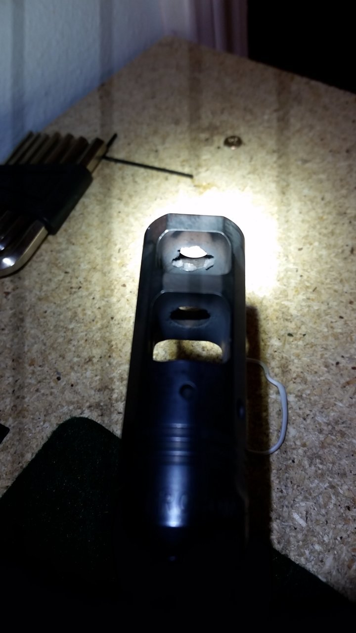

    I’ve had muzzle wear on my flashhider from running the suppressor.. never had issues with in suppressed though. Many factors can cause this. Did you use a crush washer? Slight chance the flash hider isn’t 100% true to the bore. I use shims to avoid this. It’s a bigger issue on suppressors because of baffle strikes

    Maybe 3,000 rounds so far in 2 years. This gun is exactly how FN made it so I didn't have control of the crush washer. 55 grain Hornady Frontier fmj ammo in a 1/7 twist.

    Hmm. Interesting. Honestly I wouldn’t worry too much. It’s still perfectly functional.

    My concern is the possibility of it causing a bullet to take of in an unintended direction or causing the brake to break apart and hurt someone next to me.
    I emailed surefire (the manufacturer of the brake) and still waiting to see what they say.

    While technically possible. I’ve never seen or heard of that happening. Unless of course it came loose, but you checked that.
    FN in my experiences with them have been pretty good to deal with, good chance they’ll send you a new one.
    Another option is throw an a2 flash hider on there and never worry about it again.

    There are a few post on ar15 . com about that ammo causing issues. The general consensus is avoid it.

    Looks like a lot of powder scouring, that can happen with some crap ammo that burns slow or short barrel.

    I see definite divots in that metal that look like off-kilter bullet strikes. You'd figure powder scouring would be a bit more uniform.

    One would feel a hit.
    That's not soft or thin metal like a baffle in a can.
    I have the short Daniel defense break on my gun, I know the barrel is shot out and I'm not getting mark's like that.

    The brake is jacked now, while its not broke its dinged up...bullets are tumbling, its going to cause you or someone else harm. Id take it off before shooting again

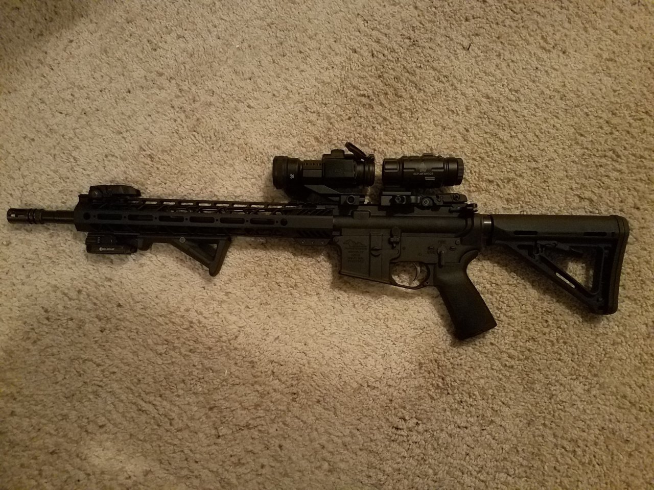

    Decided to throw all my farkles on at once, results in a pretty heavy rifle. 8lbs 9oz as shown.
