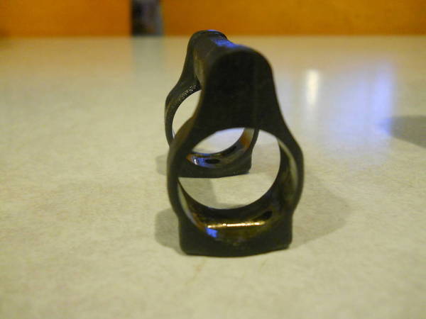

    is it possible to get a 10.5 barrel, low profile gas block, and put a longer handguard than a carbine length so that the rail covers the gas block and goes to almost the end of the barrel?

    Yes, people do it all the time. Anything you see listed as "low profile" should fit under most free-float rails. You can even chop an A2 front sight base and make a low pro gas block pretty easily if you have one laying around and your barrel has taper pin holes.
