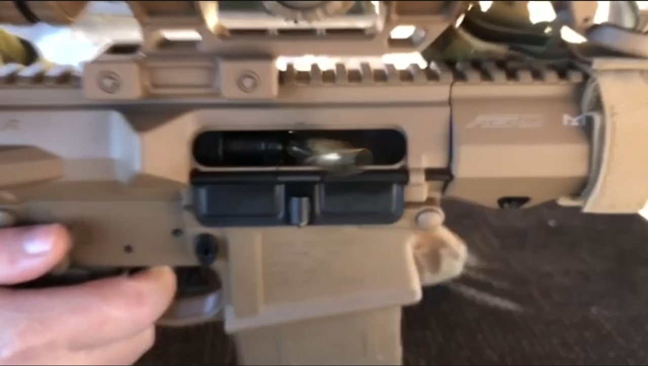

    Alright so conundrum for everyone.
    Took the aero Ar10 .308 out again today to test functionality after the extractor fix. Hit or miss results
    One brand of ammo it just doesn't like so leaving that out
    Tested the following
    PMC 147 gr brass
    Ammo inc 150 gr brass
    S&B 168 gr bthp
    Federal GMM 168 and 175 smk
    With the exception of the pmc and s&b loads the gun would short stroke where the bolt does not get all the way to the rear. Can't figure it out
    Thoughts are run about 100 more rounds through it to shoot the new out of it. Or start chasing problems and replacing parts like go to adjustable gas block and new gas lines
    Screen shot of short stroke

    I had a 450 bushmaster upper on an AR-15 that wouldn’t cycle, drilled out the gas port on the barrel and it ran fine after that. It didn’t need much, maybe 1/32”, used whatever drill bit I had that was the next size up of the gas port.

    I have a feeling ill ultimately go to adjustable gas block because suppressor. Emailed the video to aero to see what they say. I'm just surprised it would be under gassed

    Was it short stroking with the supressor?

    I'm wondering if more shots will "break it in' more. Yes it sounds undergassed I wonder what it would do right now with a suppressor? I'm deffinately curious as I am essentially building the same rifle

    Funny is I expected to run into gas issues when I got the can just not on a new un suppressed rifle. I'm curious to see what they say. If they have me send it back I may see if I can swap it for the adjustable gas block. I've got about 100 rounds through it now.
    That ammo inc 150gr is awful running about 5 moa so I might just go blow the last 80 rds of it to see if it clears it out more and shoot the new out of the rifle
