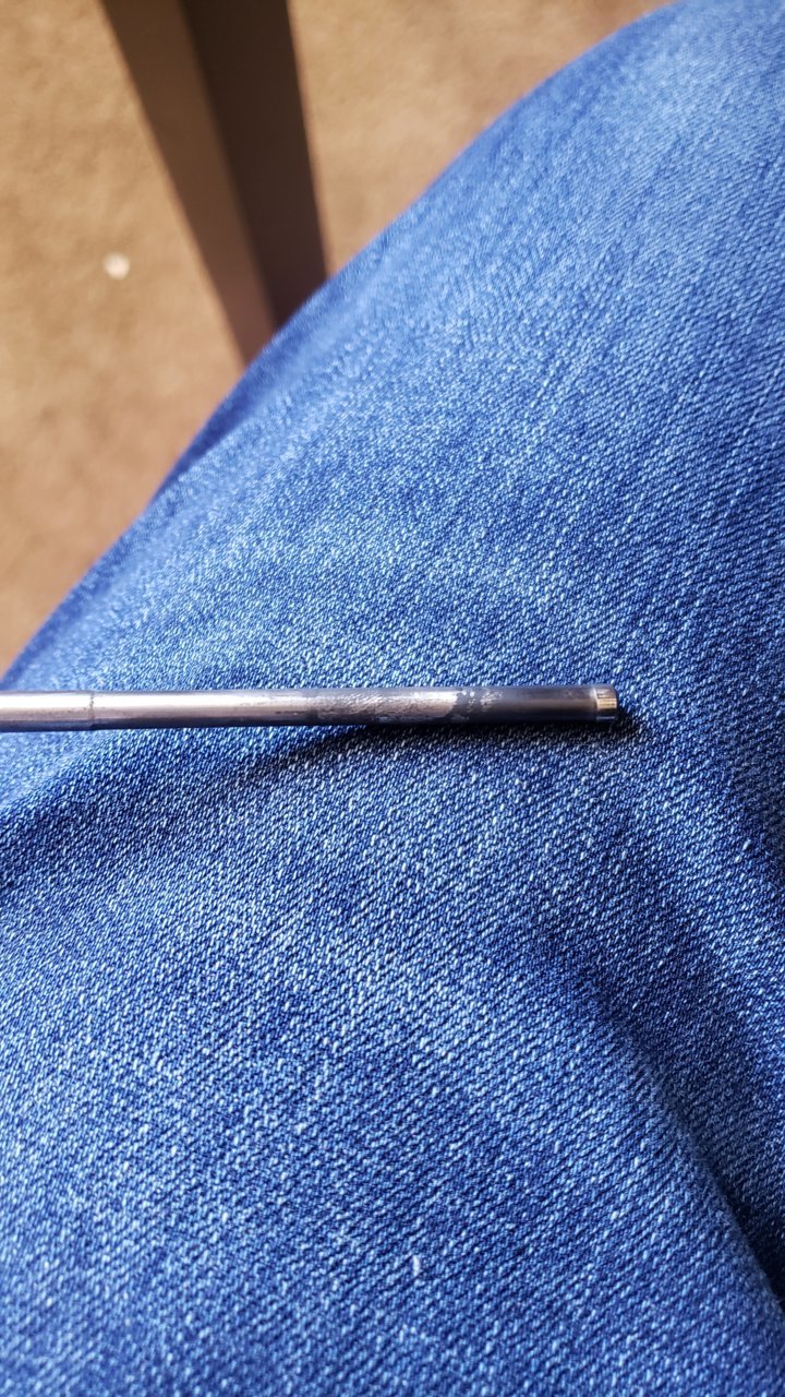

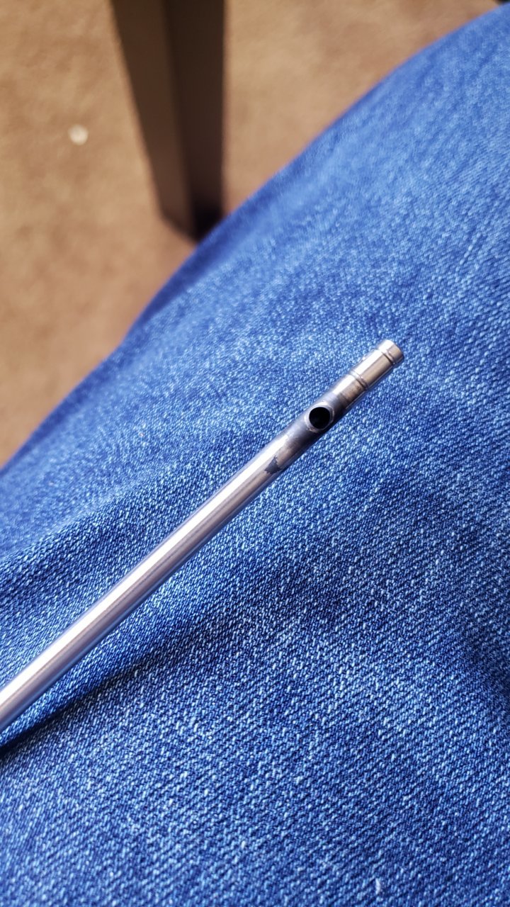

    Brass looked fine consistent center punch primer strikes of consistent depth. No markings on the brass itself
    Taking the gas system apart right now.
    After cleaning
    Muzzle side
    Chamber side
    Other than some decent carbon fouling for low round count no obstructions everything seemed to be in order maybe 1-2 degrees from perfectly straight. I'll re install and try and see if it helps.

    Overgassed often looks like short stroke because the BCG is pulling on case before pressure drops on chamber. If you already removed extractor orings, you won't see claw marks any more.

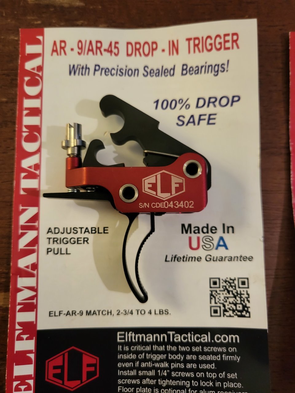

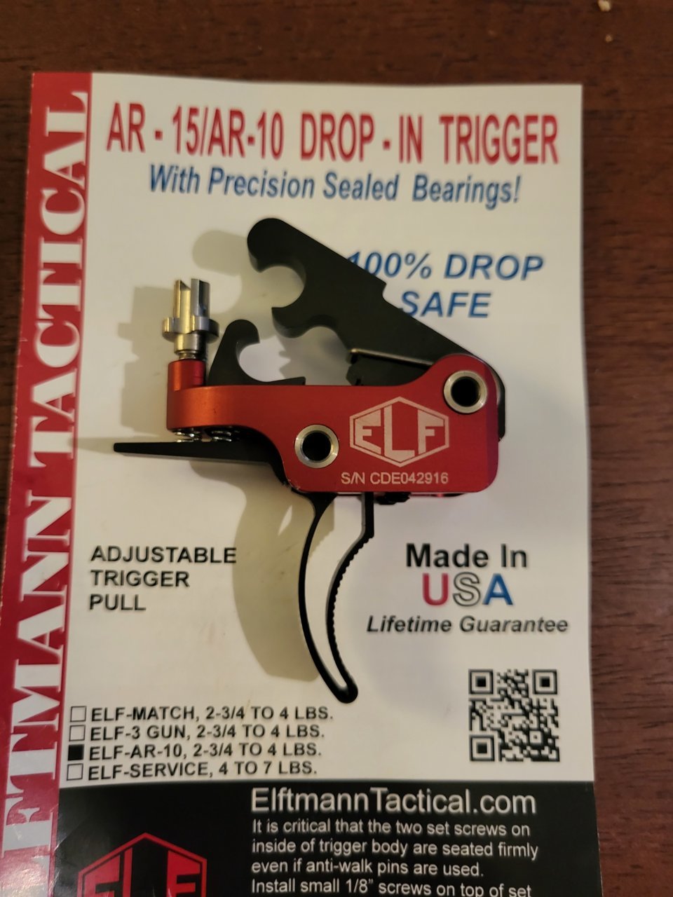

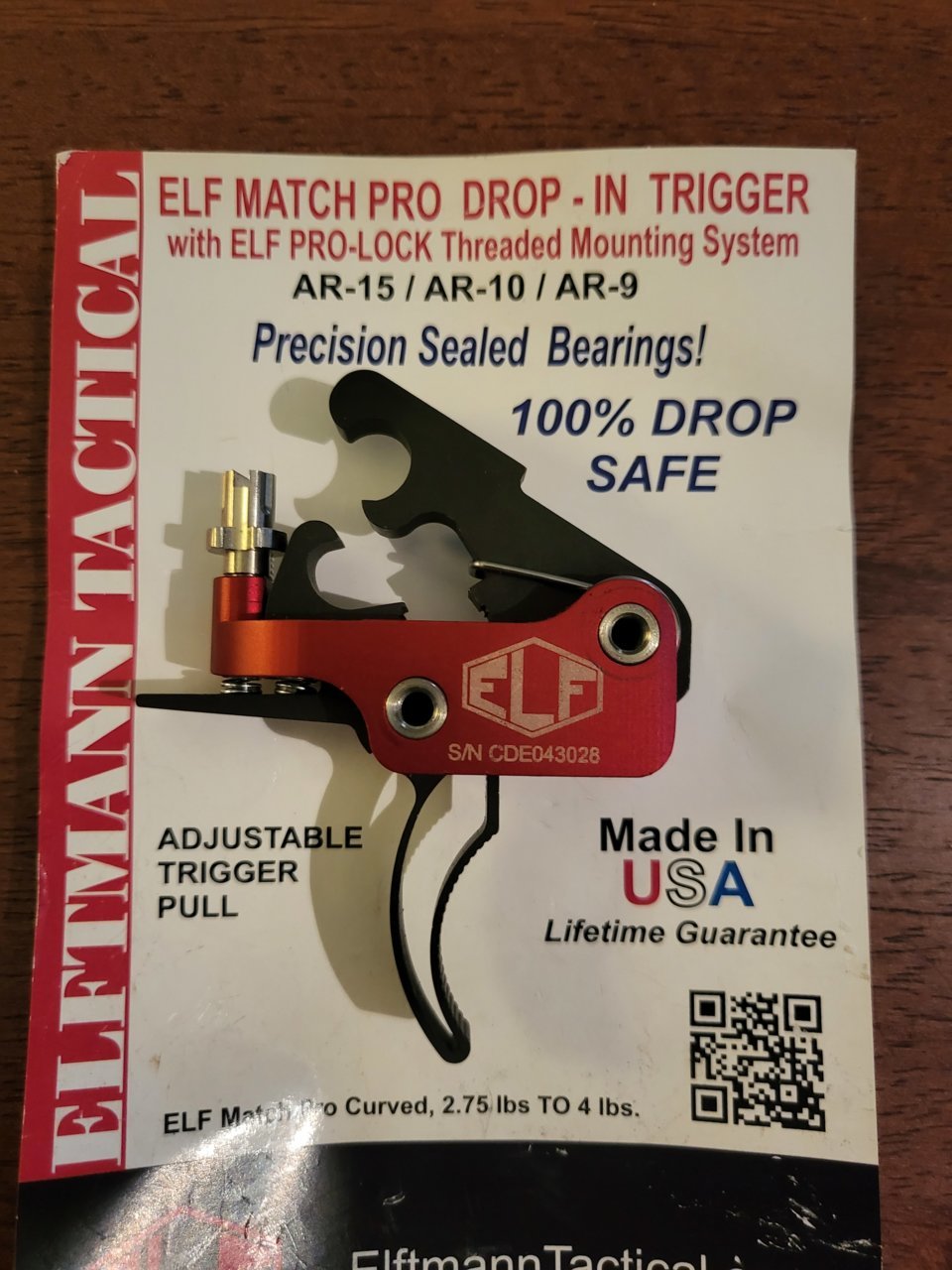

    For those wondering. Here's an Elftmann Pro Match, AR15/10, and AR9. Elftmann stats that the Pro Match triggers will work for all platforms. The only difference I can see is the threaded inserts of the Pro Match. The AR15/10 and AR9 seem identical.

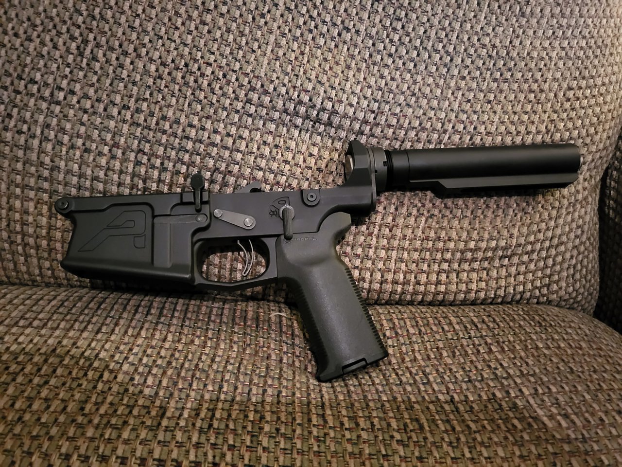

    Got my lower put together, now to wait for the upper and decide what stock to go with. Also need to get an Elftmann safety
    svermilyea, TomTwo and wilcam47 like this.

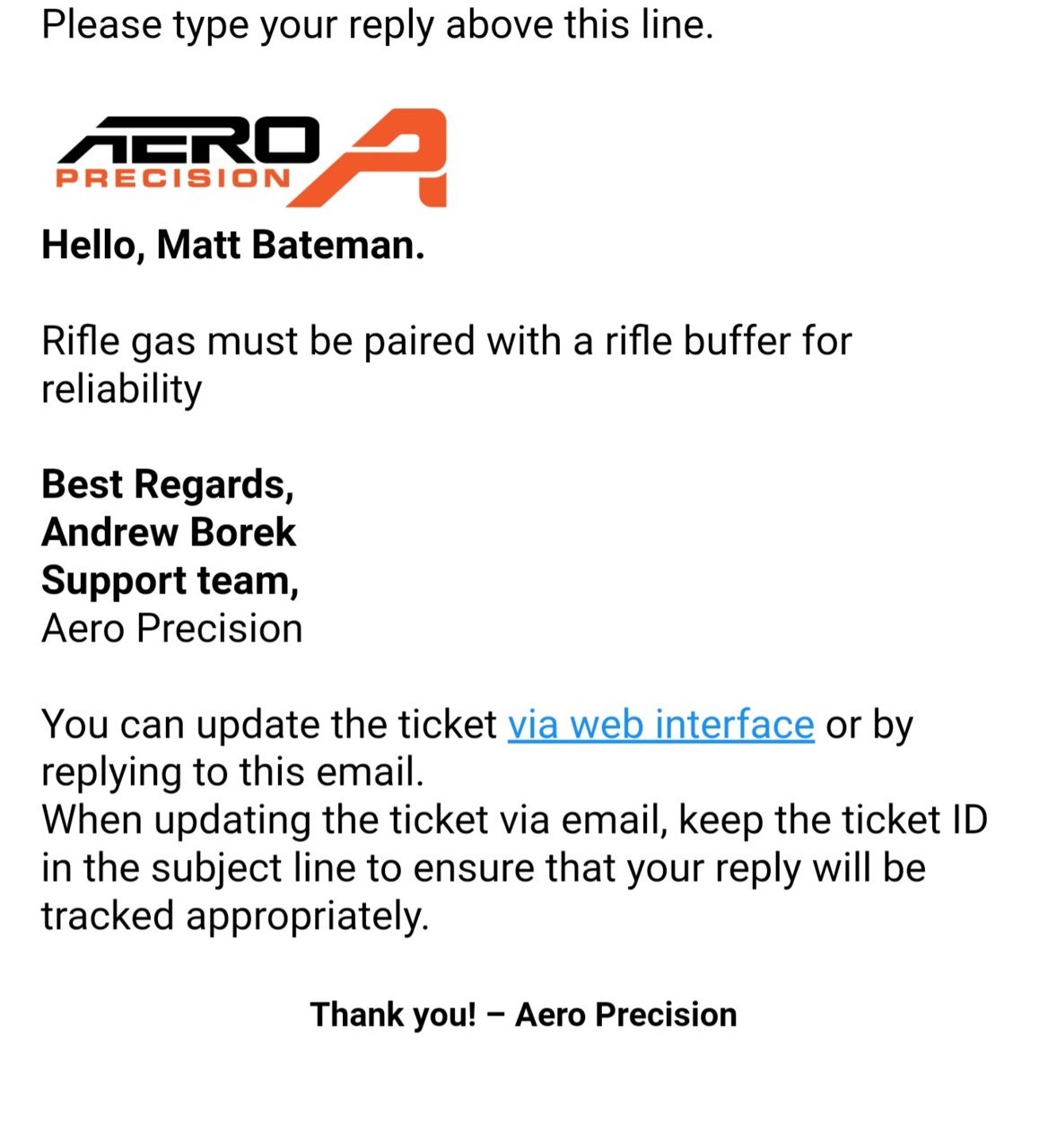

    Well kinda disappointed with Aero's reply. Seems like they just took the easy way out. Guess I'm on my own to fix it. Adjustable Gas block should be here this weekend.
    gixxerphil[OP] likes this.

    That is a bit disappointing.

    I don’t get it. They aren’t wrong. If you have the appropriate gas system, adjustable or fixed, and you are looking to tune your rifle for reliability, then you need the appropriate buffer to give the rifle the appropriate dwell time.
    I apologize, I didn’t really see the original problem up above in the thread, so I might be misspeaking on your specific problem, but over the years most of these problems I see people have are all about the same, so I’m generalizing in the trouble shoot.
    If you’re buffer, gas tube are all for sure working components for a particular set up…then the issue is your gas hole in the barrel is incorrect. While a adjustable gas block CAN fix your issue in these scenarios it doesn’t address the actual problem. It’s just duct tape and 550 cord.
