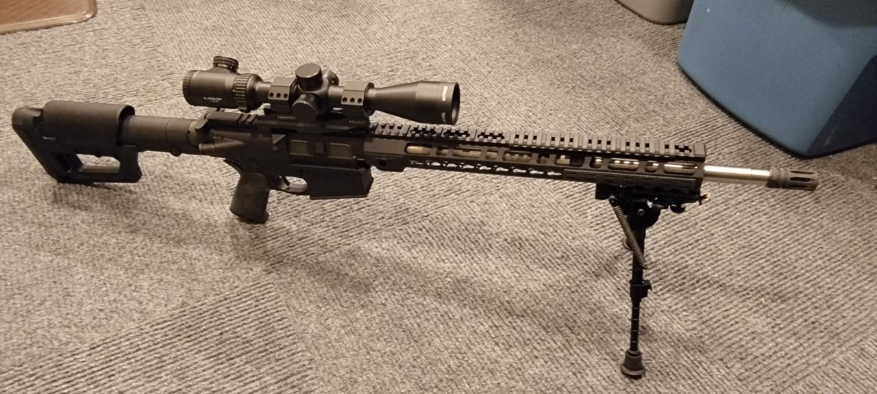

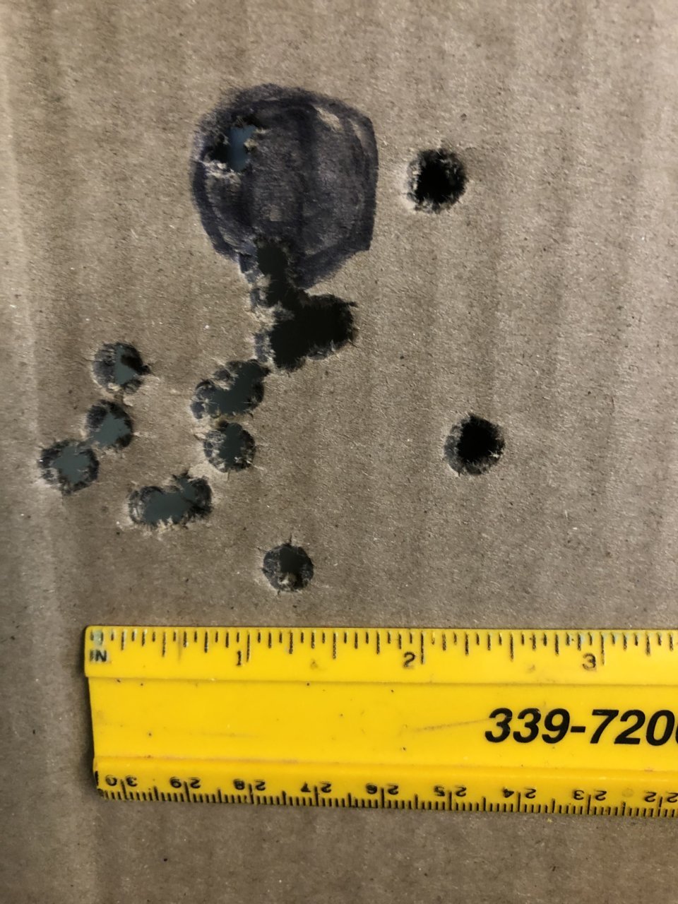

    OK so kinda a mini range report LOL. The first time I took the rifle out I shot a box of 308 147 grain fmj's through it as basically a function test and everything worked flawlessly.
    Today I took it out to start zeroing the optic I only had 50 yards available to me today but I wanted to shoot and figured I could at least get it on paper so I had a head start when I get to go to the further range. I used a box of Winchester white box 7.62x51 fmj and accuracy wise it shot very well albeit only at 50 yards. It started a little low, about 2" and I just walked it up from there accurcy was better than expected with the ammo being used.
    Issues: It started with some failures to hold the bolt open on the final shot, I had a couple of failures to feed, and a couple of partial feeds which jammed. @OnePuttBlunder IDK if these are like some of the issues you were having. Mostly it ran ok but too many issues to be happy with. From my understanding, 308 is a little higher pressure round than the 7.62 and I am wondering if it just needs the little bt of extra pressure to run correctly. I have heard these rifles can be finicky I guess my first step should be to try some 308 and see if the issue is resolved if so that is fine. I'd like to be able to run the cheaper ammo for fun but not if it doesn't work correctly.
    Rifle is rifle length gas system and full A2 buffer assembly.
    All 20 rouds
    About the last 7 or so were all in the ragged hole at the bottom of the dot. I was only using the bipod and Lord knows I'm not God's gift to the rifle

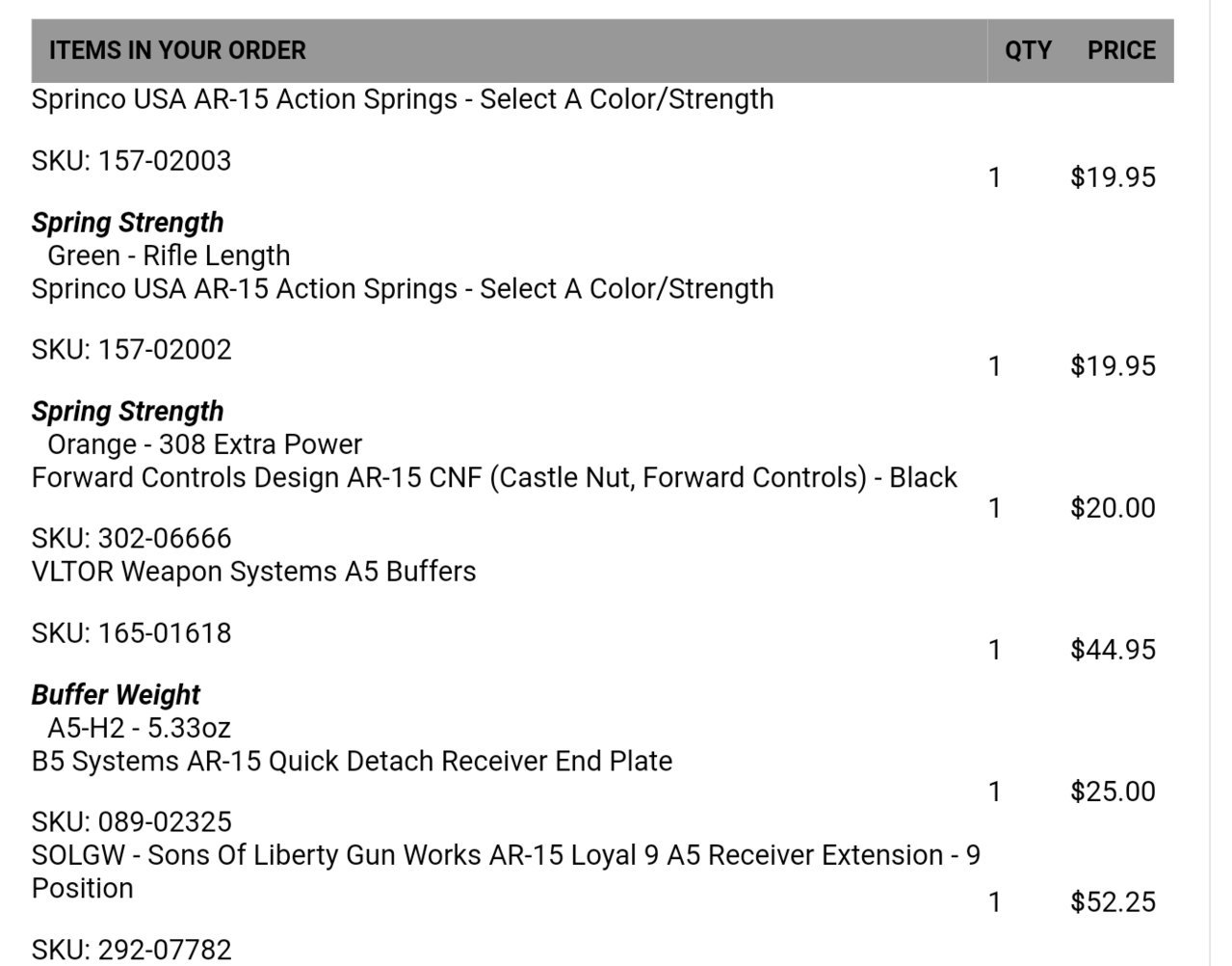

    Speaking of buffer systems as I was looking everything up last night and decided to order the sprinco orange I figured why not build out the SOLGW buffer set up too :spending::facepalm:

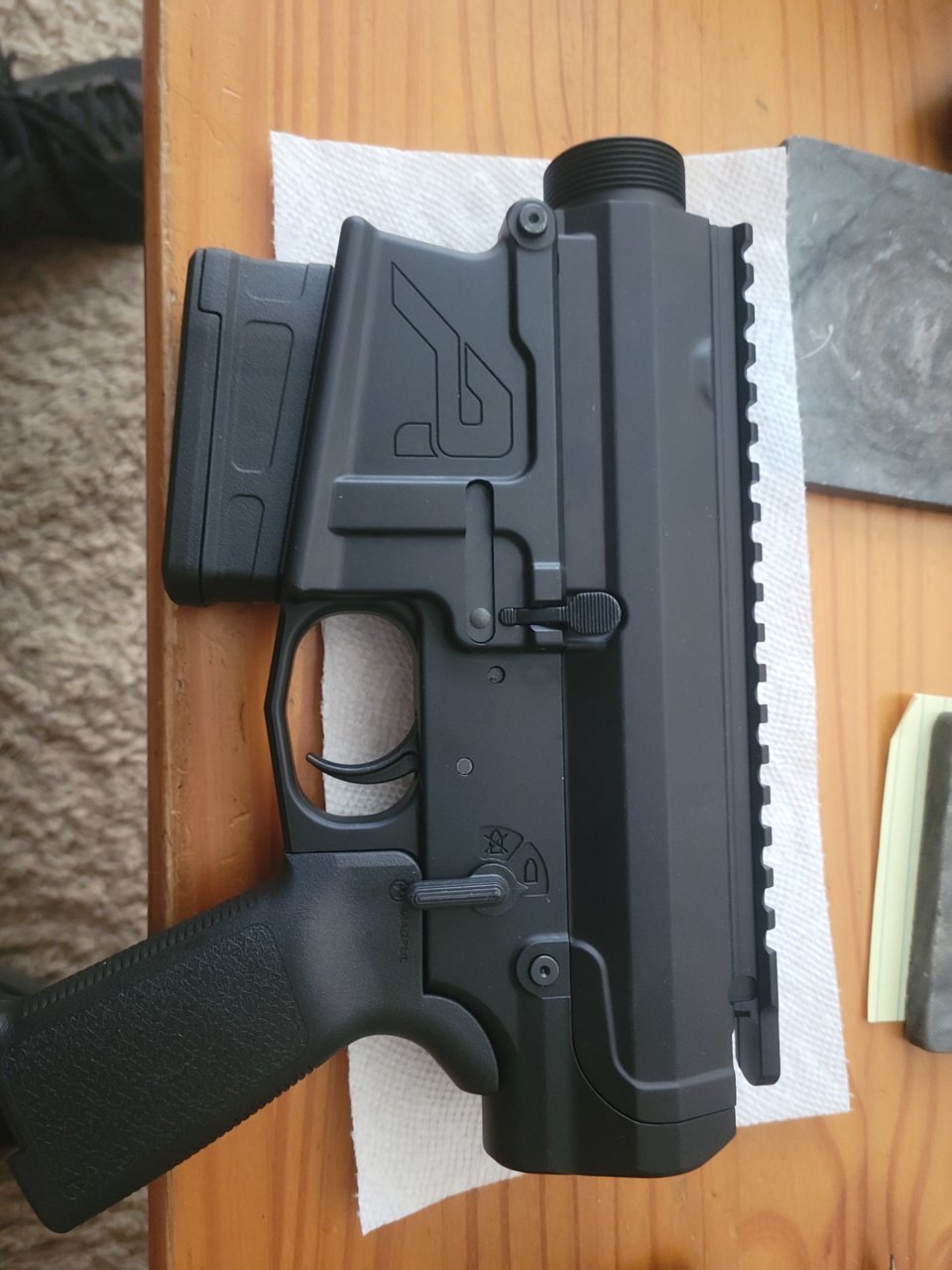

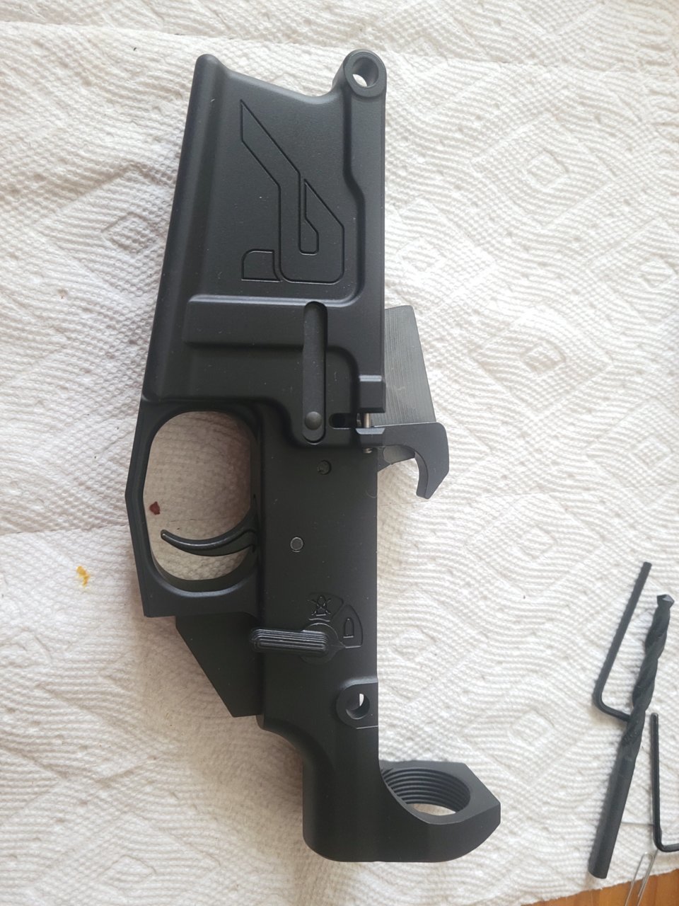

    My fully completed upper came in today so I thought it was a good time to get assembling the lower. I got the mag release button on....not too hard. Trigger and hammer group are now in....a little harder. I do not have a small enough Allen key to put the slide release in...darn it.
    Where I decided it was time for me to stop was the detent for the front pivot pin. The detent fell out many times, but it is magnetic so I was able to find it with a strong magnet. I have decided to hang up the project for now as I do not want to throw this out my window!20220418_142629.jpg

    The front pivot pin was the easier of the 2 for me, it’s different than the M4. Find a punch that’s close to the same size as the pivot pin, slide it through from the left side just shy of the hole for the stent and spring, depress the detent wit a tiny screwdriver or something then slide the punch over it to hold it in place, then carefully push the punch out with the pivot pin and the detent should pop into place.
    Now I was 3 hours and 3 springs on the rear until I figured out, confirmed by Aero, you have to trim a few coils off the spring to shorten it enough to get the set screw in

    Well, first thing this morning was going to Harbor Freight to pick up a punch set. One punch was small enough to go through the front hole and hold down the spring and the detent. I then found another one that went through the pivot holes and was able to hold everything down there. I then took the pivot rod, pressed it hard against the punch and was able to seat the pivot rod. I was very happy. Only had to chase the spring twice.
    The rear pivot point and safety would have been WAY easier if Aero would have sent me an alan bolt of even a phillips bolt....BUT NNNOOOOOOOOOOOO, they sent me a bolt with a regular slotted head. That made it so much fun to hold everything together while I tried to look into the abyss of the handle and get a screwdriver on the bolt.....but it is done now.
    The AR10 received set is much larger then I would have thought! I have a BCG in my cart with Aero. I think I am going to use all their parts as they probably engineer their parts to function together. I will probably look somewhere else for a barrel though as Aero always seems to be out ot 20" barrels!
