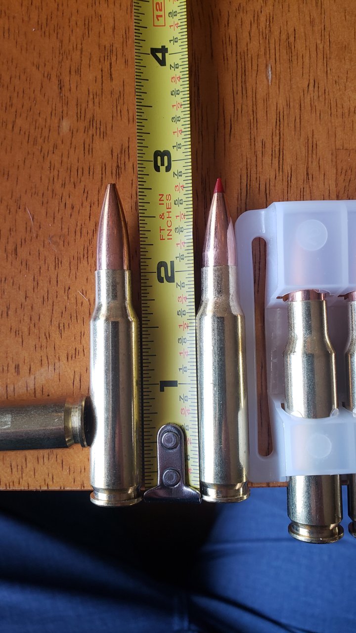

    So took out the Aero again this morning to test the new buffer spring. No issues running the under powered PMC 147 gr 7.62. Overpowered hornady superperformance 168gr also ran fine. Made adjustments to gas block for first time 5 clicks restricting from fully open seems to be the good spot unsurpressed. Good feed and consistent last round bolt hold open. Perfect 3 o'clock ejection. Was 1 o'clock ejecting with wide open gas block.
    What we can't figure out is feeding issues with federal gold medal match 175gr. Multiple fail to feed an to make it more confusing last round bolt hold open issues to. We're pretty sure this issue isn't related to the buffer system. Could be something with the size/shape of this particular cartridge

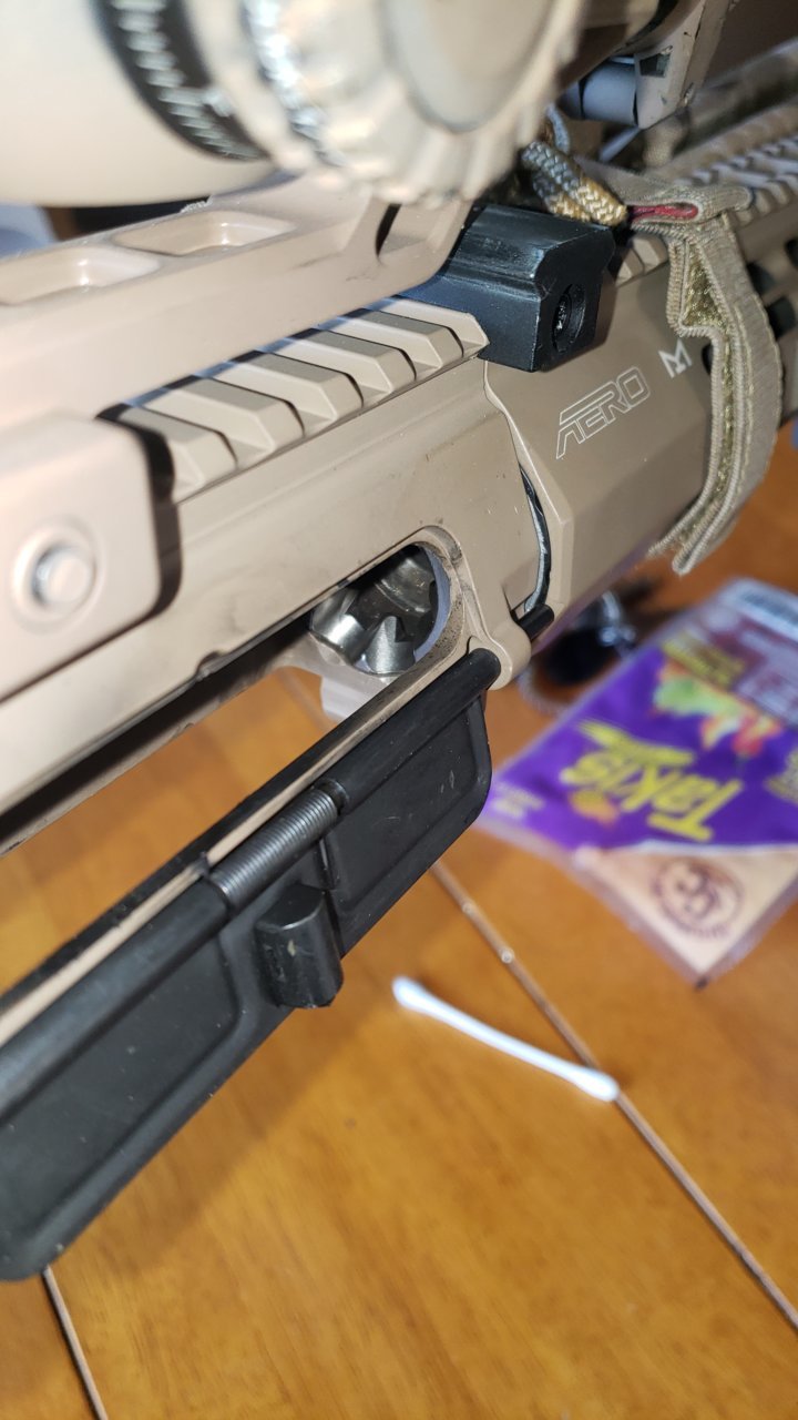

    @Casper66 any chance you can snap a pic of your feed ramps and share it? Buddy thinks may need to work on feed ramps to blend them into the chamber.
    I mean I only bought a couple boxes of 175gr so if it feeds everything else reliably now it's not the end of the world but still an issue I'd like to solve because there's no reason it shouldn't feed it reliably.

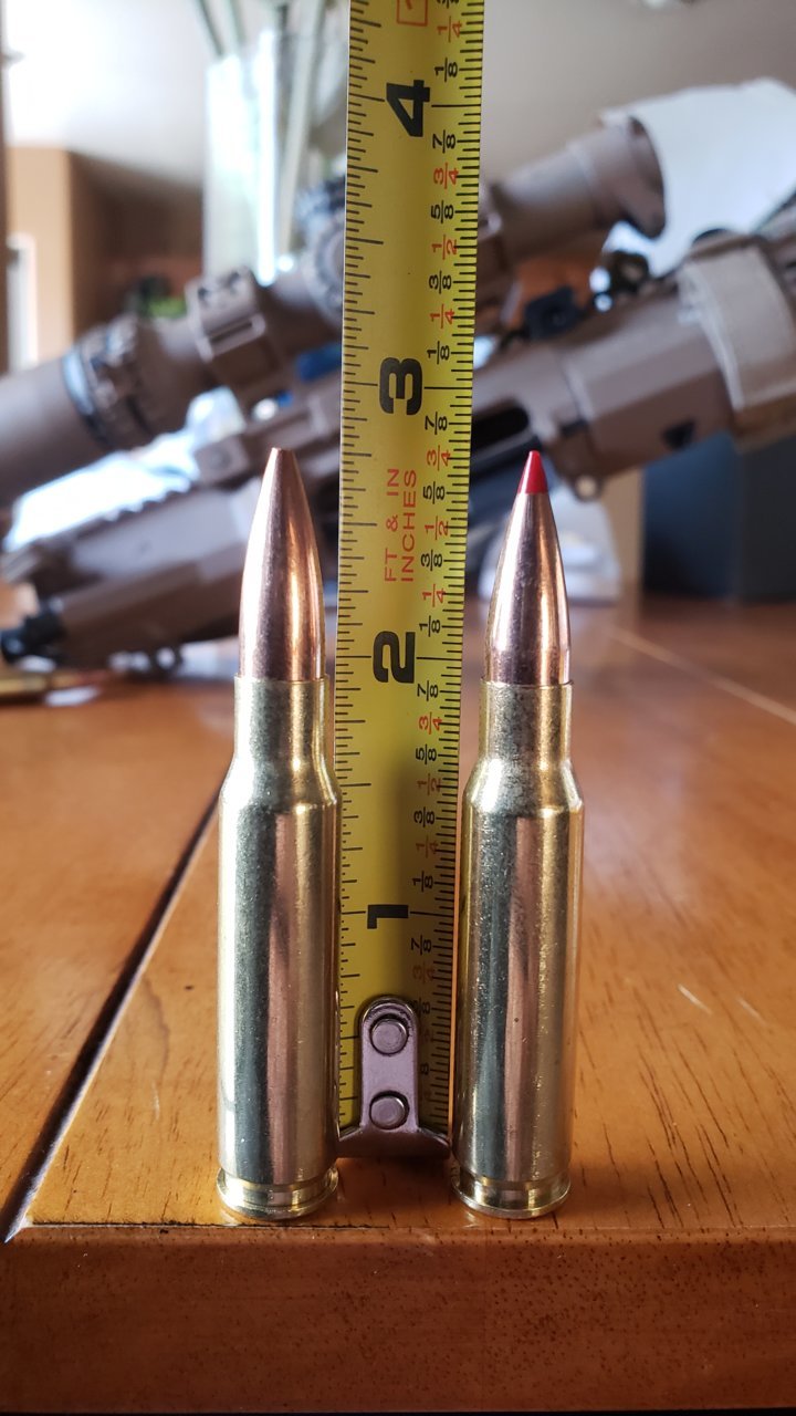

    We thought about that but doesn't appear to be an oal issue.
    Maybe a projo issue with a little different shape/ girth
    175gr FGMM left Hornady 168gr superperformance match right
    Feed ramps you can kinda see there's a little bit of a step there vs a smoothish blend into the chamber. Possible the 175 is getting hung up causing feed issue. I don't have another AR10 to compare but my BCM M4 is a very smooth transition on the feed ramps
    The federal 175gr definitely has more girth to it. The Hornady is a sleeker projo

    Thanks yours does appear to have a much cleaner blend than mine. Interesting.
