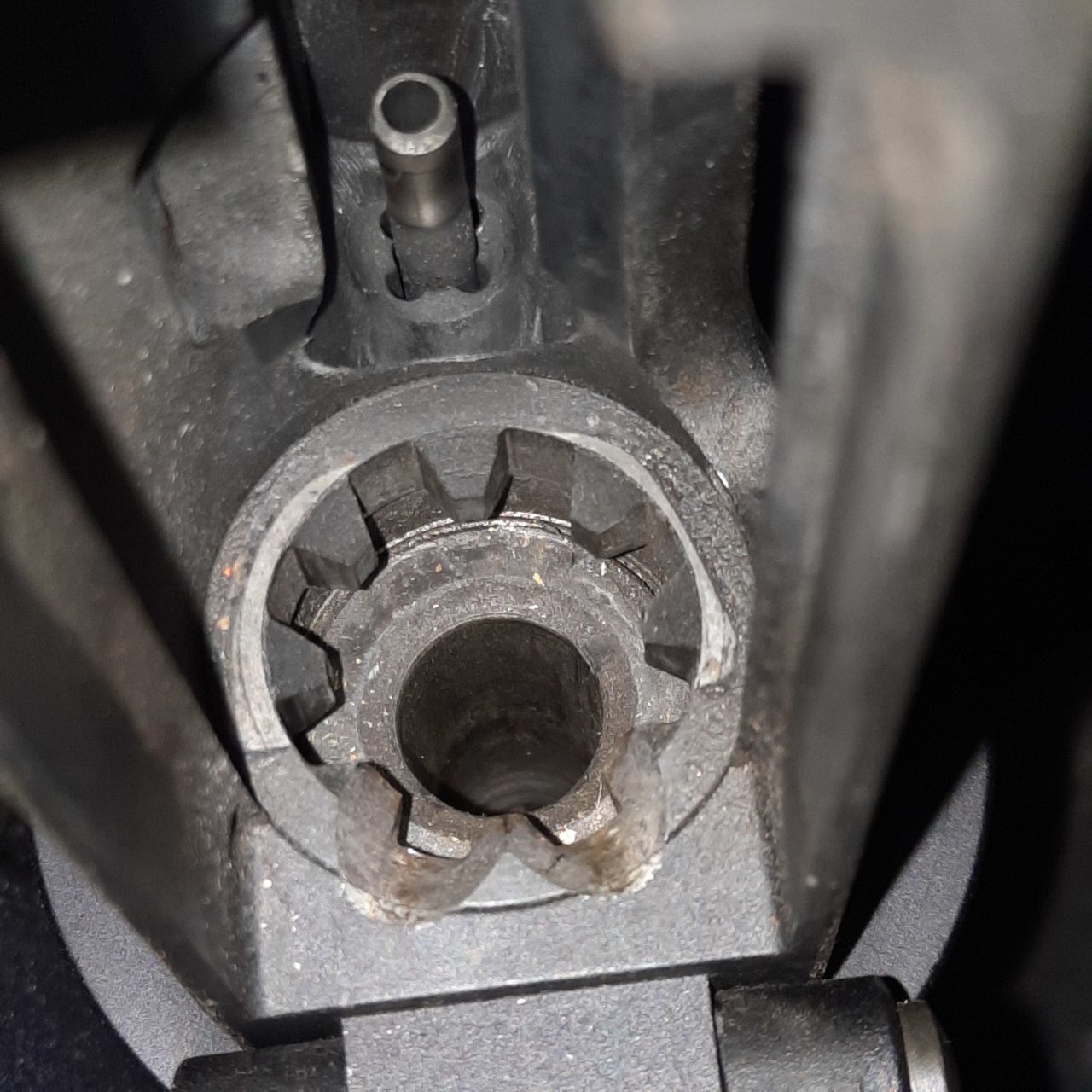

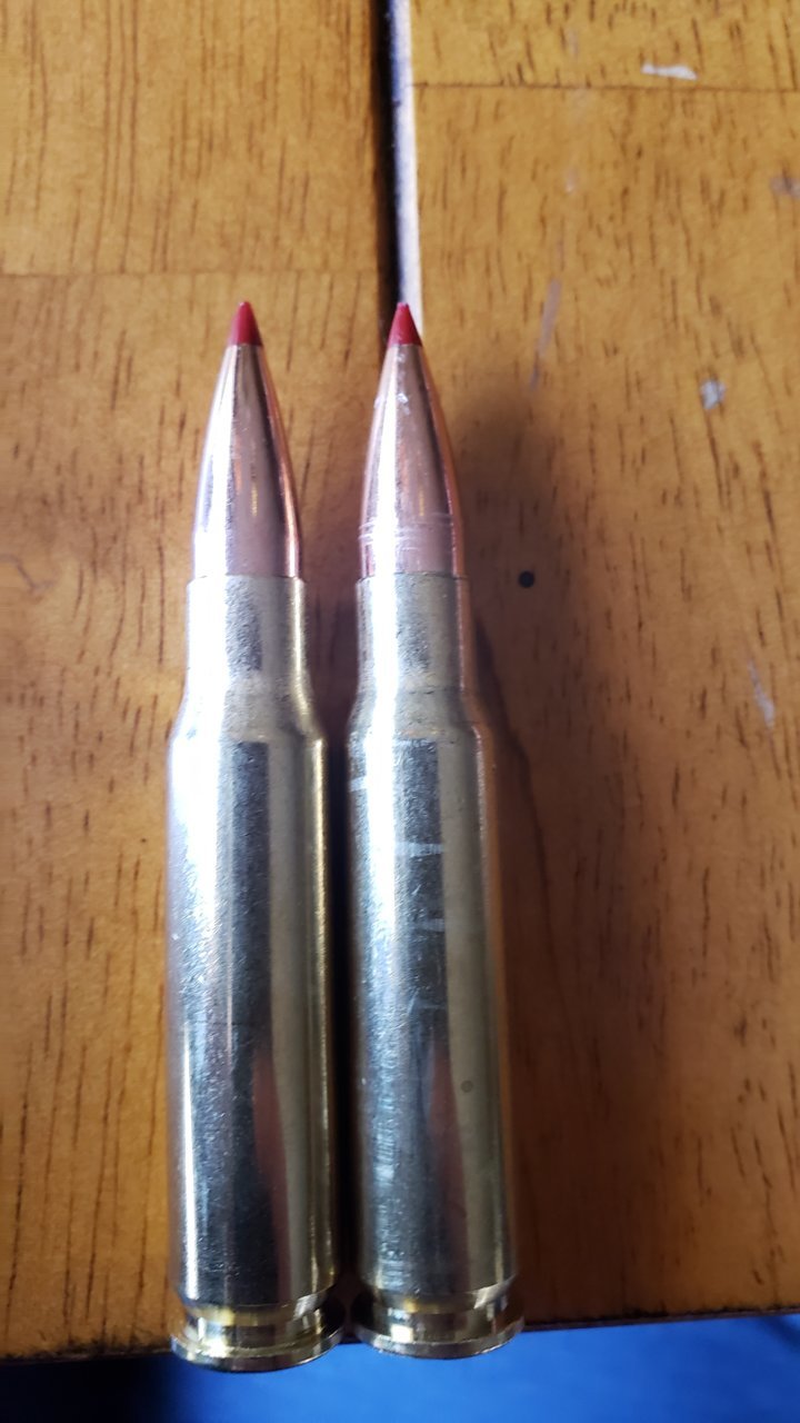

    Mostly doesn't feed load new mag, release bolt round won't feed have to re charge to chamber round. Then 2nd round doesn't want to fully chamber but again only with the 175 FGMM

    Check with a comparator to see what cartridge base to ogive is between the different rounds. If the barrel leade is steep or short, sometimes the heavier longer bullets jam. I have some 308 AR barrels that are very tight. A gauge (like sheridan) will tell you if there's a close headspace issue. A couple of mine won't chamber anything above minimum. If you reload, you can seat the 175s a few thou shorter, or run the loaded rounds through a SB die with expander removed.

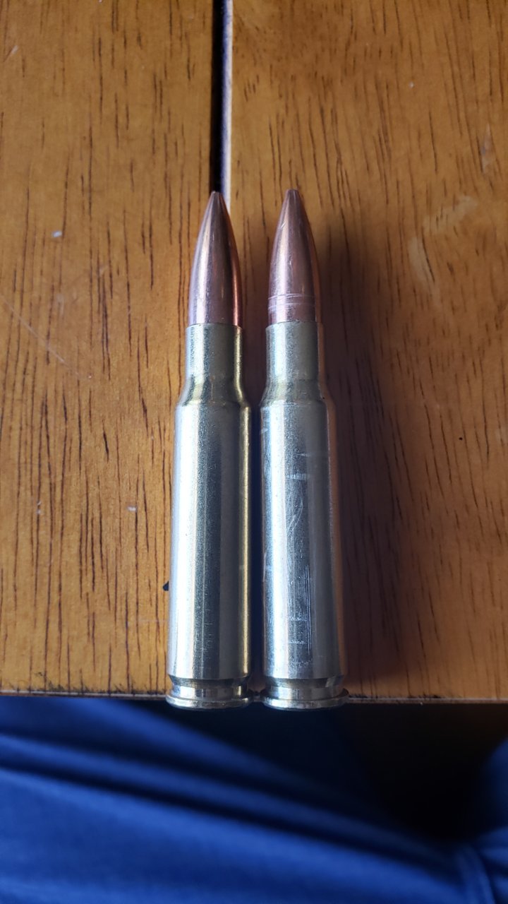

    So I think the upper is going back to aero. I certainly don't think i should have to pay a smith to fix.
    This doesn't seem normal to me.
    Fed cartridge right un fed cartridge left. Noticeable marks on both the projo and casing.

    168gr still some markings but not as heavy as the 175

    That's odd. If the leade is short, the rifiling grooves leave vertical lines, not horizontal.

    It looks like just a tight chamber with a short (within Saami) throat. The ogive is jamming. Keep shooting it and it will probably free up eventually.
    You can re-ream, and or lap the chamber as well
