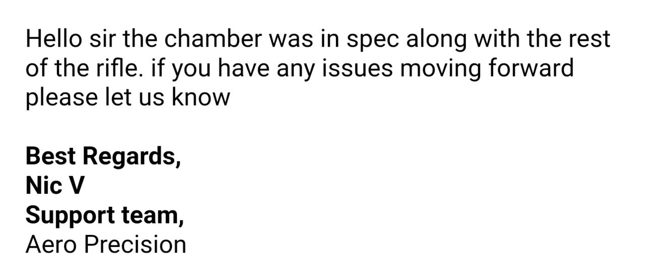

  9. May 23, 2022 at 8:12 PM
    #829
    OnePuttBlunder
    OnePuttBlunder Well-Known Member
    Aug 14, 2018
    #262794
    3,825
    AZ
    2018 TRD Offroad DCSB Premium +GFC
    Carrier moves freely and easily with bolt removed
    I did not get a spec sheet in return with the upper i asked this was the reply 50/50 on if they even checked
    Definitely not going to send any rounds through it. Looks like it's going back again. Bolt is stiff but once in and retained by the cam pin it rotates without catching or snagging. I think I've got an out of spec bolt or more likely bad headspace or bad chamber/extension.
