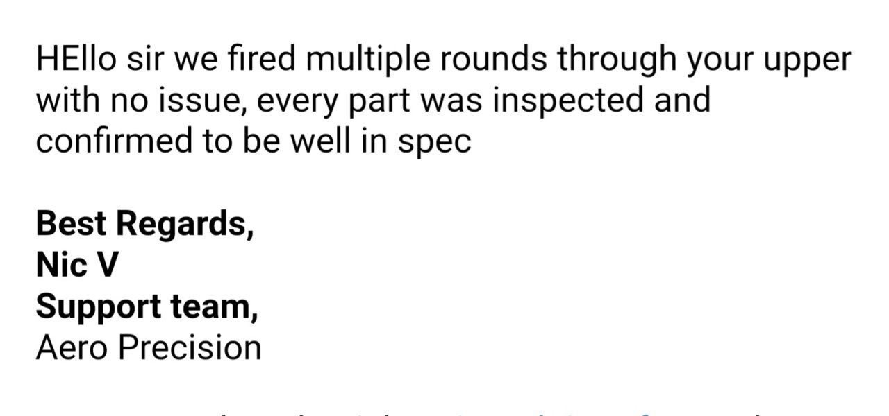

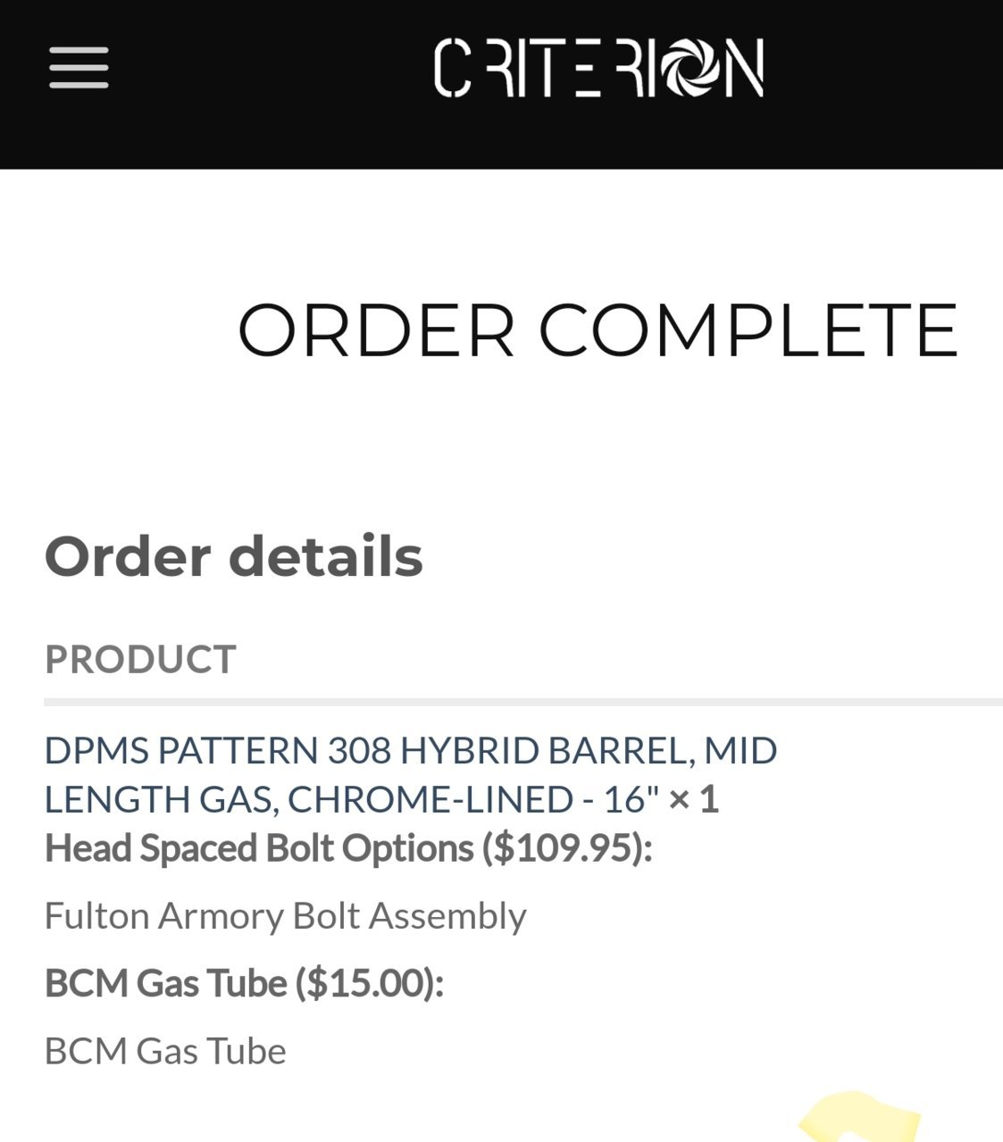

    I'm for sure ordering a new barrel PA has barrel sale this weekend can get a criterion barrel for sub $300 and new bolt. That should resolve safety concerns along with reliability issues and give me a more accurate barrel. Wasn't super thrilled with 1.5-2 moa with 168gr Gold medal match out of the Aero anyway
    I'm debating how petty I want to be. Considering spending money to have a good smith look it over and build a case too send a giant F you back to Aero

    New barrel and headspaced bolt ordered

    Barrel should ship today and be here next week.
    Decided I'm going to take both to a good smith to install new barrel and perform inspection/measure the original aero/BA chamber and headspace just because and if indeed out of spec or imperfections gives me something to fight aero on.
