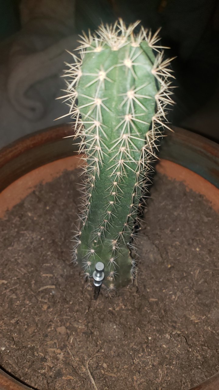

    Found a use for the jacked up Aero firing pin
    Used it to stabilize a bent cacti and get it to grow upright again20230310_203245.jpg
