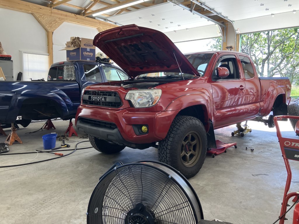

    Been extremely busy on the new rig. Finally got the big stuff swapped over tonight. Lift. Ucas, brakes. New brake lines. Sway bar relocate. New sway bar bushings. Full make over. Best part is, being able to save the detroit TruTrac LSD :burnrubber:

    Also, 33s fit with no lift.

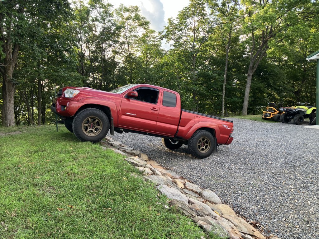

    Installed as of 7/6 @122,000 miles:
    bilstein 6112s 5/6 pass/driver setting
    Camburg high caster UCAs
    Crown performance stock length smoked stainless braided front brake lines
    Crown performance 24” extended stainless braided rear brake lines smoked
    40k mile hubs from the blue truck
    2015 oem vented front brake dust shields from the blue truck
    Napa new black front calipers
    ECGS front diff bushing and new axle seal
    Energy suspension poly sway bar bushings in red
    Torch offroad sway bar relocation kit
    Icon RTX leaf springs on setting 2/3
    Bilstein 5160 rear shocks with resis
    Extended rear diff breather
    Ubolt flip kit
    Detroit trutrac mechanical limited slip rear diff
    Kansei Roku 17x8.5 bronze wheels
    Toyo Open Country AT3s in 255/80r17
    Redline tuning hood struts
