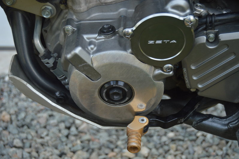

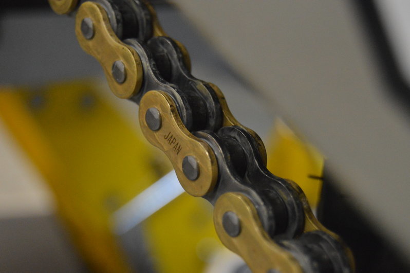

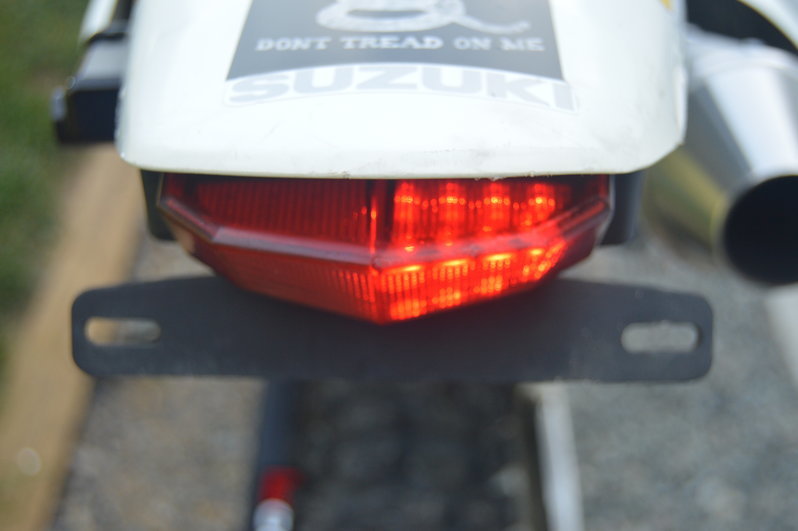

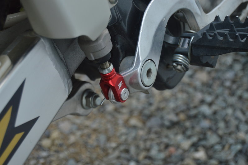

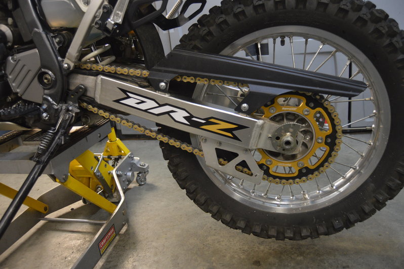

    After my Test ride, I was hooked, she had to come home with me!
    Some old highlights:
    First Mods- Zeta levers, MSR skidplate, MSR barkbusters:
    DRC mid height (stock height) 50mm wide foot pegs and Thumpertalk Casesavers:
    R&G front axle sliders....to prevent any further fork boo boos....
    Fender from user Chris'
    (@Sacrifice) 2015 DRZ400 supermoto:
    First flat tire:
    New tires installed(No More Deathwings) :
    DRC edge 2 fender eliminator from thumpertalk with 602 style led clear signals:
    Manual cam chain tensioner (MCCT):
    Gold "DR-Z" Swing arm decals from ebay:
    New Protaper CR HIGH bend 7/8s bars in platinum:
    Yellow Showa fork decals from ebay:
    3x3 air box mod:
    K&N air filter and Jet kit:
    ANOTHER new set of tires and Gold Hammerhead Designs +10mm shift lever:
    New MCCT VS. Old MCCT:
    Kill All Tires:
    Zeta Red Brake Clevis:
    DRC edge 2 with 12oclock labs board:
    Gopro remote:
    Zeta Titanium starter cover and Yoshi works edition inspection plugs:
    New Supersprox sprocket set with DID VX2 520 gold/black Chain:
