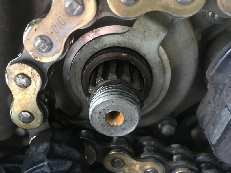

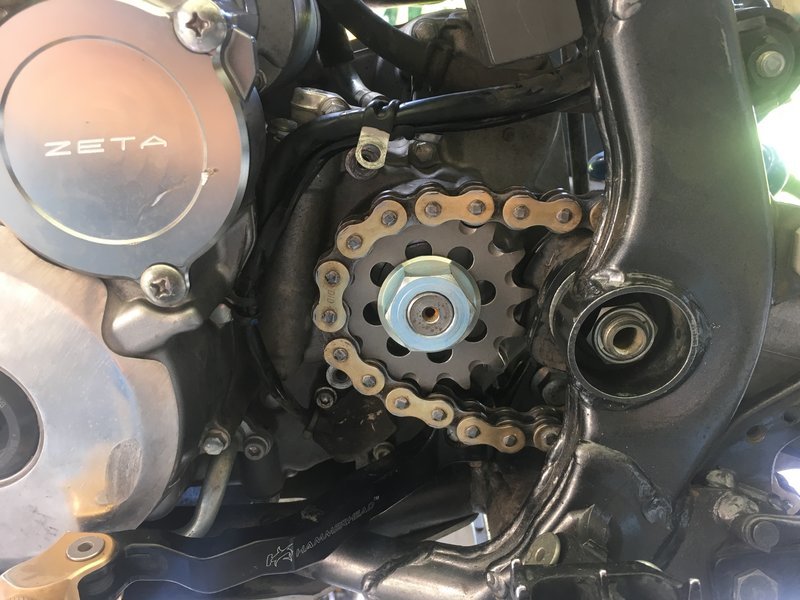

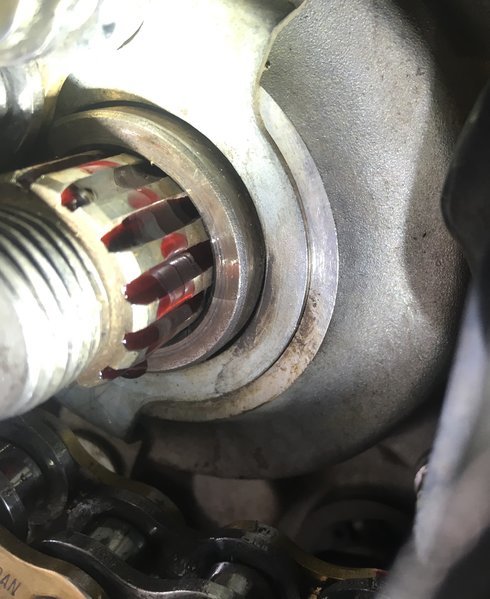

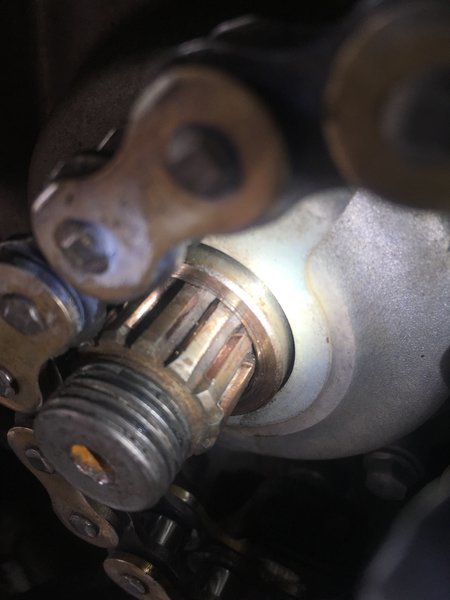

    Fixed the countershaft issue.
    New front sprocket, new washer, new countershaft nut. Lots of red loctite.

    I had to use a puller. Cleaned all the old off with carb cleaner and a brass brush

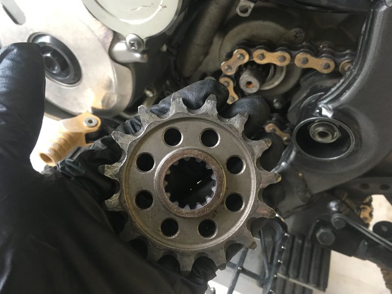

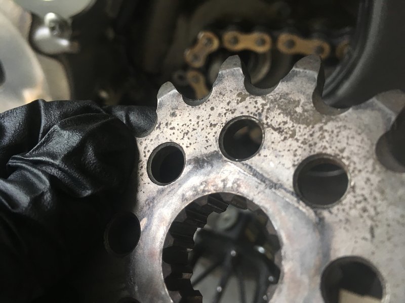

    This is the supersprox i was running.
    You can see the play it had and all the wear on the splines.

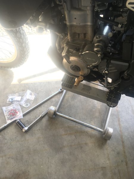

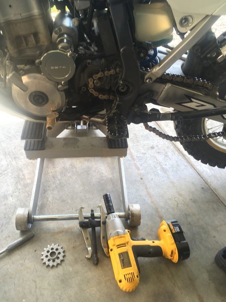

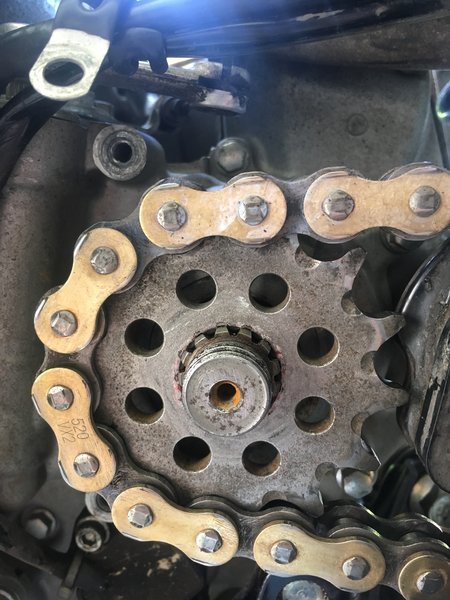

    For the time being, I swapped my old 14t on there to get me by until i could order a new front sprocket after the holiday weekend.
    Had to use a puller to get the 14t off to put the new 15t on
    15t vs. 14t
    New 15t and hardware installed

    Dam that had a boat load of play in it
