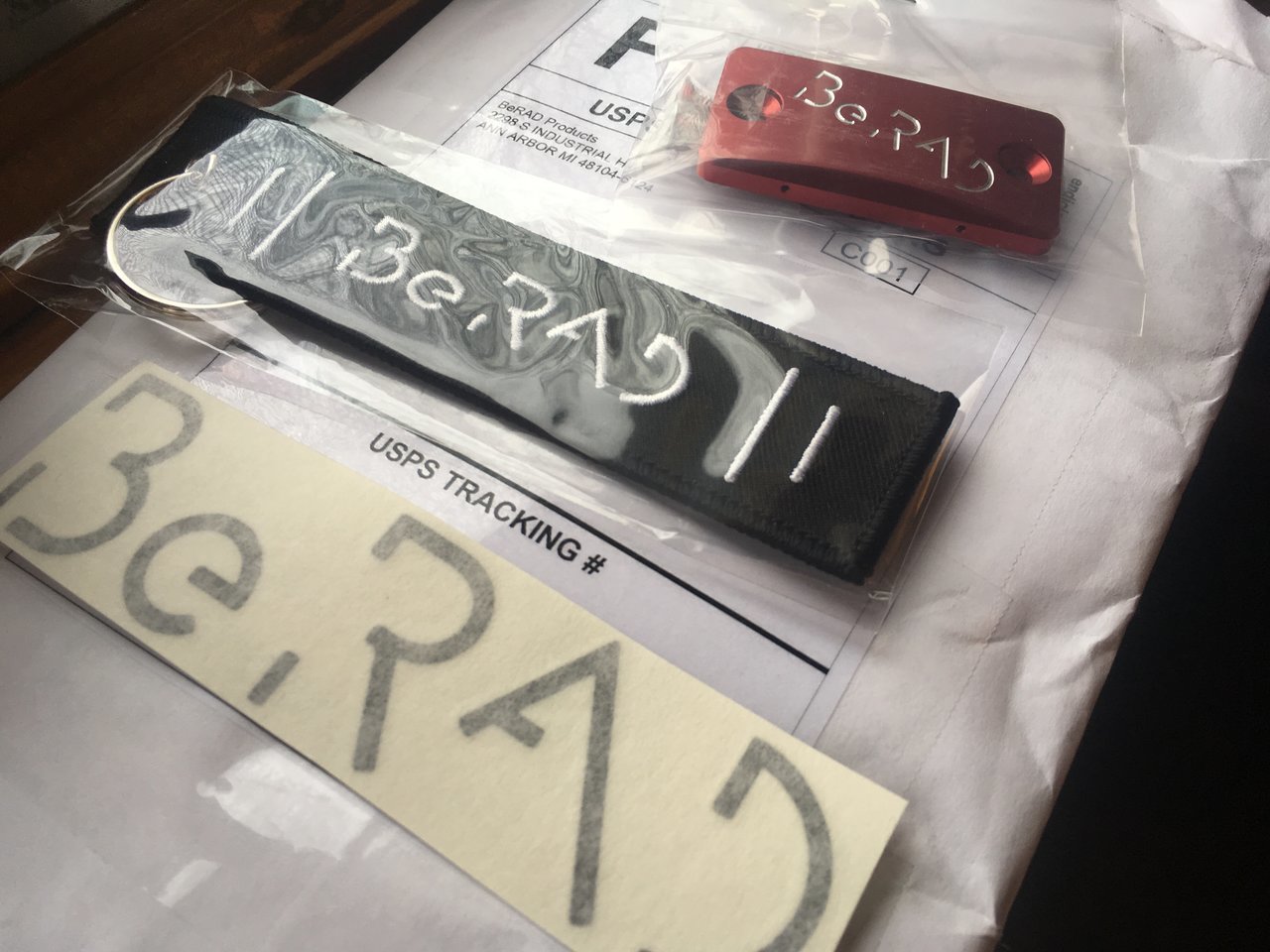

    Got my rear brake reservoir cover.
    Waiting on the rubber seal, and other misc washers/hardware. Then, i’ll put the brake pedal on

    BeRad Products Red Resi Cover and Zeta Trigger Brake Pedal
