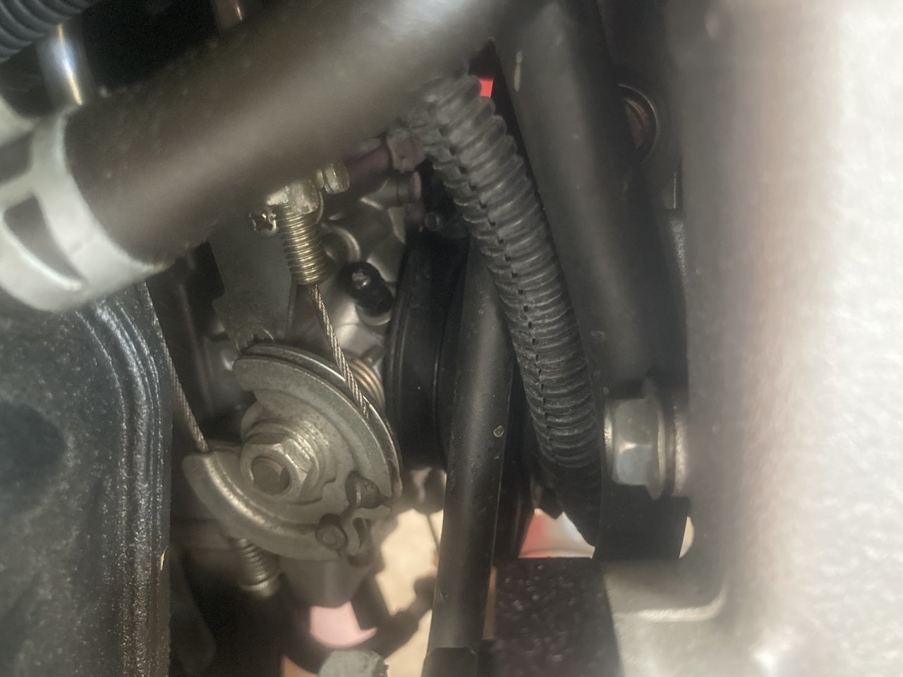

    Whaaaaat is this? It's cable actuated now? Like a choke?

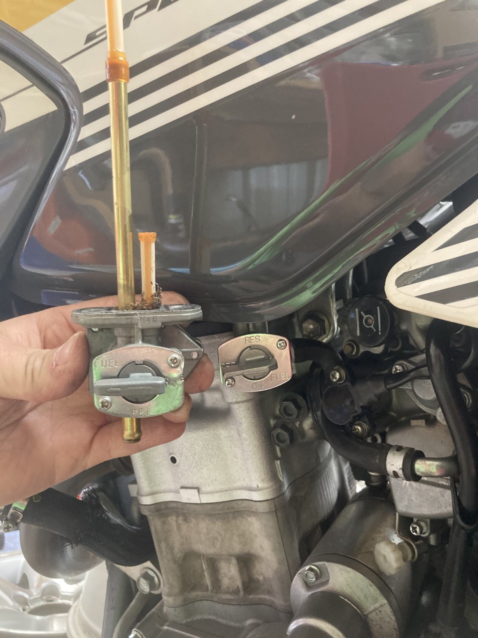

    I knew it was carb'd but you said you were replacing the petcock. With a manual operating one. Then showed a picture of a cable wrapped around that thingy. I thought you were showing how you removed the gate valve petcock and replaced it with a cable actuated valve. I was really confused. I'm still confused. More confused now than ever!!!!
    AR15xAR10[QUOTED][OP] likes this.

    same. how was the old petcock not manual?

    In the second photo, i was showing how i plugged the vacuum port on the carb with a small black silicone cap.
    RobP62[QUOTED] likes this.

    Vacuum operated. Engine starts and pulls vacuum into the carb, a small short line pulls it from the petcock thus opening the diaphragm inside the petcock and allowing it to actually “turn on.” Super simple but annoying because when it fails, and they all eventually do, it can flood fuel into the motor, contaminate the oil, wash the cylinder walls and even hydrolock the motor when you try to start it. Since this bike has basically been sitting for almost three whole riding seasons, this was the one thing I was worried about, so i fixed that.
